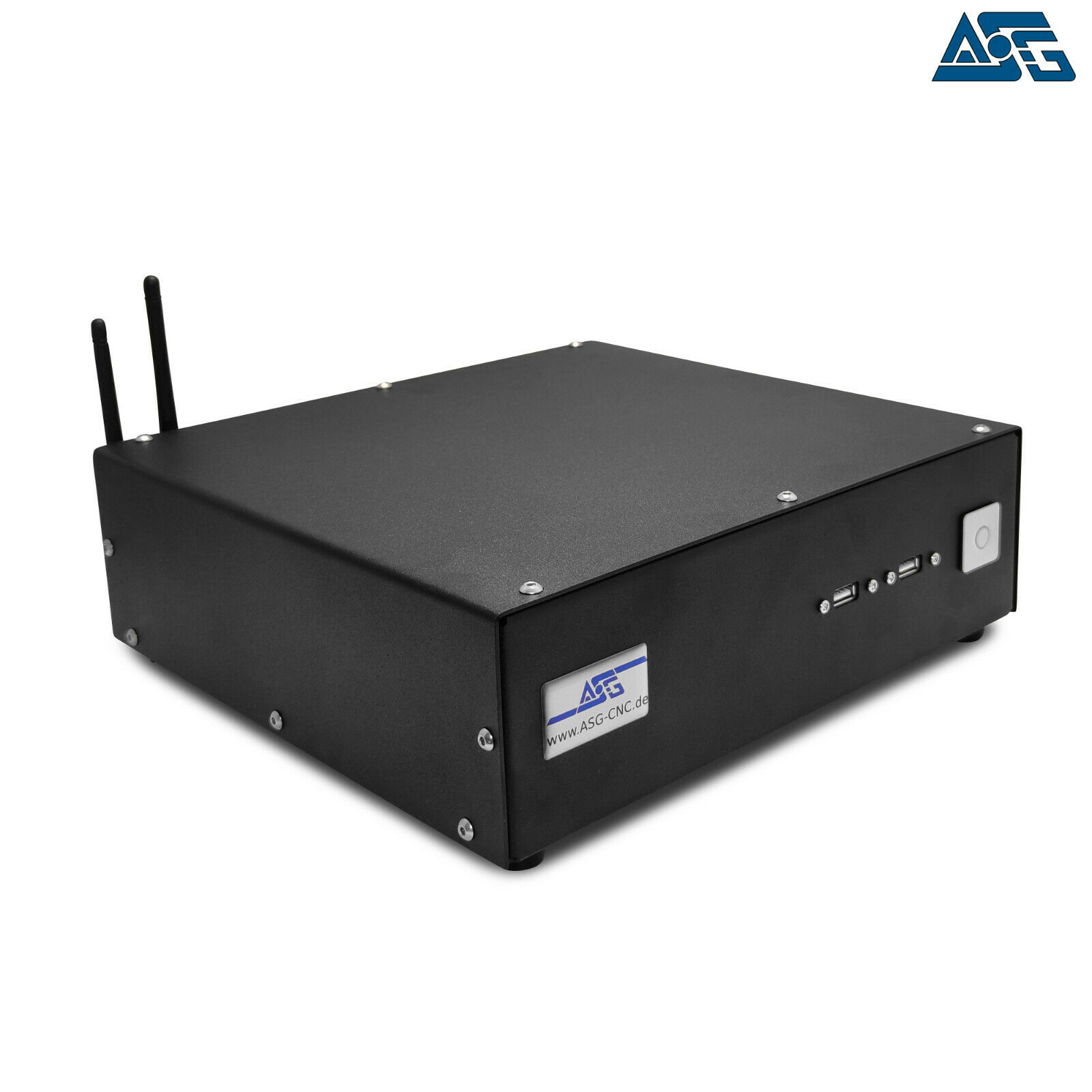

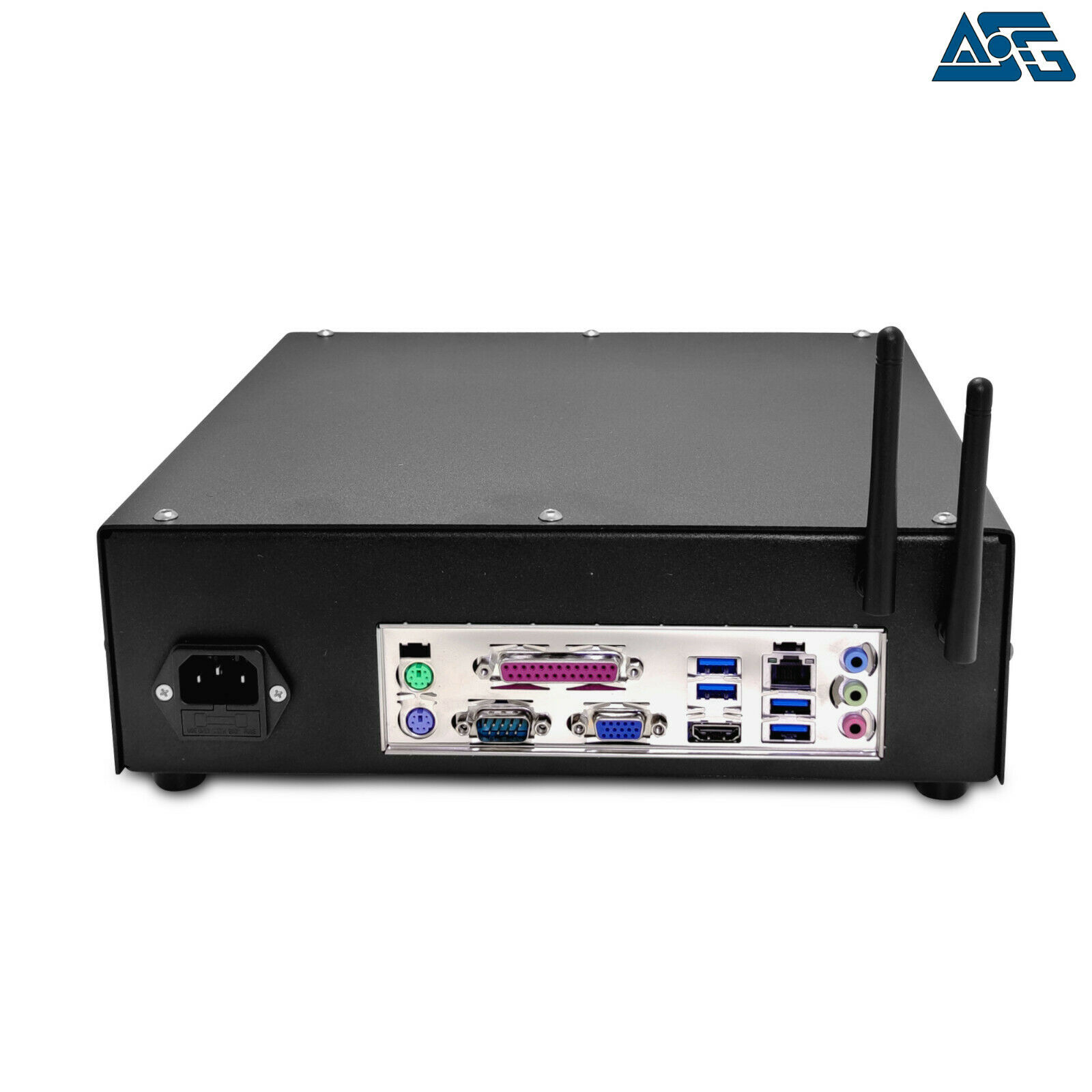

Good evening Andypugh,
I tried tonight new RAM modules without success ...
So I thought it is time to buy a new CNC PC no old hardware anymore which is second hand and ofter not working proberly...
Can I easily import my configuration with the Wizard my Step Konfiguration ?
Product type: Mini PC
Hard drive type: SSD Special features: native parallel port (LPT), front USB, fanless
Operating system: Windows 7 Brand: ASG
Series: IPC Hard disk capacity: 120 GB
Release year: 2020 Model: IPC01
SSD hard drive capacity: 120GB width: 282
RAM size: 4GB Length: 268
Processor speed: 2.4GHz Maximum memory size: 8GB
Country and region of manufacture: Germany Processor: Intel Pentium
Operating system version: Professional Manufacturer warranty: 1 year
EAN: 124354 Graphics processor: Integrated graphics
Connectivity: LPT, LAN RJ-45, RS232, PS / 2, Audio, HDMI, USB 2.0, USB 3.0, VGA Form factor: Mini Desktop
Color: Black
Ebay Germany Link:
www.ebay.de/itm/Mini-PC-CNC-PC-Steuer-PC...1dfffc0e54%7Ciid%3A1

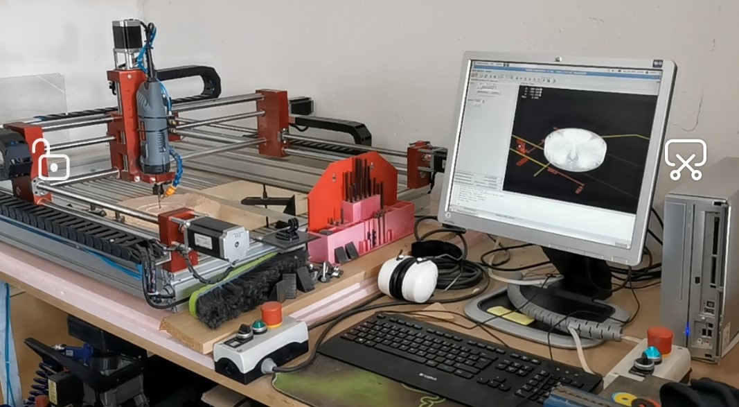

Hello Andypugh,
I have received my new PC.
Everything roks fine with Linux CNC and Debian 10.
Non I try to mill a round wooden part and an other problem occurs. ...
The limit switches react due to little vibration and so want to ask
Are there any options in LINUX CNC to changes the reaction time or to deactivate
the switches for dedicated situations where vibrations occur for example ?`
Additional I get many new information which are shown now in the left corner.
Normaly I need only X,Y,Z position and thats it. Is is possible the configure the
parameters which are shown in the left corner (positions tools etc.)
Thanks a lot for your help and please enjoy your weekend
