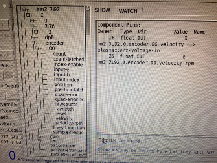

Looking for second encoder.
If I put num_encoders=2 in the loadrt line then I get error.
This a firmware issue?

Loadrt line:This spits an error about the config.num_encoders=2 but only 1 available.
I think I have the correct firmware loaded. It shows the DPLL module which I think is what is needed for plasmac.
mesaflash readhmid
loadrt hm2_eth board_ip="10.10.10.10" config=" num_encoders=2 num_pwmgens=0 num_stepgens=4 sserial_port_0=200xxx"I think I have the correct firmware loaded. It shows the DPLL module which I think is what is needed for plasmac.

26 Mar 2021 10:30 #203684
by bevins
I have those, I am talking about the encoders for plasmac. those encoders are for pins 16,17 18,19 I think.
Replied by bevins on topic (Solved) 7i76 can only get one encoder
7i76 has only one normal encoder and 2 MPG encoders.
For MPG encoders to be usable the initialisation line in hal has to be set to mode 1 or 2 (not sure) but i do set it to mode 2 always as it also gets the 4 analogue inputs besides 2 MPG.
forum.linuxcnc.org/24-hal-components/385...e-7i76-mode-question
They should be visible as enc0 and enc1.

26 Mar 2021 10:35 #203685
by bevins

Ok, you need the 2 encoder inputs for the THCAD so that requires the "PL" in the firmware name, not DPLL (dpll is timings function on a phase locked loop), pretty sure PCW made one.

26 Mar 2021 10:48 #203687
by bevins
There is only dpl in the 7i92.zip firmware..... Thats not the correct one?

26 Mar 2021 10:51 #203688
Replied by tommylight on topic (Solved) 7i76 can only get one encoder
From your screenshot pretty sure it is not as the inputs should be shown as input A only, 3 of them.

26 Mar 2021 11:06 #203690
by bevins
I found firmware file that works now the encoder01 shows up.
Now on to ohmic hal file errors.
