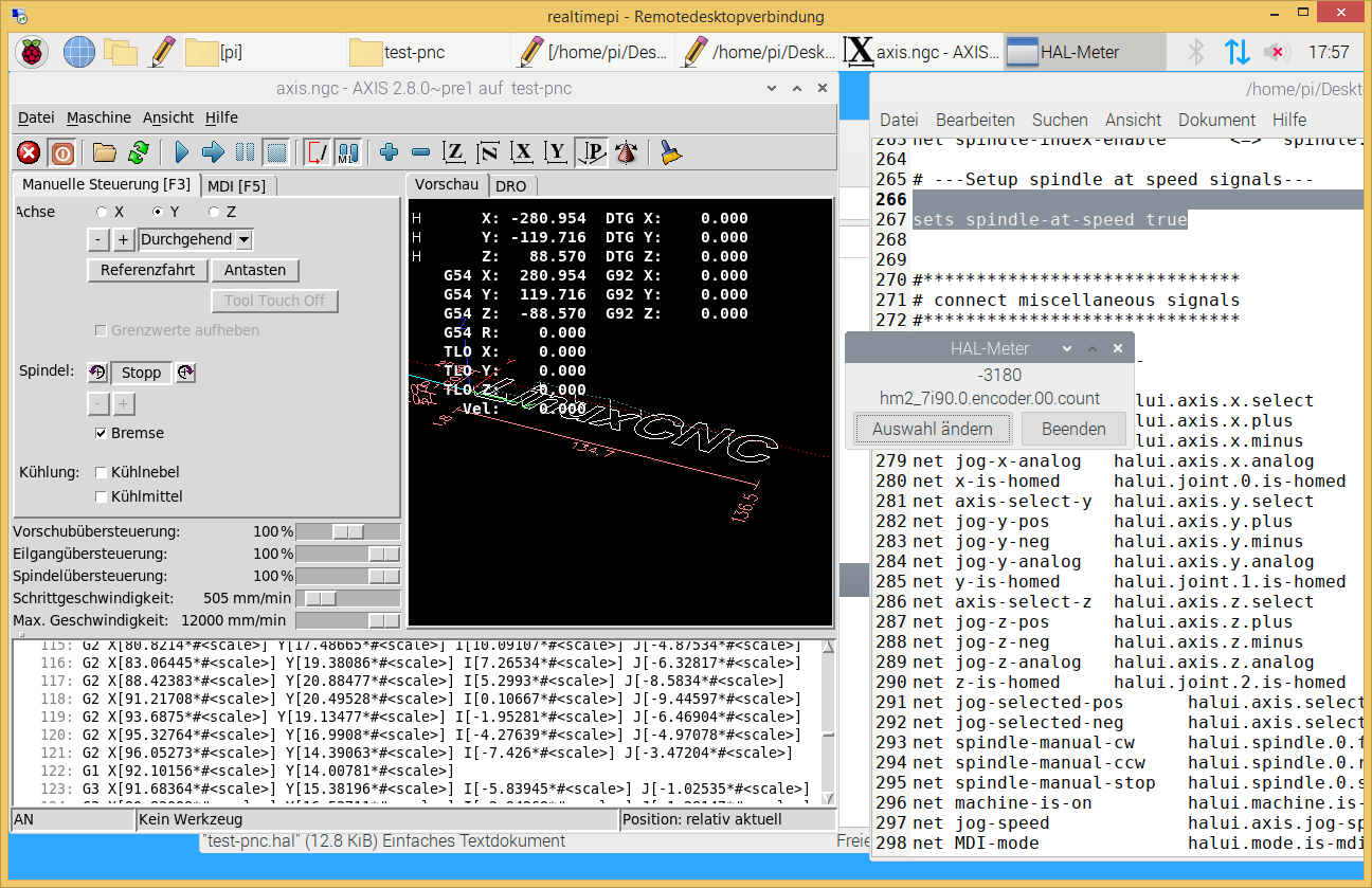

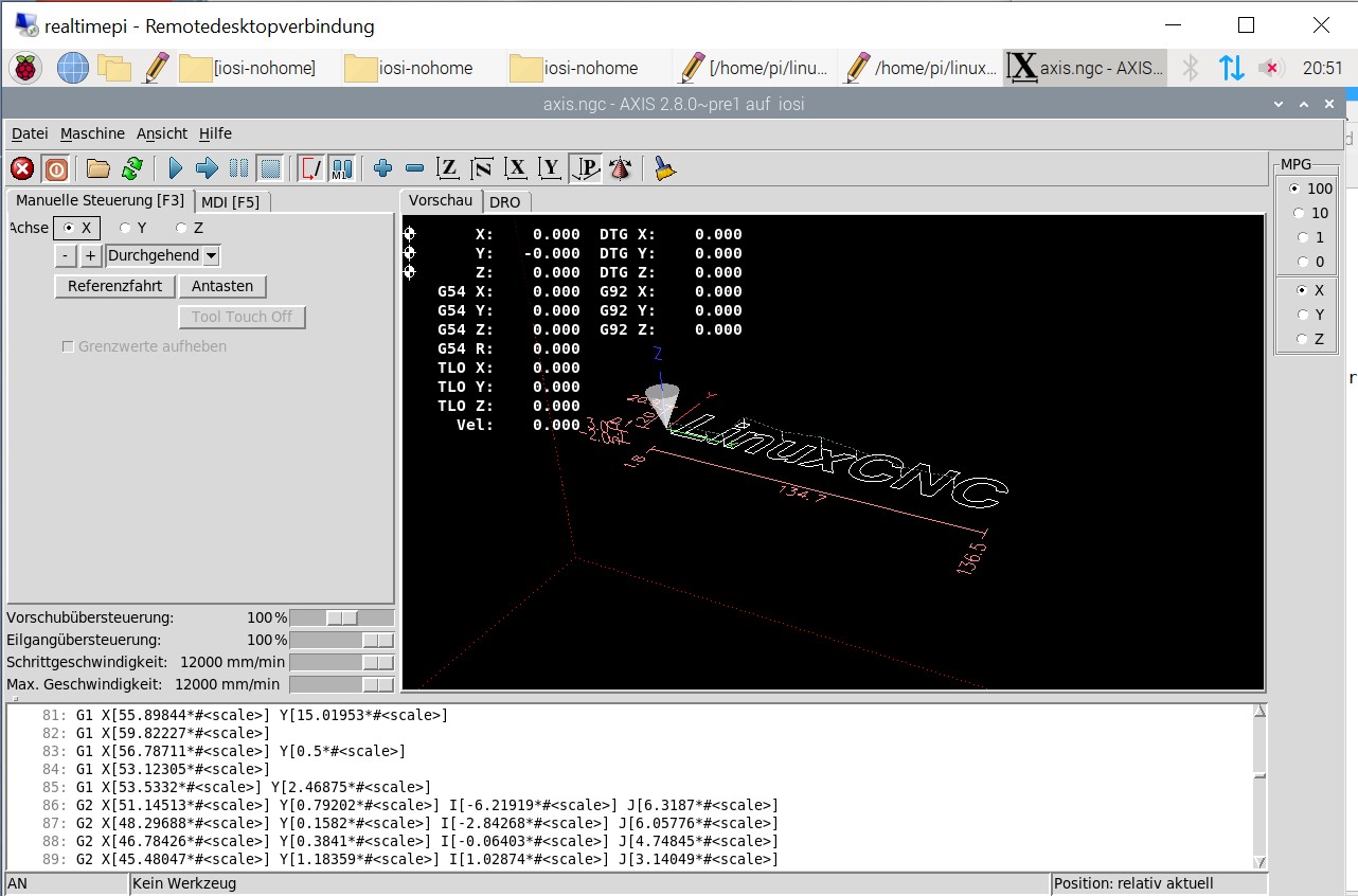

Hello dear helpers
with the help of other threads i finally got my MPG wheel counts.
my plan is to use a handwheel for joging all three axis with only one wheel and without any physical buttons.
how can i implement this?
in the GUI there is already the option to select individual axis.
so i would need to add increment GUI buttons
thx a lot for helping

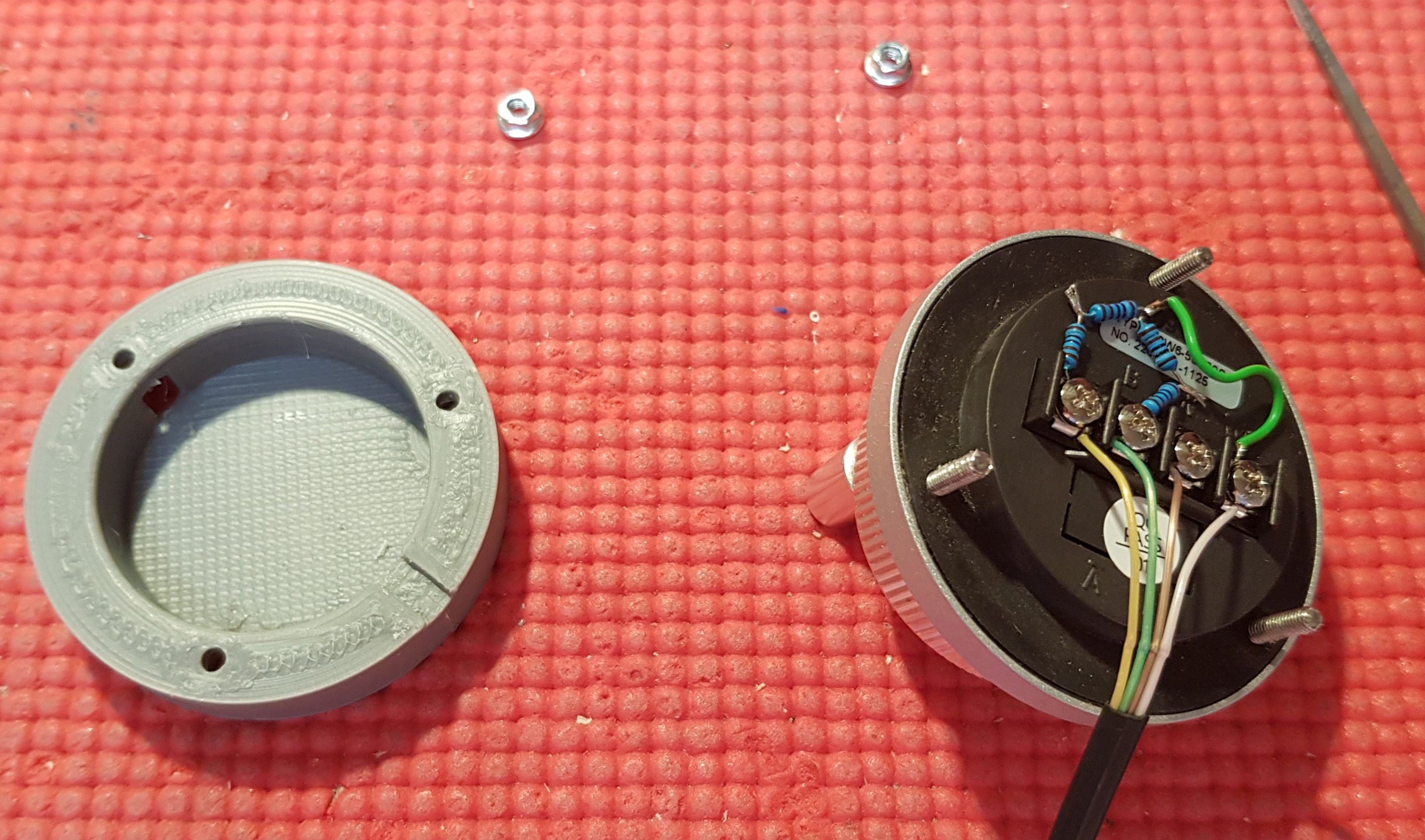

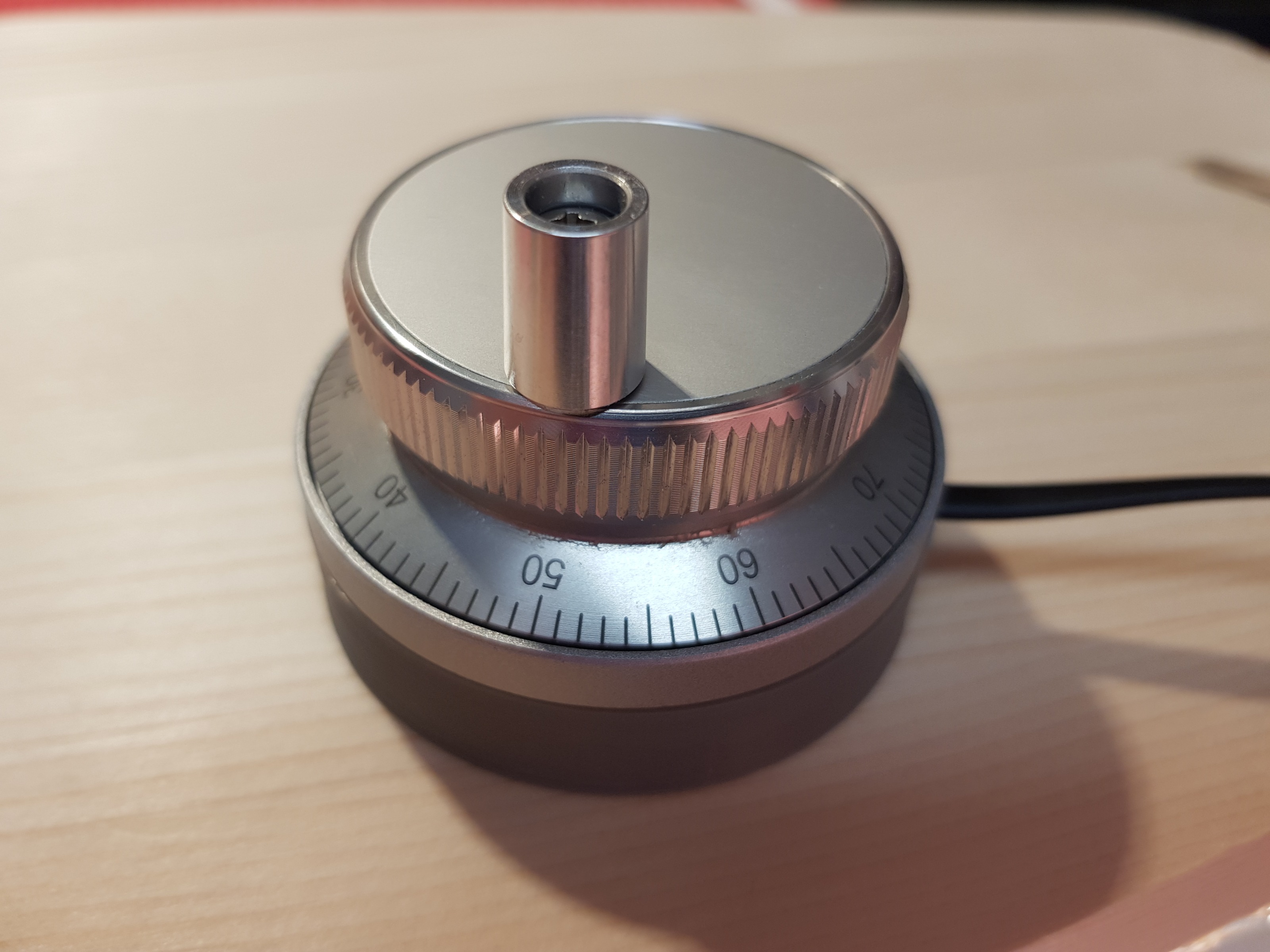

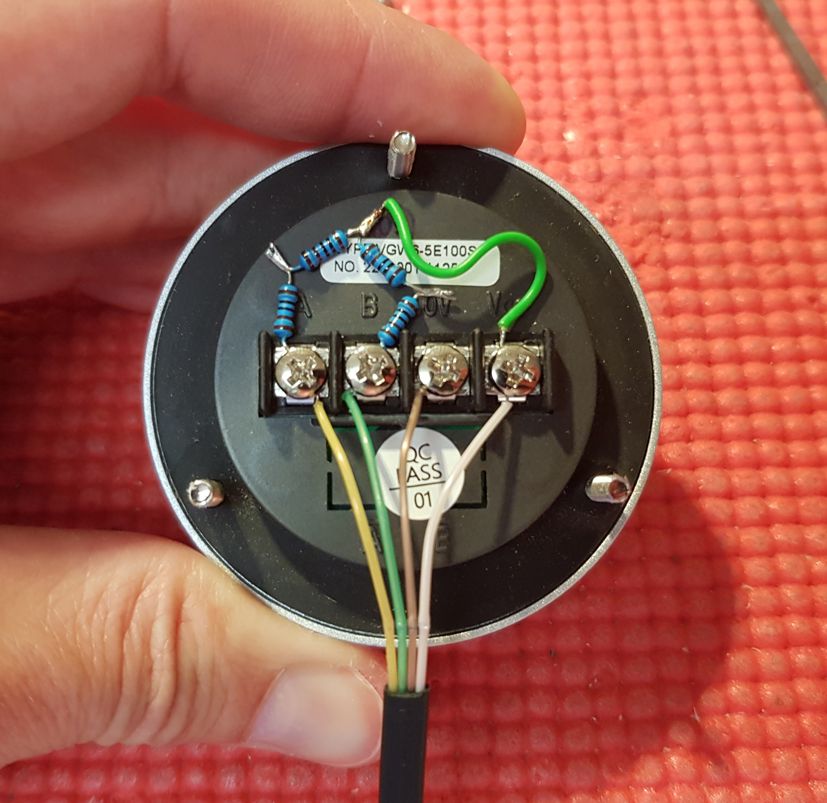

30 Mar 2021 15:58 - 01 Apr 2021 07:06 #204135
by creisey
Replied by creisey on topic Simple MPG Wheel no physical buttons MESA 7i90HD
i have added a 3d printed case. now its finished
2 x 1k pullup resistor each side (equals 2k)
STEP & STL for printing (30% infill, 1mm wall, ABS 235/110)
Last edit: 01 Apr 2021 07:06 by creisey.
