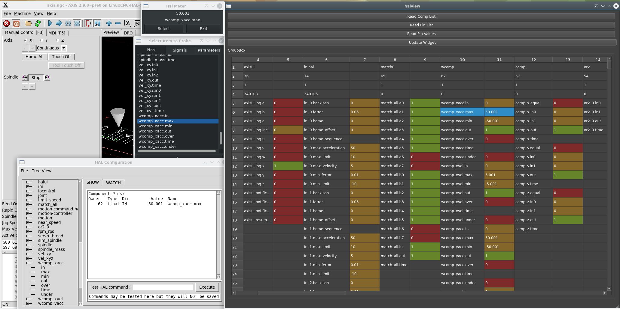

Accidentely i am building a halviewer. It interacts with hal on c and c++ level.
I had a few things to solve in c++ to get it running with the axis template gui.
This is a first preview of the program.
Red=bit off value
Green=bit on value
Orange=float value
Grey=To code, not finihed.
I was wondering. We could also set halpins, paramters, etc.
What would be a big improvement to the existing halshow?

Hi Tom,
Can you think about what would be a mayor improvement for existing the halshow program?
For example it could be :
- a logger
- a curve printer
- etc.
Maybe you have a idea?
- a logger
- a curve printer
- etc.

Hi Tom,
Take your time. Succes with your new shop !
I integrated a treeview beside the tableview.
Most of the code is completed now. Have to do the "functions'.
You see in the middle there is space left.
Possible addon's :
- Maybe add a halscope there?
- Or a s-curve motion profile tester?
- Or a hal config builder?
Possible addon's :

Replied by tommylight on topic halviewer, go or no go?
Scope !
- Posts: 19896
- Thank you received: 4648
01 May 2021 22:28 #207587
Graphical representation of the whole hal tree
(That might be difficult, though it has been done in Rockhopper, for example)
wiki.linuxcnc.org/cgi-bin/wiki.pl?Rockhopper_Web_Server
Replied by andypugh on topic halviewer, go or no go?
Possible addon's :

Hi Tom,
Yes a scope is nice !
Hi Andy,
A halgraph or visual hal representation could be nice !
I don't have a clue how to add the arrow lines between items.
In general, i can try a new approach in 3d. This is more interesting for me to set up then a 2d graph.
For example to visulalize the standard axis gui, it has 18 components, 774 pins, 69 parameters, etc running
This is a huge ammount of data. It's almost a neural network.
Then we could integrate a 3d halscope with the same viewer. This can be quite interesting to see what happens.
Ok i will make a test today.
Hi Andy,

One great improvement would be the last search or last view function. and if the pins including pvcp are already pre-sorted in an axis view. then with little search you would have an overview of every axis or spindle.
