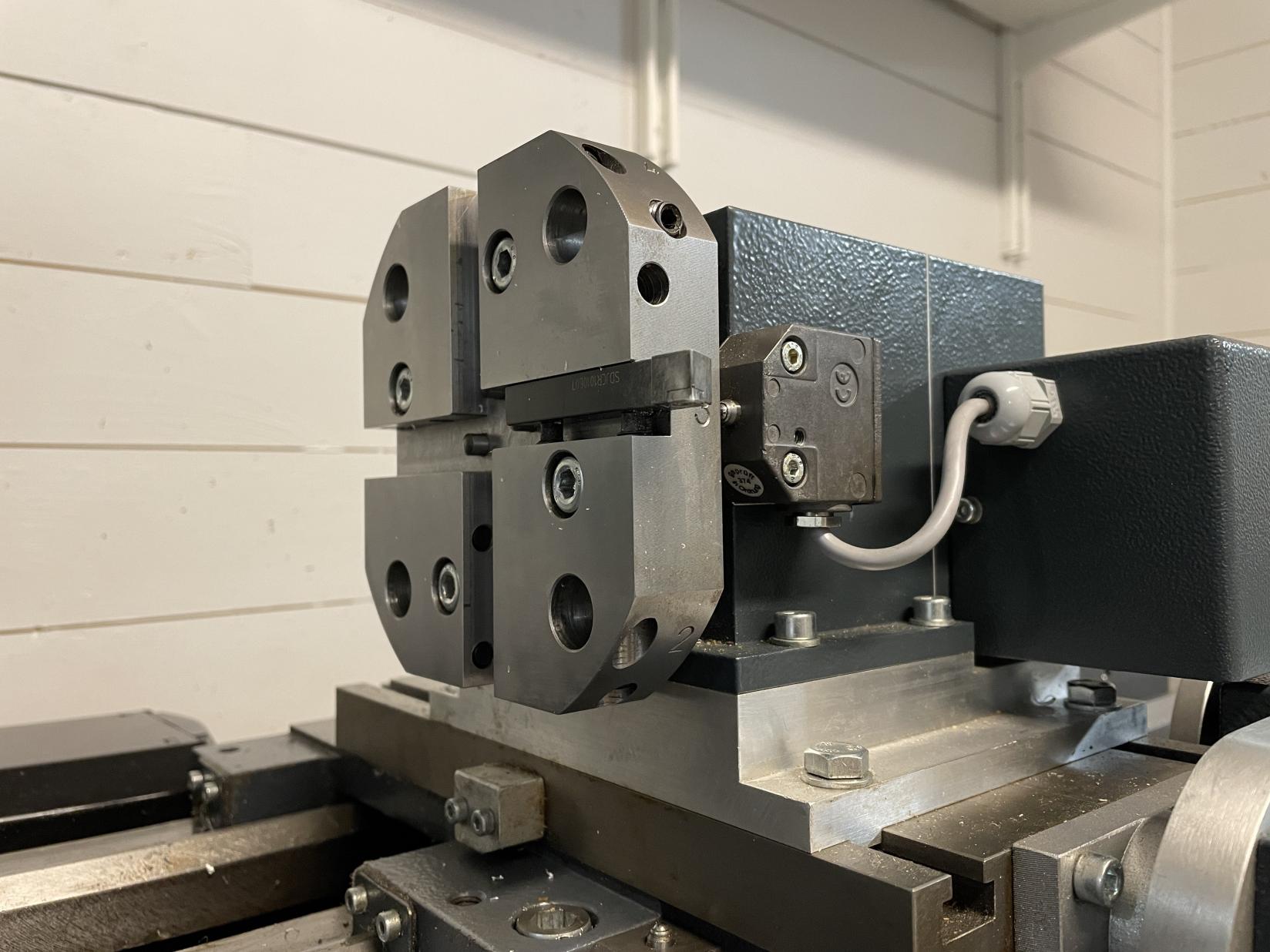

Initially I started with basic configuration for D6000 and got all the axis moving. Then using PNCconf calculated all the parameters for A axis (toolchanger) also connected and configured homing switch on the toolchanger.
From that point it got quite a bit harder, but I found this great thread about Boxford ATC:
forum.linuxcnc.org/38-general-linuxcnc-q...ved?start=100#188519
Using it as a baseline I integrated it into my configuration. Here is the current code:
github.com/bergstar/Wabeco-D6000
So far there is no error's and I get:
Message when I start LinuxCNC. However, from that point on no matter how many times I set M6 T1, M6 T2, etc. there is no movement. Also from what I can tell toolchanger-stepgen-fb value is never changed and is constant.
Any help / advice on what to do next would be greatly appreciated.

This sounds like a HAL wiring issue. Does the .comp have a connection to iocontrol.0.tool-number?

I looked into it and looks like I used wrong pin name:
changed it to
It now finally turns (and in correct direction). However - it never stop turning :ohmy: It just turns and turns
Not sure if component was maybe configured to linear axis?
Edit: When testing with G01 A360.0 command it makes exactly 1 full turn

net toolchanger-stepgen-fb <= hm2_7i76e.0.stepgen.02.position-fb => toolchanger.stepgen-pos-fb
It looks like the HAL pin exported by the component is
toolchanger.stepgen_pos_fb (underscores, not hyphens)
Try changing your HAL to be consistent with the .comp (or changing the comp to be consistent with the pin naming conventions)

It turns out I was using wrong control-type, changed to 0 and now it works.
For reference working code is on master in git. I will continue working on the .comp
