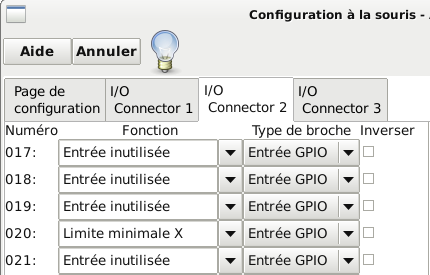

Hello,
I am trying to configure a limit switch on the X axis (7i76e card). I configure a limit with pncconf like this:
But when I start linuxcnc I have this error (with or without 24V on TB5 / PIN5)
Here what have been modified in my hal file by pncconf:
Add this line
Modified this lineWith
What did I do wrong ? (My hal file in attachment) ?
Add this line
net min-x <= hm2_7i76e.0.gpio.020.inModified this line
net x-neg-limit => joint.0.neg-lim-sw-innet min-x => joint.0.neg-lim-sw-inWhat did I do wrong ? (My hal file in attachment) ?

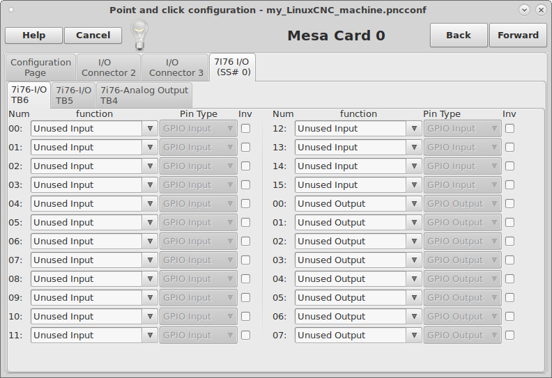

GPIO is not used for limit switches on a 7I76/7I76e, The 7I76 field
I/O is used. This normally shows up on the "7I76 I/O" tab, but
you seem to be missing the "7I76 I/O " tab which I suspect is a
pncconf/Locale issue.
You might be able to work around this issue by temporarily
changing the locale to en_US when running pncconf.

Thanks both, i have changing my locale and now i have two more tabs in the top menu and my inputs are working.
