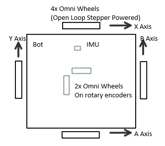

I'm making a mobile plasma cutting robot which will traverse on the surface of the workpiece which is placed on the ground on spacers (unlike over the surface in a traditional gantry system with the workpiece placed on a water bed).
This system is designed so because my workpiece is 15m x 3m in size.
The locomotion layout is as follows:

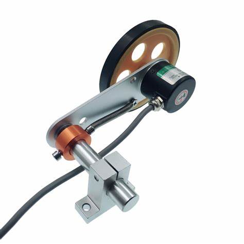

Here, I'm using 4 steppers for XY Locomotion and 2 perpendicular rotary encoders and an IMU for feedback. The 2 encoders are mounted separately on pivoted/spring loaded omni wheels so as to negate any slippage in the powered wheels and provide accurate feedback.

The mechanical issue of dragging encoders over a surface is a bit tricky as normal rubber wheels will drag always in one direction and jump and skip and pull on the encoder shaft. Maybe something like chair wheels could work but not sure how the encoder interpolation can be solved as each wheel would have 2 encoders.....

So IMU is an inertial measurement unit and will give us the heading angles (roll, pitch, yaw), velocity and acceleration.
Any idea on how to integrate this in our control loop? Is it possible to have a separate loop wherein the heading angle gives a separate signal to all the 4 steppers to move in a direction such that the bot makes a slight pure clockwise or counterclockwise corrective motion. (This is to ensure square movements of the bot.

These allow for active (powered) motion in the direction of rotation and free movement in the perpendicular direction by means of the lateral rollers.
As for the two external rotary encoders,
(Imagine a omni wheel here too) The pivoted spring loaded mounting enables the wheel to be always in contact with the surface.
Also, there are only two rotary encoders for the whole bot not two individually for each of the four motors. Two are supposed to be enough to provide the X and Y coordinate right?
As for the wheels,

I don't understand why you would use the IMU and the encoders. How is roll and pitch going to be useful in an essentially 2D application.
Are you familiar with plasma cutting? I'm not but I imagine you will have a lot of sparks and dross flying around those encoder wheels on top of all the EMI. Another thing is the cable and hose you are going to be dragging around. So that robot will need to be rather heavy to get enough traction and moving all that weight around is going to make the whole thing rather slow.

There's not a lot of sparks flying around (except when piercing) and the dross is at the bottom edge. There is a lot lot of EMI though. From what I know, high frequency noise is a problem but can be countered with proper shielding and grounding.

However I'm completely fine with using using an X and Y axis with A and B axis. For feedback, 2 rotary encoders mounted externally. Actually there's also the Z axis as well as a rotary degree of freedom in the XZ Plane (For making bevel cuts).

How are you planning on mapping the X and Y coordinates to the four wheels? Are you planning on using external software to produce the g-code required or are you planning on feeding regular XY g-code into linuxcnc?However I'm completely fine with using using an X and Y axis with A and B axis.

I'm planning on feeding regular XY g-code into linuxcnc but I'm open to other possible solutions too
