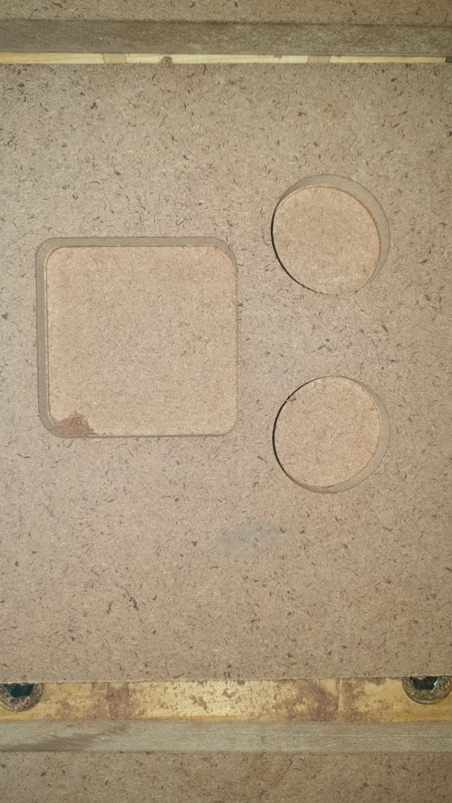

I did notice one stange thing, attached is a image of two circles cut side by side - the one on the left has been cut with climb milling and the one on the right with convetional (otherwise the toolpaths are identical). the circles are both screwed the same ammount but in opposide directions.
It seems that the problems has to be with the software and not mechanical. Could it be the contoller board and stepper driver combination?

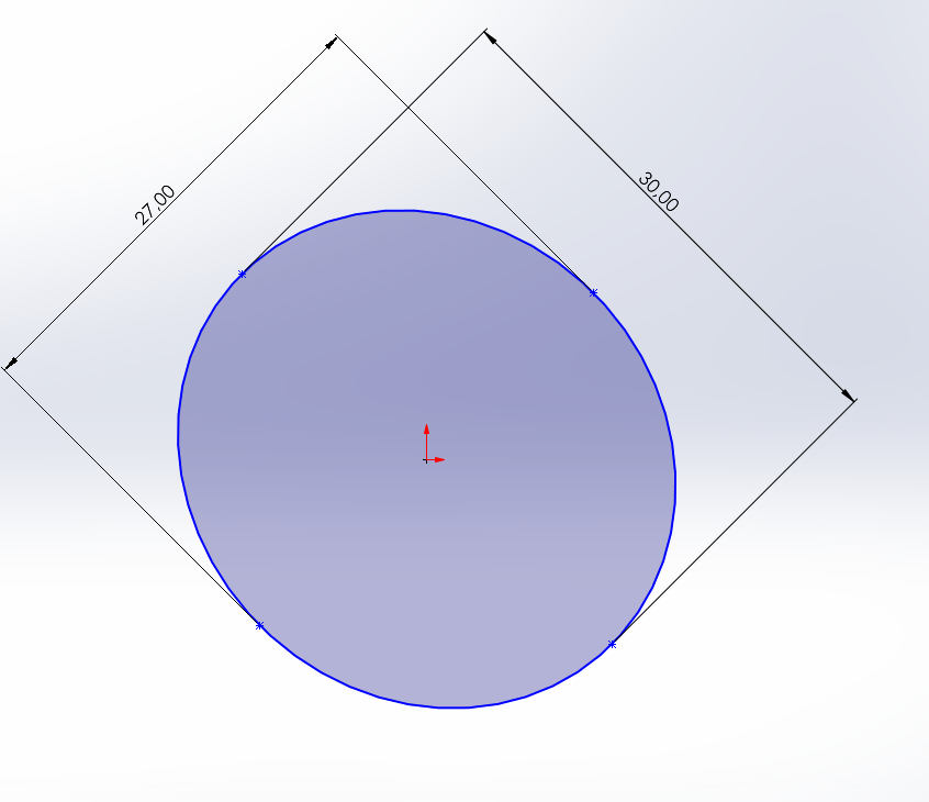

The circle is supposed to have a diameter of 30mm.
The largest measurement is 30mm and the smallest is 27mm (see attached picture).

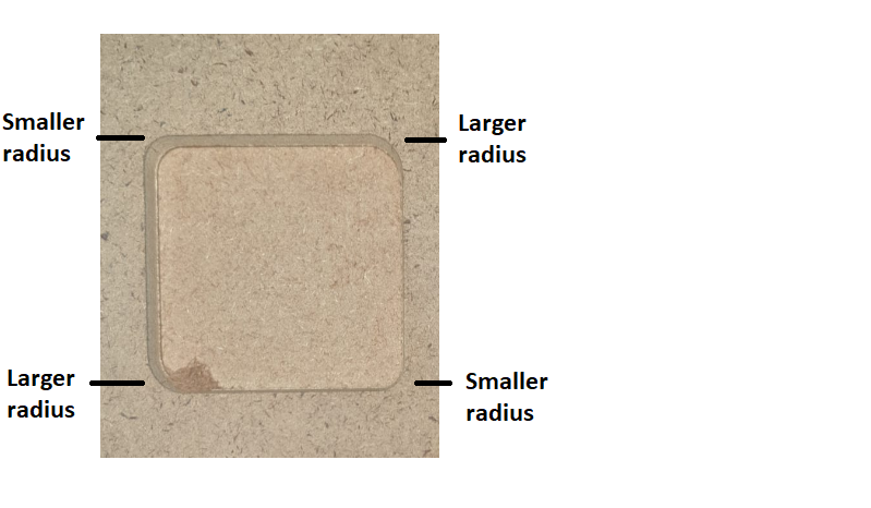

Pulleys are in both cases the same? Is it only on circles or also at rectangles?
- PeanutBlade
- Posts: 9
13 Sep 2021 07:22 #220429
by PeanutBlade
Replied by PeanutBlade on topic HBS57 and oval circle issues.
My machine uses ballscrews with direct couplings so there are no pulleys or gearing ratios.
Rectangles have the correct dimensions but the corner radius of the rectangles are not correct (see attached picture) - Opposing corners have the same radius but are not the same to the other two opposing corners.
