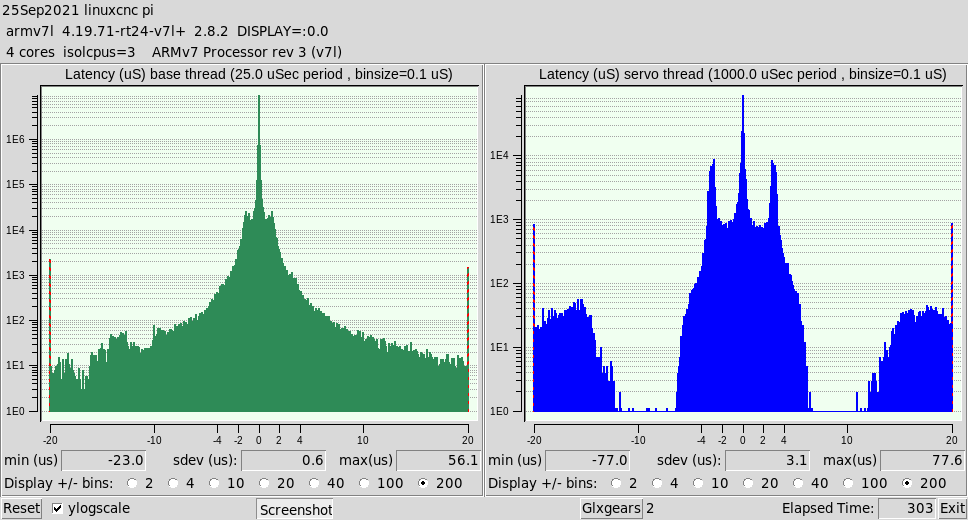

Does the attached latency plot look even half way normal for a rpi4 ? I get jitter result of around 75000 after a 10 seconds or so. Pinging 10.10.10.10 gives reasonable consistent times of 0.105, but every now and again it spikes up to 0.150 or 0.190. This plot is from a second
pi booting from an SSD (to allow me to test in the house where i have more space), but the actual pi in the workshop is running from an SD card.
I'm running and rpi4 with mesa 7i96, 7i85 and 7i73 and steppers. I've got a config that works to a point, but i keep getting following errors. I can mill manually commanding the axis for a couple of inches and it then throws a following error. It will also throw a following error whilst homing sometimes. Is latency on the servo thread (1,000,000) going to be the issue, or is it as likely to be settings in my hal/ini (which are both still work in progress)?
Here's the main settings for X and Y. Gearing on Z means that axis is set slightly differently. Stepper drivers are generic leadshine (i think, from stepperonline). whilst there are some entries in here from linear encoders they aren't currently being used for feedback.

You have the minimum ferror limit very small:
MIN_FERROR = 0.0025
(2.5 microns)
I would increase that to at least 0.01
As far as determining the source of following errors, the best way
is to first widen the following error limits (so you don't get a fault)
and then plot the following error (with HALScope) along with joint
velocity.
Also if the RPI is connected to the internet. make sure you have
ntp installed. The default RPI time demon (timesyncd) makes step
changes is the clock which causes changes in the servo thread
period too fast for the 7I96's DPLL to follow.
MIN_FERROR = 0.0025
(2.5 microns)
velocity.
Last edit: 5 years 1 month ago by PCW.

thanks PCW. Turns out i had the parameter specified twice, with one being redundant. Things are now much better with regard the following error.
I'm still wondering if the latency histogram looks normal? i haven't seen anything else on here that looks like that.

Note that the plot is +/-20 and the peak latency is 76. It might look a bit less odd at +/-100. But the gaps are, indeed, curious.
Replied by andypugh on topic RPI4 latency - is this normal
I think I have seen that castle in Lord of the Ringshaven't seen anything else on here that looks like that.
