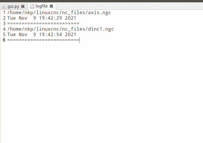

The file axis (the function task_run) can be changed like this:
def task_run(*event):
if run_warn(): return
global program_start_line, program_start_line_last
program_start_line_last = program_start_line;
ensure_mode(linuxcnc.MODE_AUTO)
c.auto(linuxcnc.AUTO_RUN, program_start_line)
program_start_line = 0
t.tag_remove("ignored", "0.0", "end")
o.set_highlight_line(None)
try:
fl = open('/home/nkp/emc2/logfile', "a")
fl.write(s.file + "\n")
fl.write(time.ctime() + "\n")
fl.write("=========================\n")
fl.close()
except :
print "nkplogerror"
it works without Mcodes

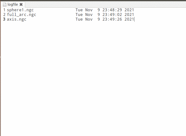

Is there any way to still generate a timestamp at the end of the cycle?
in one line?
try:
fl.write(s.file + 12*' ' + time.ctime() + "\n")
fl.close()
except :
print "nkplogerror"

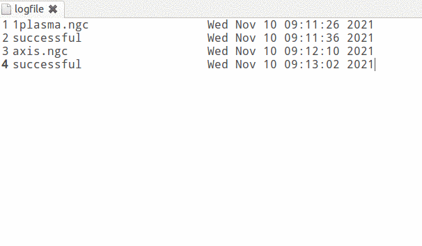

def update(self):
if vars.len_program.get():
if self.stat.motion_line > (vars.len_program.get() - 4):
vars.len_program.set(0)
try:
fl.write("successful" + 18*' ' + time.ctime() + "\n")
fl.close()
except :
print "nkplogerror"
user_live_update()
vars = nf.Variables(root_window,
("len_program", IntVar),
try:
s.poll()
count = 0
for line in open(s.file).xreadlines(): count += 1
vars.len_program.set(count)
lnf = len(os.path.basename(s.file))
fl.write(os.path.basename(s.file) + (28-lnf)*' ' + time.ctime() + "\n")
fl.close()
except :
print "nkplogerror"
def update(self):
try:
fl.close()
except :
print "nkplogerror"
user_live_update()
try:
s.poll()
count = 0
fl.close()
except :
print "nkplogerror"
