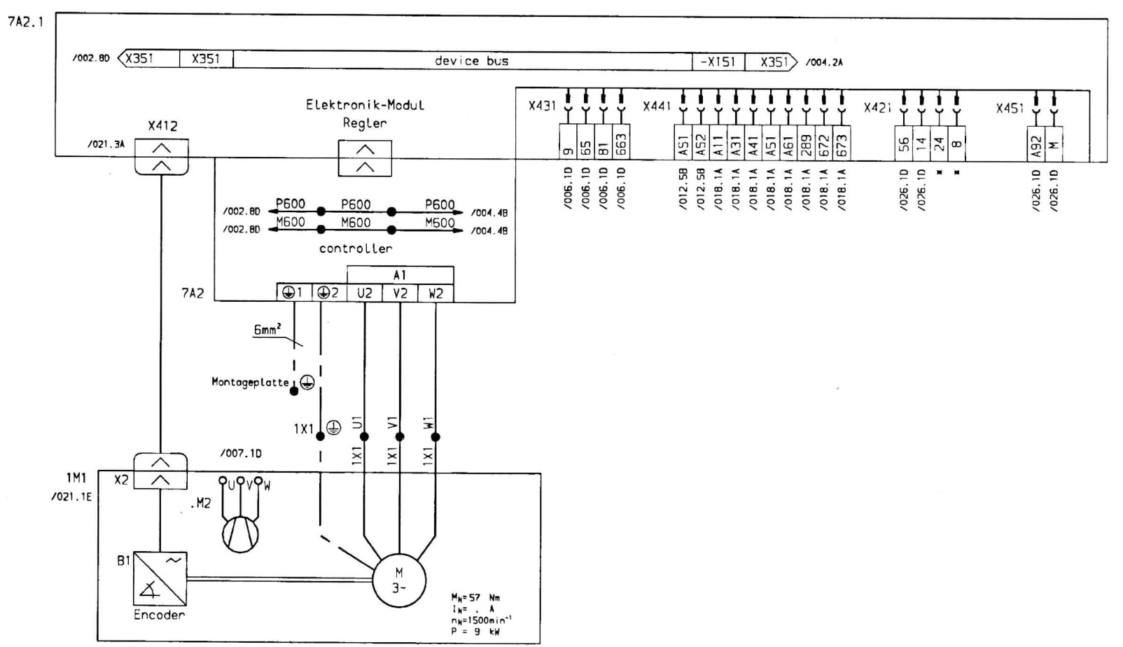

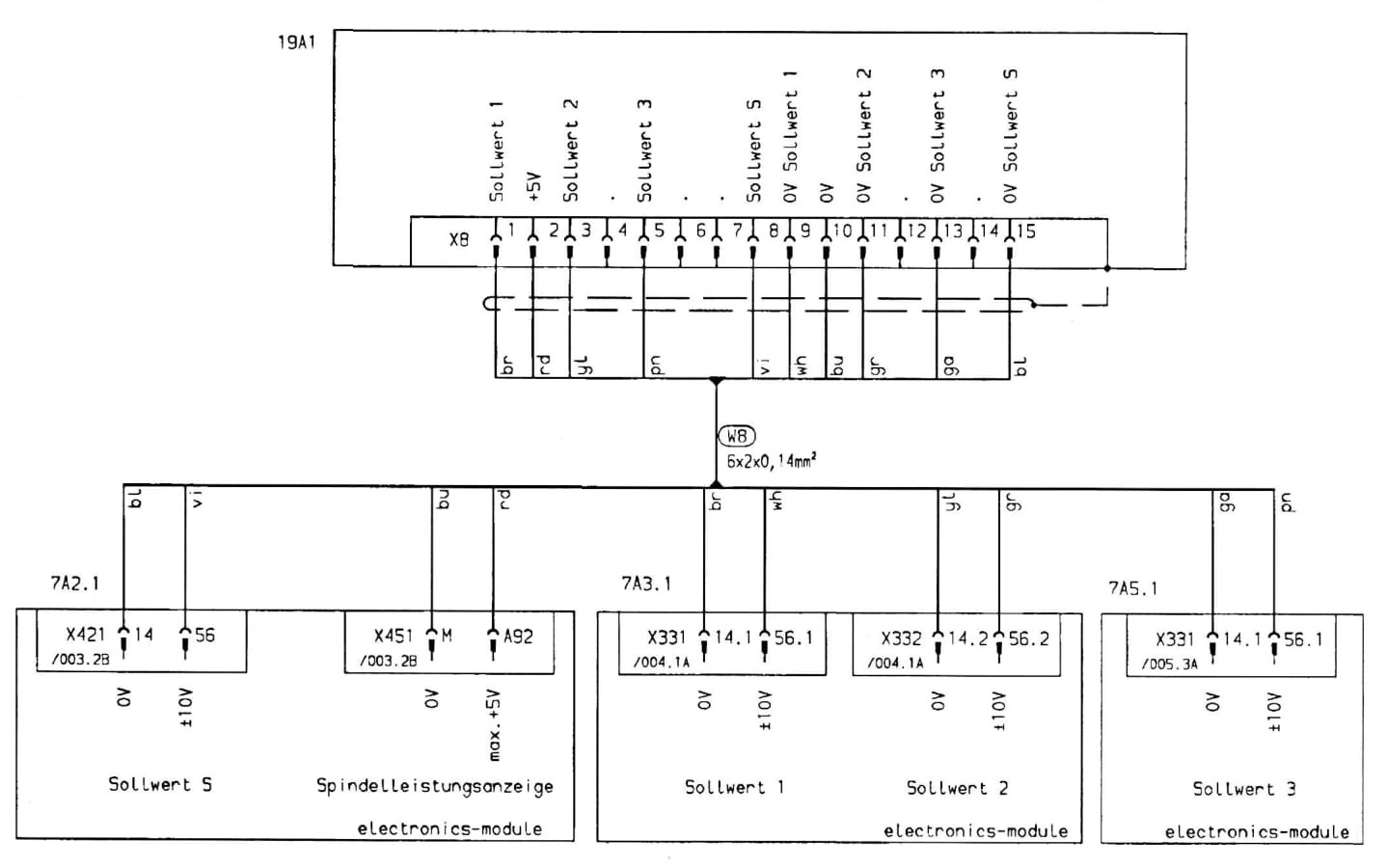

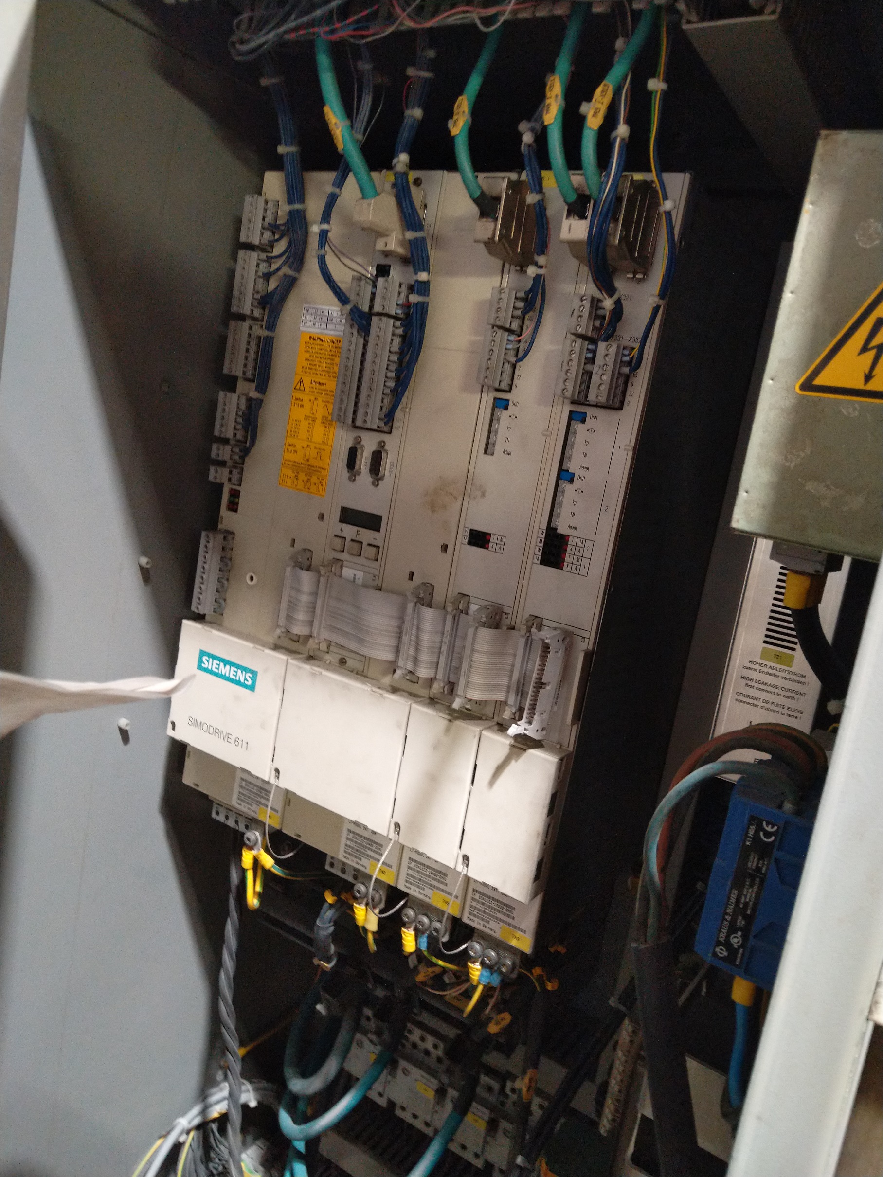

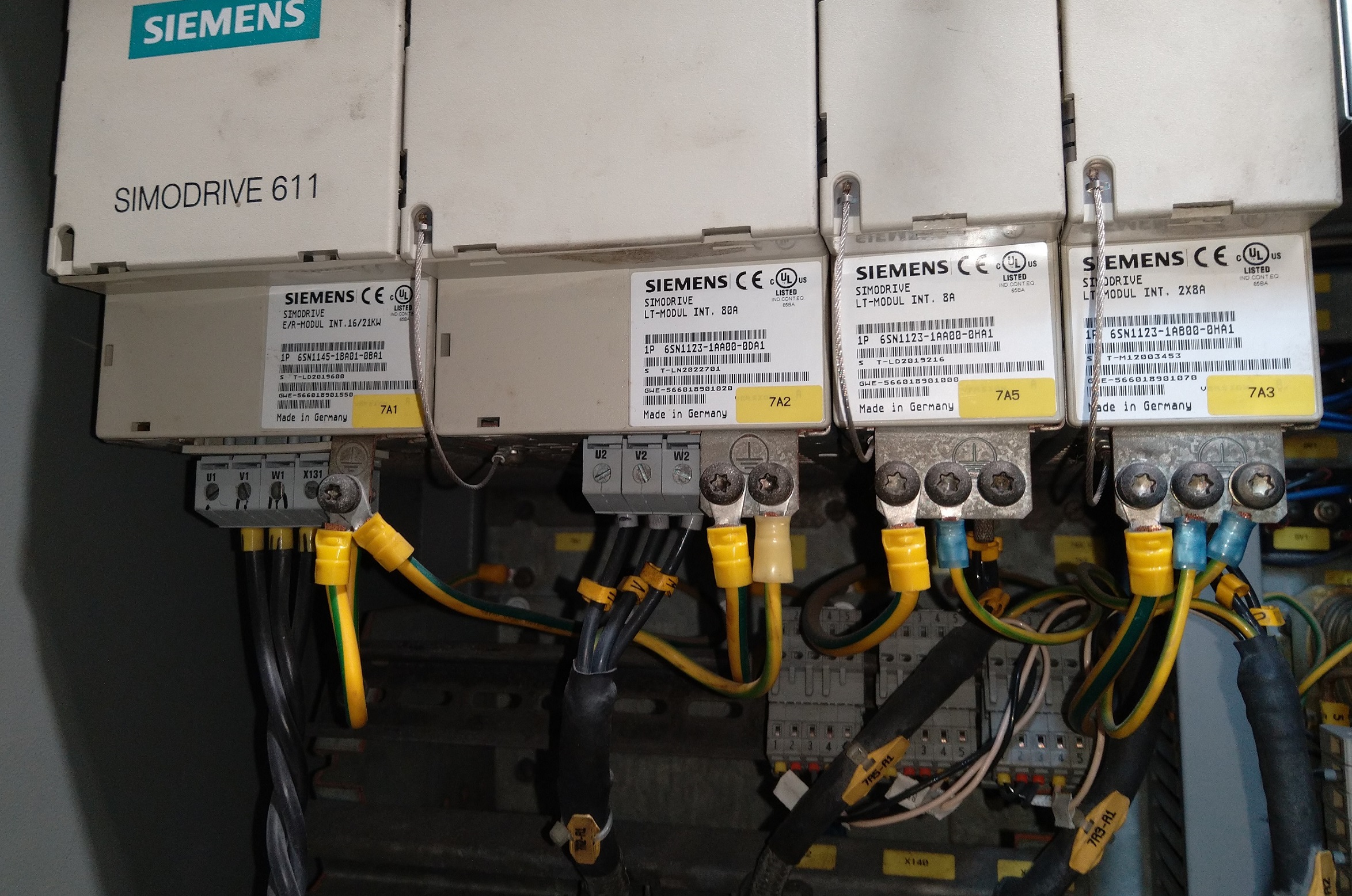

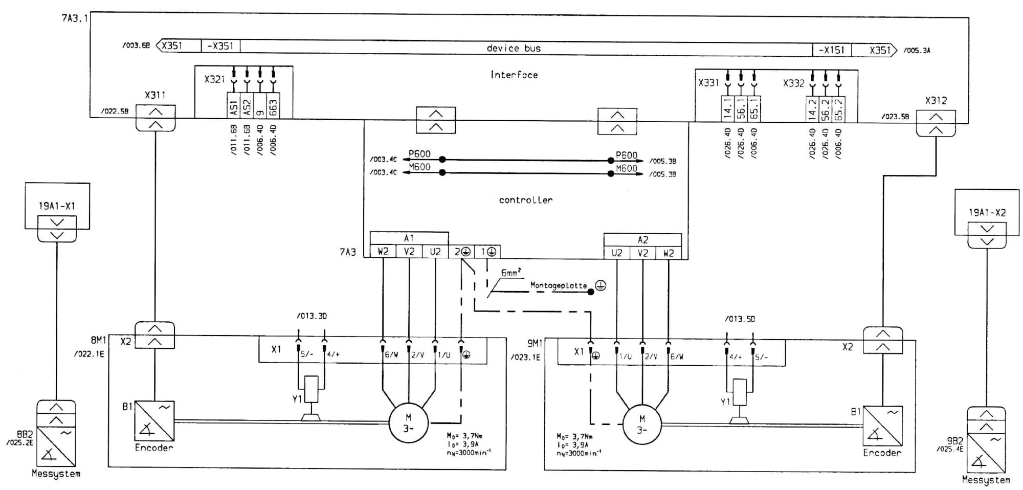

28 Nov 2021 04:34 #227808
by einarak
Replied by einarak on topic Converting an old DMU 50, where to start?
- ihavenofish
- Posts: 1031
- Thank you received: 287
28 Nov 2021 10:29 #227818
by ihavenofish
Replied by ihavenofish on topic Converting an old DMU 50, where to start?
so they are profibus, but they have configurable analogue IO as well (looking at the drive manual) which it seems your machine is using. will be 1ft5 or 1ft6 or 1fk6 motors - likely 1fk6 as this was a lower cost machine. drawings suggest the encoders are on the motor. siemens has full manuals for everything and you can actually buy new drives still.
they are also - of course - very high performance compared to many new drives you can buy even today.
I think ill be looking for a dmu 50 M now... haha.
