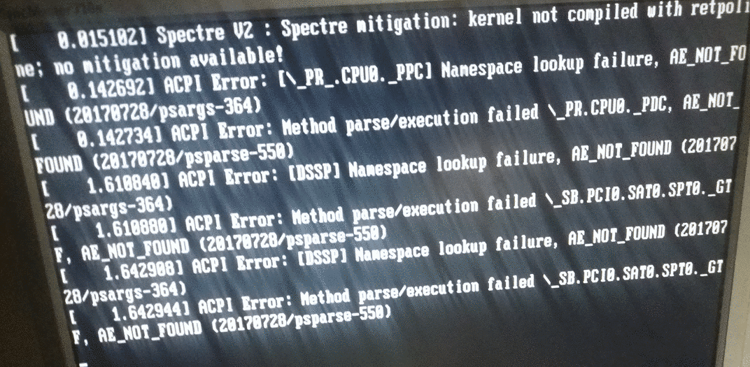

Hi !
how to remove error_output at boot

Replied by tommylight on topic error_output at boot OS
Picture, those are ACPI errors and should not inhibit functionality if the operating system loads.
Does Linux Mint start?
Does LinuxCNC start ?
What are the errors in the debug section if LinuxCNC does not start?

Replied by nkp on topic error_output at boot OS
Everything works perfectly! But the question remains - how to remove these errors from the screen?
Short of changing the motherboard, you can not.
And even then some errors will remain.
You cane check the
/etc/grub/default
that it has "quiet splash" in the loading line, most probably it will have it.
