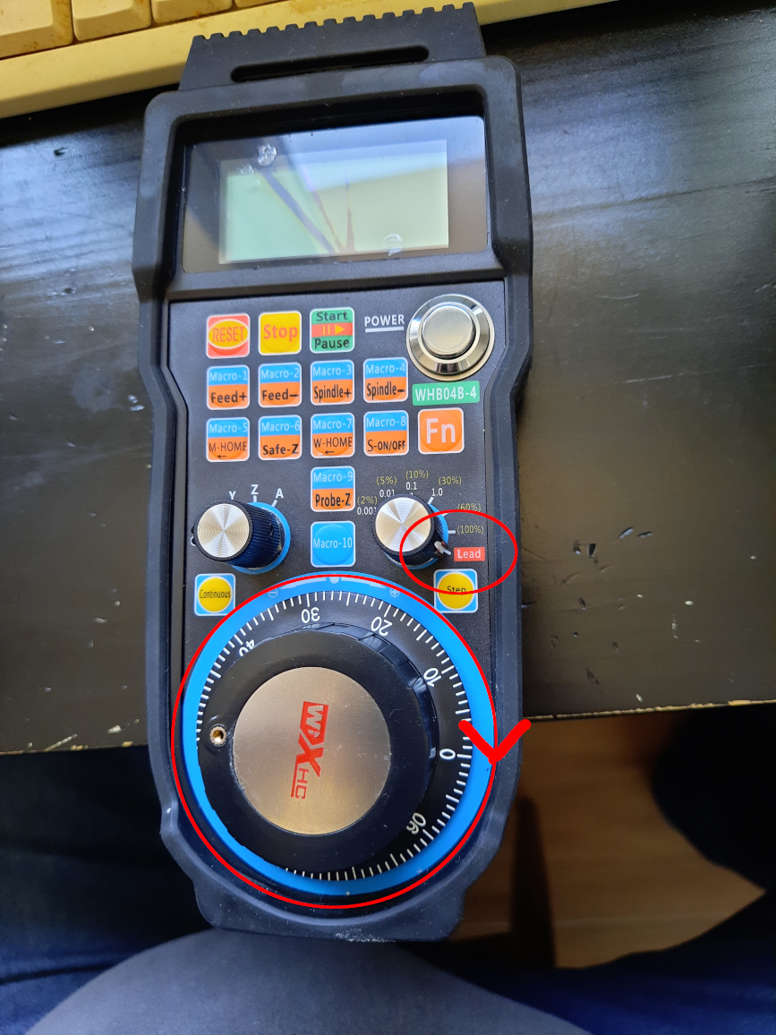

I want use OPTION:
But in real this OPTION do nothing. I don't know if this is a bug or I can't use the remote control I tried to press different combinations of buttons on the remote control, but turning the jogwheel does not affect any HAL pin related to SPINDLE or FEED.
I dont understand have to change feed. What mean "MPG + jogwheel" ?
I understand it for spindle"Lead + jogwheel" =>
it is so? But this make no change HAL pin.
-s Lead + jogwheel changes the spindle override speed. Each tick will increase/decrease the spindle override. -f MPG + jogwheel changes the feed override. Each tick will increment/decrement the feed override.But in real this OPTION do nothing. I don't know if this is a bug or I can't use the remote control I tried to press different combinations of buttons on the remote control, but turning the jogwheel does not affect any HAL pin related to SPINDLE or FEED.

Replied by alkabal on topic xhc-whb04b-6 OPTIONS [-f -s] dont work
Hi
For sure that work if you use the exemple hal file provided
The pendant support 4 mode and you can show that on the lcd.
Deffaut mode display MPG so you can directly use the jog wheel for see federate changing on the axis GUI slider
If you push continuous or step button you can see the Lcd displaying correspondant information this 2 mode the machine
Lead position is used for spindle feed override (check axis GUI slider)
After going back from lead you come again to MPG and corresponding federate override.
The only know options that does not work is the B (for remove big step usage)
Best regards

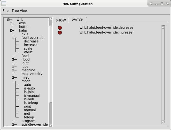

I would like to ask you two things:

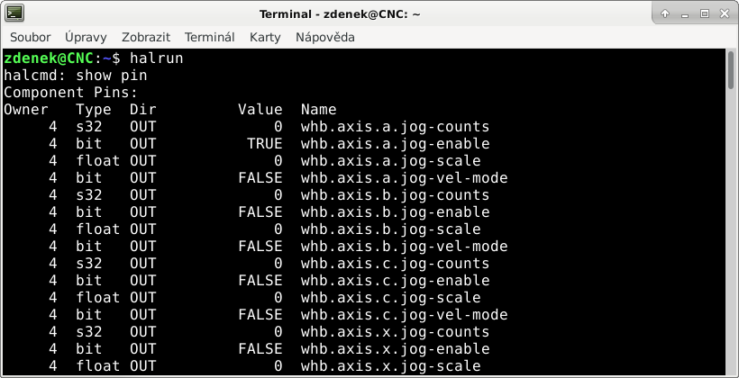

1) start a Halshow and see if these two HAL pins change when you change the feed with the wheel
if not look at Halscope.
2) do not turn off LCNC. Open the terminal and send me a pin list.

- alkabal
- Posts: 476
- Thank you received: 52
13 Feb 2022 23:49 #234772
by alkabal

I have to setp whb.halui.machine.is-on TRUE
and then
whb.halui.feed-override.decrease
whb.halui.feed-override.increase
works correctly.
But!!! It works until I click on button "Continous" or "Step" on pendant.
Can I ask you for other test?

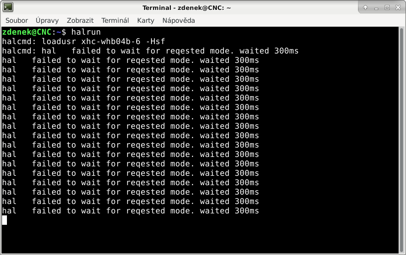

Dont run LinuxCNC only terminal with halrun and loadusr xhc-whb04b-6 -Hsf
Turn on pendant and then click all button and jog wheel on pendant.
Do you have the message "failed to wait for reqested mode. waited 300ms" ?

I think yes in some situation i get same error, the driver is not perfect, you welcome for propose change.
"whb.halui.machine.is-on" of course this signal need to be linked with your machine "halui.machine.is-on".
