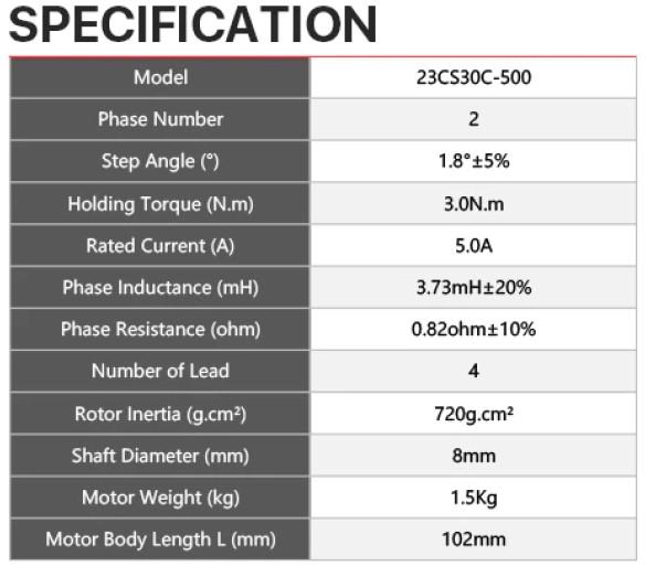

I think I found the root of my issues - Lack of power.
Confirm for me the following:
4 bipolar steppers with a rating of 5A will need (4 motors x 5 A/Phase x 2 Phase/motor) 40A supply.
Do we de rate this to 2/3 of the value per the Gecko document ?
I had been running with a single 48v, 20A supply.
Either way, dropping the amps allowed through the stepper drives to the motors improved performance and minimized/eliminated stalling. Bumping up the amps allowed through the driver made the stalling way worse (starved). The low amp torque is ok for cutting wood, but I need more power to get back to a more optimal amount of current for these motors.
Thanks for the help. Tim

You would not allow for 2 phases. I make it 4 x 5 = 20 amps /1.4 = 14.3 amps required. You have heaps of power and 48v its a good voltage.
