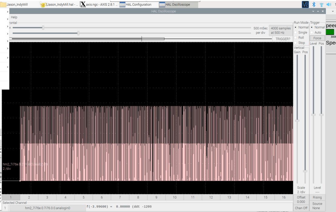

Hello,
I have a huanyang VFD, linuxcnc 2.8, and Mesa 7i76e, raspberry pi4. I have hooked it up using the Anchluss mesa instructions plus DIY CNC Design - Build a better CNC router
And i am now trying to get the Vo analogue output of the vfd ( which reports 0-10 corresponding to spindle rpm) connected to linuxcnc.
I have the Vo output connected to analogue pin 0 of the mesa board (TB6 pin 1), and i have the vfd ACM connected to ground of the power supply (same psu that powers the mesa). A multimeter connected between Field power ground and TB6 pin 1 shows the correct analogue voltage that matches the VFD output on Vo. But (after enabling reading of analogue pins via changing serial 0xxxx to 01xxxx) the Analogue input reported by linuxcnc in both halshow and the halscope (see attached screenshot) just jumps around between 0 volts and ~9.8 volts with voltages in between as well. Clearly i have something wired incorrectly, but for the life of me I cannot figure it out. I tried verifying the analogue inputs by connecting field power +24v to tb6 pin 2 ( analogue 01) and it reports 24.0 correctly.

Possibly the signal is very noisy (not unexpected from a VFD)
so a RC filter might be in order

so i checked with the multimeter Hz setting and it reports 1.3Khz between Vo and ACM. So i am thinking you are correct (noisy)

Yes, ahardware filter, since there is so much noise
and maybe even negative peaks which would not register
and cause errors if filtered in LinuxCNC
A say 1 K resistor and a 10 uf cap would be a good start

So that appears to have worked. I will have to order a 10uF cap since the only thing i had on hand was 100uF (which is what i tested with). The value reported in linuxcnc still flickers a little bit every once in a while (2-5second interval) and the value is a little 0.2 volts lower than what is being output from Vo (measured via dmm). probably have to just compensate by offsetting the value, or attempt to tweak something in the VFD.

Thanks again for all your help. I have now settled on 68uF capacitor (no flicker, but as low a value as possible to keep the responsiveness high (how fast it responds to the VFD pin changing voltage))
I used scalemax to get the scale mostly correct, but due to the RC filter the voltage output of the filter is lower than the voltage on the vfd's pin. I attempted to further correct this by scalemax, but it doesn't work. Since the difference between the rc filters output voltage and the vfd's pin voltage is not constant across the 0-10v range. I guess I need some complex curve based offset?

This should do:
linuxcnc.org/docs/2.8/html/man/man9/lincurve.9.html
