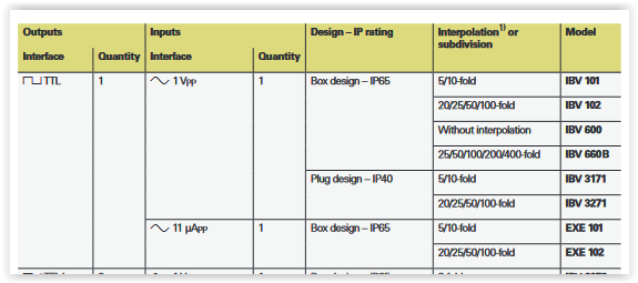

i have a liniair scale LS904 ml 370 from heidenhain on me mile machine
i'm not sure if the scale is broken or the input of the controle unit fails
how can i find out if the scale work wel ?
what is de basic set up ?
just power 5vdc on pin 3and 4 ?
when i use a scope between ground and an output what signal do i have to find or do i need a pull up or down resistor ?
i found in an old document somthing like 15microampere on the output
do someone know how to test the scale

These encoders typically need an interpolator interface card
(EXE series)
(EXE series)

Yes, but you will need the interpolator box that converts
the 11 uA Sine/Cosine outputs of the scale to higher resolution
TTL quadrature signals.
These (EXE boxes) are commonly available on Ebay

What controller you have on the machine ?
If it is old Heidenhain controller , then directly supporting the 11uA encoder so no EXE will be present .
If other brand controller obviously there will be EXE to convert into TTL quadrature .
To test whether 11uA scale head is alive , you may check for current flow by applying supply to pin (3)5V & (4)0V .
If no current flow observed then LED is dead and reader head wont work
For other pins 1&2 5&6 7&8 you can check with multi-meter on diode check mode.
or If supply connected to 3&4 , you can observe resistance will change on 1&2 5&6 7&8
This is the simplest method to know scale is working.
If you have access to old Heidenhain DRO you can quickly check the scale
