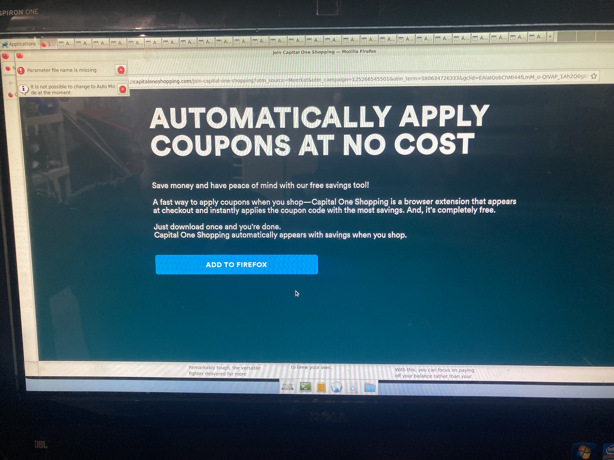

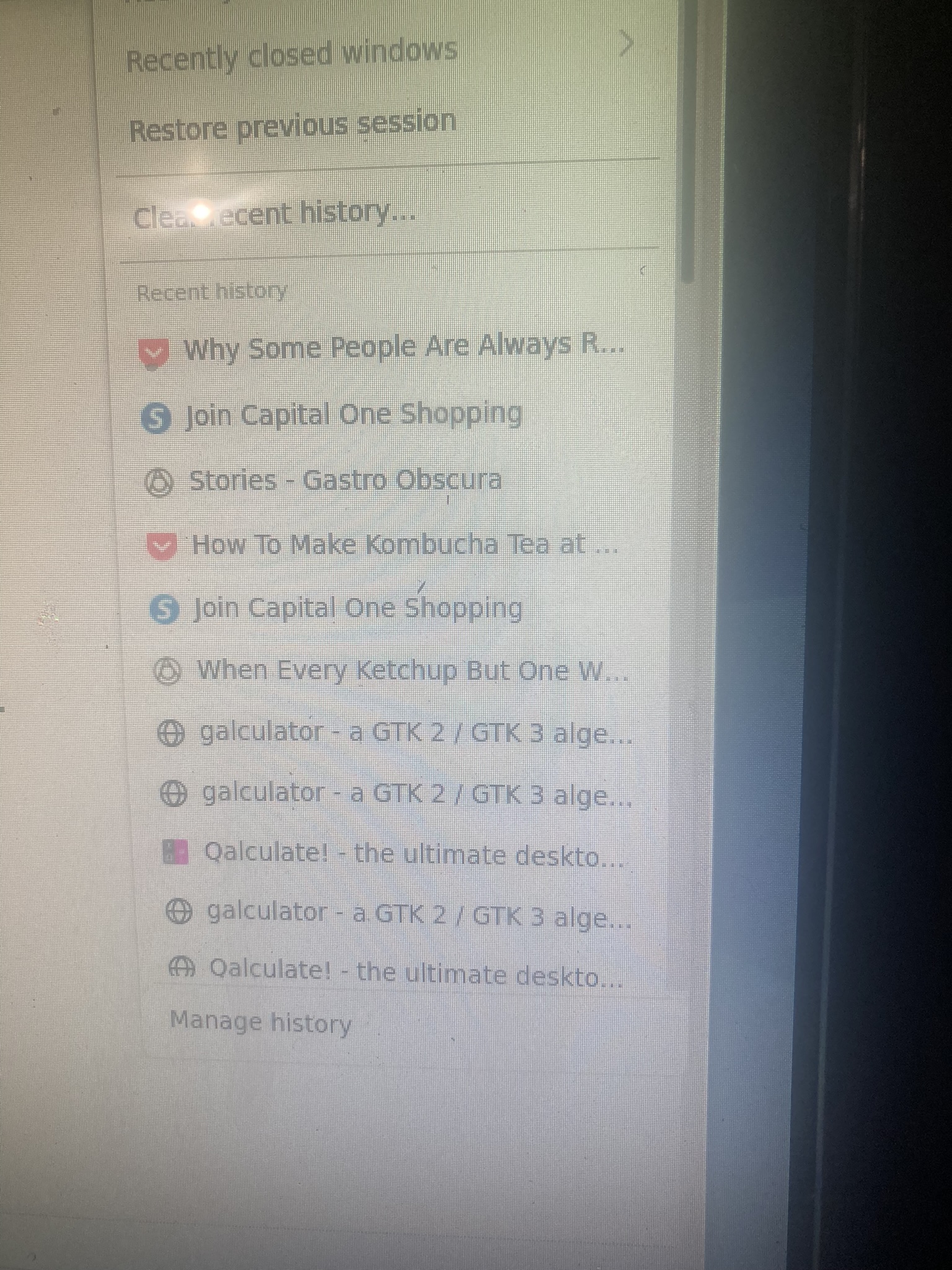

When I walked into my garage, my lathe had Mozilla Firefox open and the mouse was moving across the screen! Hundreds of terminal windows were open and hundreds of application launchers were open. The hacker opened capital one banking online. I was shocked! I wanted my dad to see this so I shouted for him to look, but the hacker clearly understood what I said and therefore stopped what he was doing. I will remove the wifi card from the computer, and only periodically connect with a USB wifi adapter from here on out. Fortunately I have no sensitive information stored on this Linux install, but this is extremely concerning. What can I do to find out what this hacker accessed? I will include a few cellphone photos of what the hacker connected to, but I feel like there must be more that I'm not seeing.

I would be far more concerned about firewall security. How did he get in? What other PCs is he using on your network?

can you post some info of what Linux flavour you were running (Debian/whatever) and what version it was
hence was it kept up to date with security fixes etc?
I presume that it would have been a Firefox breach, something like or via this.
www.google.com/amp/s/www.forbes.com/site...-security-flaws/amp/
important to keep up to date on security patches.
I don't think it will be a linuxcnc issue.

Screenshot shows Debian Wheezy or Buster.
Attack was through VNC or RDP running on the victims PC with weak password.
Hard to figure more from a screenshot.

I had this happen once.
I had been using RDP but they only way that I could get it to work between the Mac and LinuxCNC was to do it without passwords.
I _assume_ that the attacker was linked to my WiFi, as I don't think that there was any link through the router to the larger internet.
I got rid of the RDP and changed my Wifi password (and security type., I think) and haven't seen it happen since.
