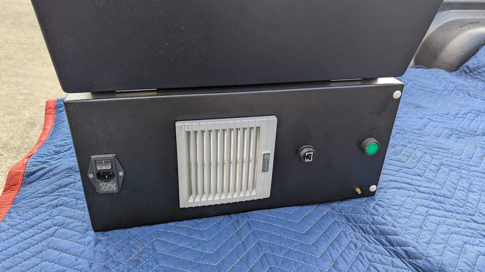

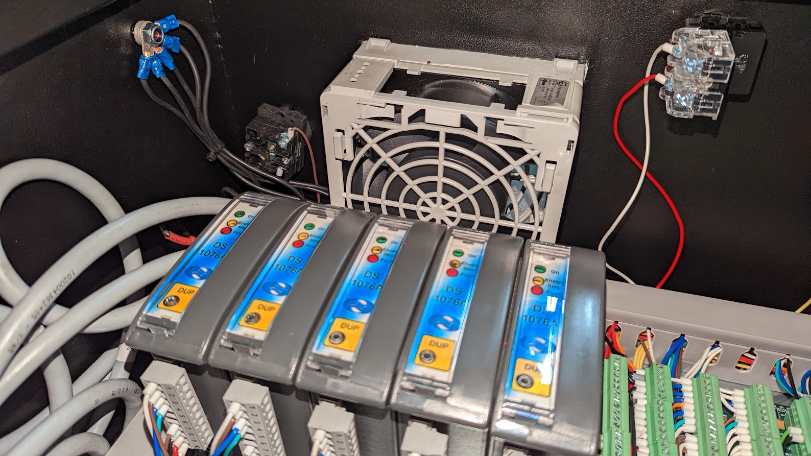

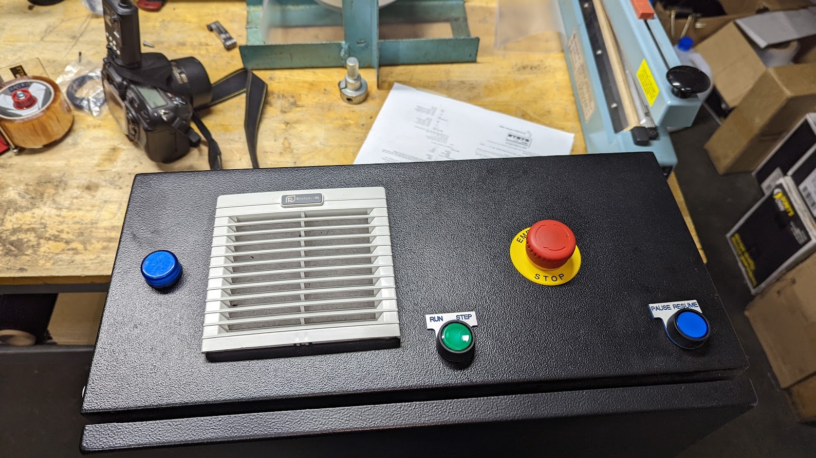

Fans need a fair bit of power so it does not really make sense to run them off DC voltage as it just means you need a lot bigger power supply than otherwise required. Here is an industrial one I used.
Fan inside
Fan outside
Matching vent
Replied by rodw on topic Material overview, wiring over view, and suggestions please
Mains power = 240v AC hereWhat do you mean by main powered fan? I think I fixed the 5th slide, how does it look now?
Fan inside
Fan outside
Matching vent
