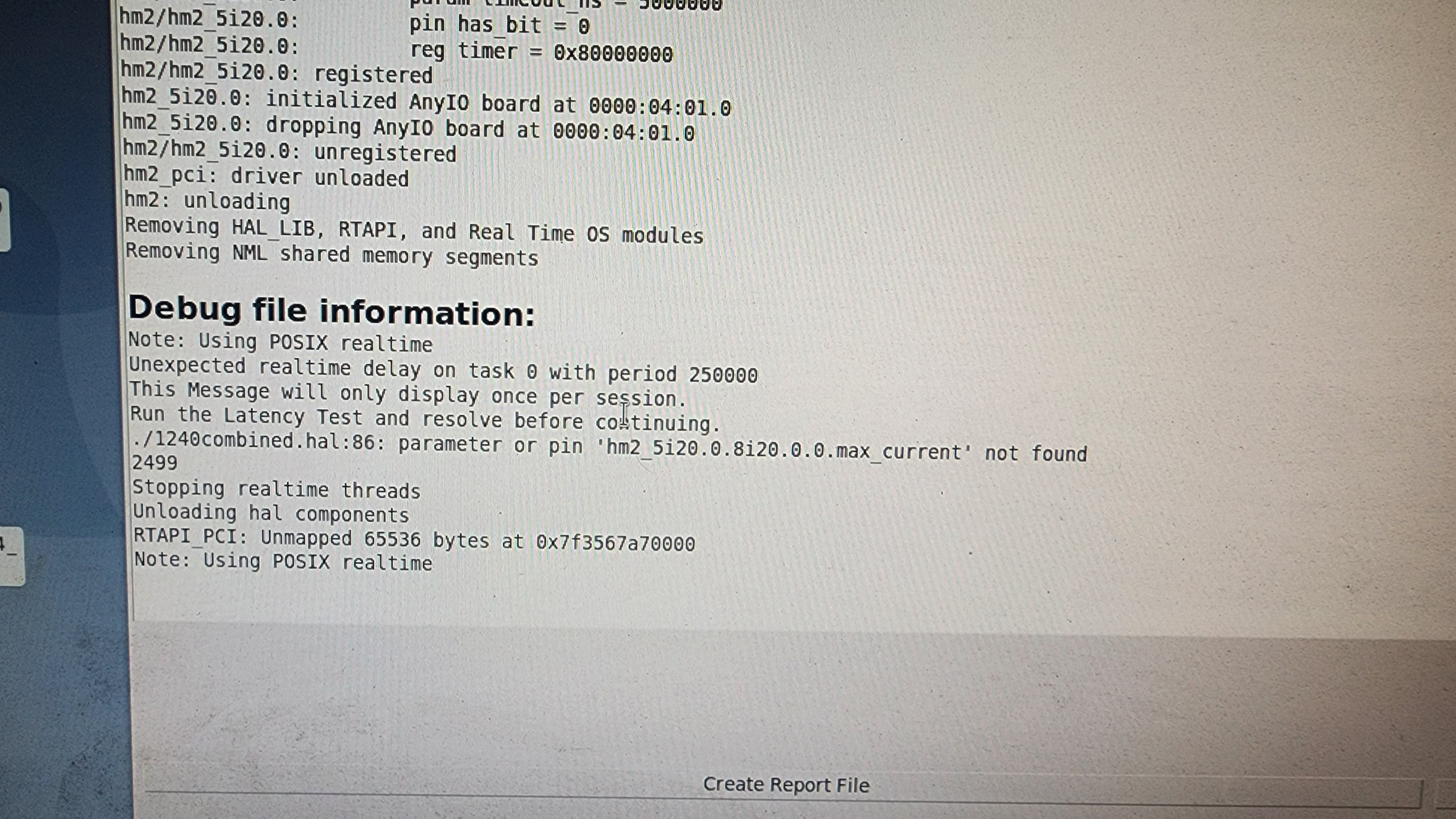

25 Sep 2022 20:51 - 25 Sep 2022 21:37 #252738
by LPMattei
Replied by LPMattei on topic loading LinuxCNC on old smithy 1240
OK, I moved the files and now I get a new error relating to 1240combined.hal max current. I ran latency test as it said, but I didn't see it matter. Attached are the error and section from 1240combined.hal file

- Posts: 18080
- Thank you received: 5316
26 Sep 2022 14:41 #252771
Replied by PCW on topic loading LinuxCNC on old smithy 1240
Is the 8I20 powered?
- LPMattei
- Posts: 58
26 Sep 2022 16:46 #252785
by LPMattei
I would have to say yes, if I swap in the disk with the old version SW it works fine
- Posts: 18080
26 Sep 2022 20:30 #252799
Can you try commenting out that line (line 86) in the hal file
and trying to start LinuxCNC again.
I think possibly some pin names changed over the years
- LPMattei
- Posts: 58
26 Sep 2022 22:42 #252811
by LPMattei
I tried that, then I commented the next 3 lines that failed.
# setp hm2_5i20.0.stepgen.03.position-scale [AXIS_3]SCALE
# setp hm2_5i20.0.stepgen.03.maxaccel [AXIS_3]STEPGEN_MAXACCEL
# setp hm2_5i20.0.stepgen.03.maxvel [AXIS_3]STEPGEN_MAXVEL
then it gave following error
./1240combined.hal:191: Pin 'hm2_5i20.0.8i20.0.0.amp_enable' does not exist
I feel like it is missing something and I will be chasing the errors all the way down.
