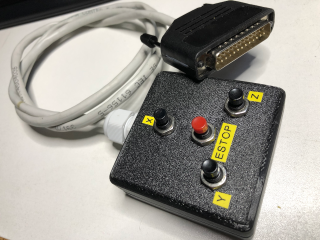

When I was using the mother board parport I have made a test box.
This box is wired according to this schema:
The HAL follow this pinout:
Using test box has no reponse in linuxcnc. Is there something wrong with theese datas ? I suspect 6i25 output voltage and 10k pullup/pulldown resistors of the test box.
# --- MACHINE-IS-ENABLED ---
setp hm2_5i25.0.gpio.007.is_output true
net machine-is-enabled => hm2_5i25.0.gpio.007.out
# external input signals
#--- ESTOP-EXT ---
net estop-ext <= hm2_5i25.0.gpio.003.in_not
# --- HOME-X ---
net home-x <= hm2_5i25.0.gpio.013.in
# --- HOME-Y ---
net home-y <= hm2_5i25.0.gpio.014.in
# --- HOME-Z ---
net home-z <= hm2_5i25.0.gpio.015.inUsing test box has no reponse in linuxcnc. Is there something wrong with theese datas ? I suspect 6i25 output voltage and 10k pullup/pulldown resistors of the test box.

Mesa 6i25 inputs have their own pullups, so they need to be grounded to trigger.
Shorting them to gnd works, or use a DVM set in Diode mode, red probe on gnd, black probe on inputs.

Did I have to move W4 down to disbale 6i25 internal pullup resistors ?

No.

The test box works with parport. Wiring is OK.
Replied by macsddau@linuxcnc on topic SOLVED - 6i25 Can't see swicthes change from test box
Internet is your friend. I kwon what is dvm.
I don't know what is is a "a DVM set in Diode mode".
Is ther any shcmatics for shorting to gnd or dvm set ?

I will make a new test box

No need, you can invert inputs by adding "_not" to input pins in hal.
