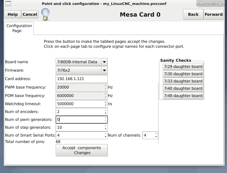

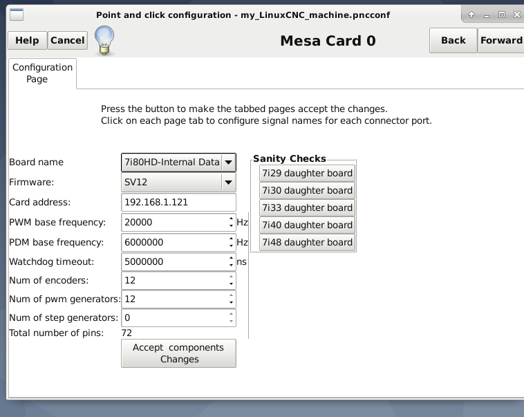

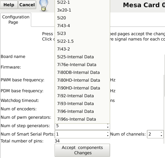

I did quick install LinuxCNC 2.8.4 Debian 10 Buster PREEMPT-RT ISO into virtualBox just to see if I can config that stuff.
In the Pnconf the 7I80 DB and HD are available, but 7I94 are not.
Now for 7I80DB only 7I76x2 firmware are available, and PWM for servo can't be set.
But 7i80HD have many firmware available (SV12 as default) and servo are available.
As only 7i80DB are on stock, how to configure that if 7i80DB->7i77 can work at all.
Custom firmware and all work to do manually?
