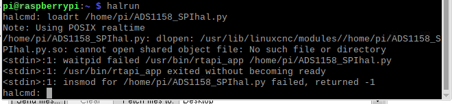

loadrt hal_pi_gpio dir=67107903 exclude=960
loadusr -W /home/pi/ADS1158_SPIhal.py

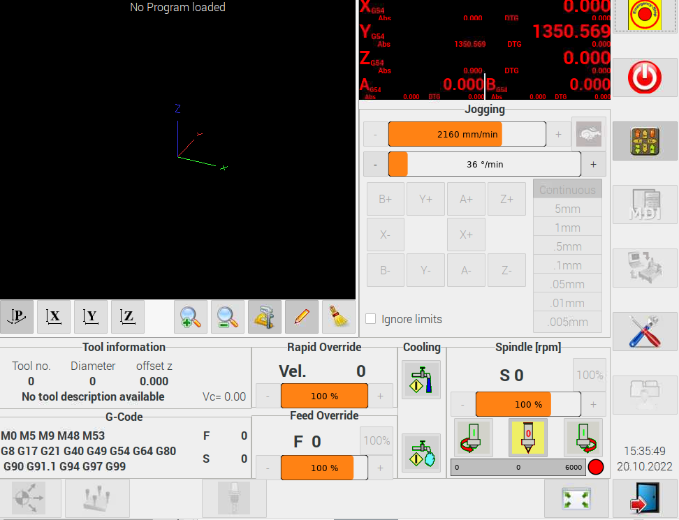

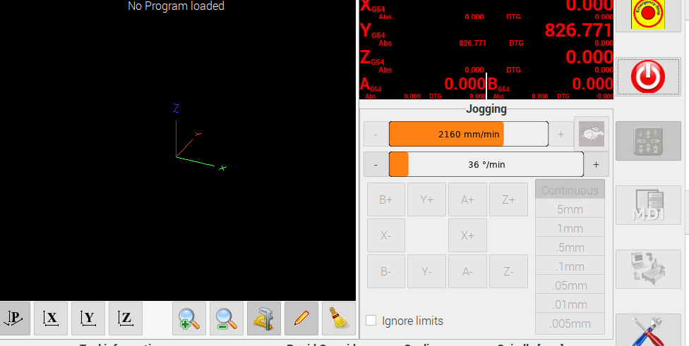

just an update: i am not even sure what is going on
Yesterday it runwaway, because I accidental change from stepgen-pos-cmd to stepgen-vel-cmd without realise it was is in the pos-cmd, so it always run off. I fixed that and the results is that I have a open-loop stepper with sensor as the report of the distance. see picture, open-loop. (i always want to ask how do I embed picture in the reply?)
Now, the system won't move and it is controlled by velocity. but now it has two issues:
1) the sensor reading drop off a lot even when the op-amp and sensor output signal is constant. MY SPECULATION is that spidev is too slow, and linuxcnc rt component just took away the processing and cause the input reading to be weird. Despite the fact that both the analog voltage and ADS is transferred the right signal (observe from the scope). so everything is working just linuxcnc is not reading the ADC output correctly. I am sure that it is linuxcnc not loading the input properly, net ypos-fb sensor.out -> motor-pos-fb, becuase i can run the python code for hours without a single incorrect reading.
The second thing is, with open loop control. there are no following error, but I am not sure how to tell if I am moving it accurately, since i got the Ferror so huge at 500, I guess I would have to move an assumed fixed distance (Y2000), and check if the sensor feedback increase by 2000?
Then I tried to do the PID control,.see code, XYZA-7-fb.hal and ini
i couldn't do much most of the time since it still have incorrect reading problem. and for the short time it works, the movement seem .....exotic. I guess tuning PID will take a while. But I believe open loop work reasonbly well after I calibrated it.
Man, I really need a beer after this.

ok, i know that we loadrt stepgen and pwmgen, and in the component folder of the code, they are is .c file
meanwhile, there are other components for example a not and sum2, they are in .comp
they are written quite differently. . I also notice that in the .c file, there is a rtapi_main function, i believe this function run when the component is called, this is perfect for the setup if I want to configure the sensor register when I load the component in the hal code. However, I don't see many .comp do that. meanwhile, .comp doesn't seem to be loading many libraries, Is there any comp that use function from another libaray?
Is it possible to also have the main function for .comp, so I can run some functions only once?
and what are the major different between writing in .c and .comp directly? It seem like there are two way to make comp and strange to find that most basic function are writing in .comp and the more complex in .c

Thanks!, this is mind blowmind, this has way better documentation than the one i was reading, sometime when you search on google they give you link that are years ago.
Anyway, Here quoted"
"option userspace yes - (default: no) If specified, this file describes a userspace (ie, non-realtime) component, rather than a regular (ie, realtime) one. A userspace component may not have functions defined by the function directive. Instead, after all the instances are constructed, the C function void user_mainloop(void); is called. When this function returns, the component exits. Typically, user_mainloop() will use FOR_ALL_INSTS() to perform the update action for each instance, then sleep for a short time. Another common action in user_mainloop() may be to call the event handler loop of a GUI toolkit."
this make me think that userspace shouldn't cause the SPI communication drop out I experience. Now, I can't even understand how my dropout occur!
i will type out the full code in a few hours. I am thinking
component ADS1158_SPI;
option userspace;
option userinit //i believe this option allow me to have a run once routine at the beginning of the code
pin out float out;
license "GPL"; // indicates GPL v2 or later
#include <pigpio.h> // i foudn this llibrary allow me to use SPI in C code on Rpi
void user_mainloop(void) {
while(1) {
/* sudo code
SPI open
get data from SPI 32 bits long for 16 bits ADC data
SPI close
feed raw 16bits data to moving medium
feed again to moving average
convert moving average output from count to (float) mm
out = float_mm;
void userinit(argc,argv){
SPI open
SPI Xfer 5 bytes of configuration
SPi close
let me know if this sudo code make sense. i will work on the actual code now
