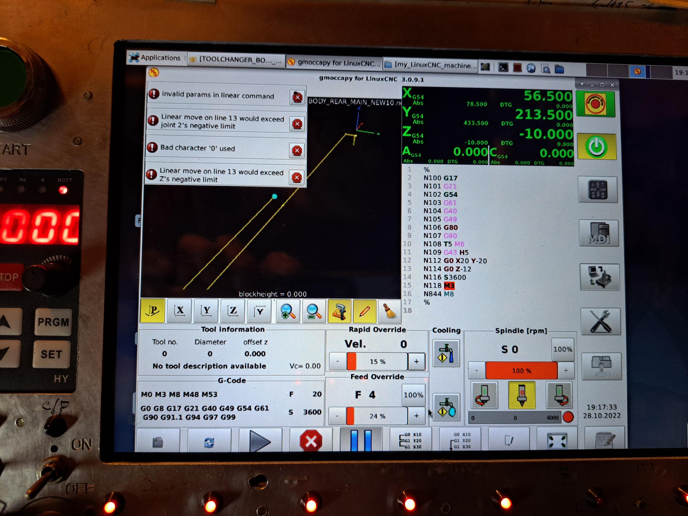

hello,
I have the problem of G43. After the probing, tool offset value for the corresponding tool did enter(or edited in)the tool table, the first question is the value, it is not what I expected, the next question is the tool length offset is not implemented in the G43 code execution.
I finished building the toolchanger, but in CNC machining code working, it does the followings:

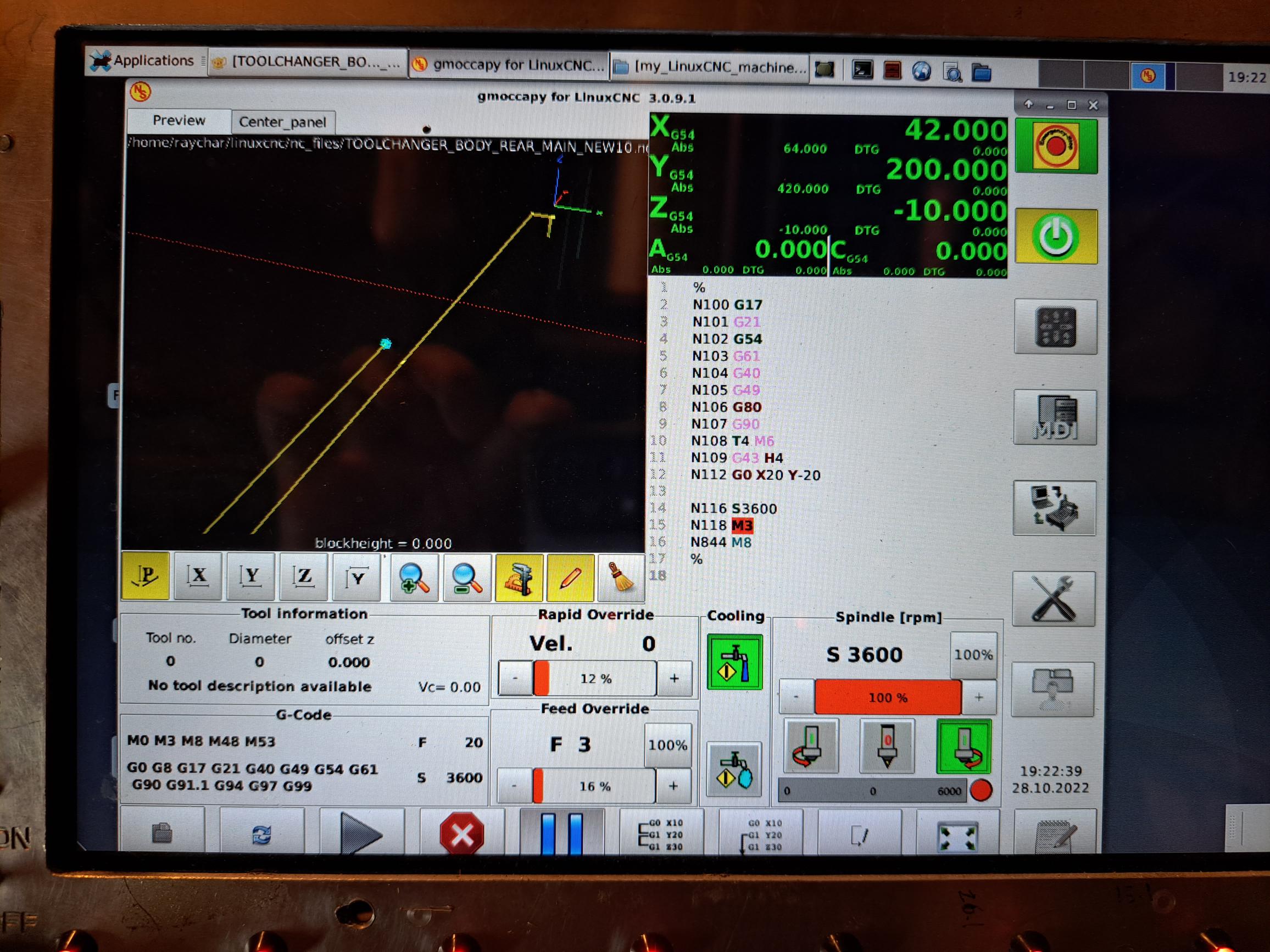

Here, shown in the two attached pictures, a simple several lines of codes are written for testing. Tools can be auto-changed and the tool length probing are carried out. But neither of them the tool length offset can be implemented:
> in the first picture, it didn't complete all the codes. After proceeded tool changing and probing, the machine stopped during the X Y axis distance moves
> in the second picture, I deleted the lines 13 Z=-12, it completed all codes but no Z tool length offset happened showing in Z DRO value
(X offset is 22, Y offset is 220)

Have you reloaded the tool table after editing it?

>it did write to it automatically after probing, when I re-open the tool table file, changed value was observed. But, it didn't do any Z tool length offset during running the codes that including the G43 code
>in the first picture, why it always gives warning that line13 Z value exceeds the limit? whatever I change its value, it gives this warning

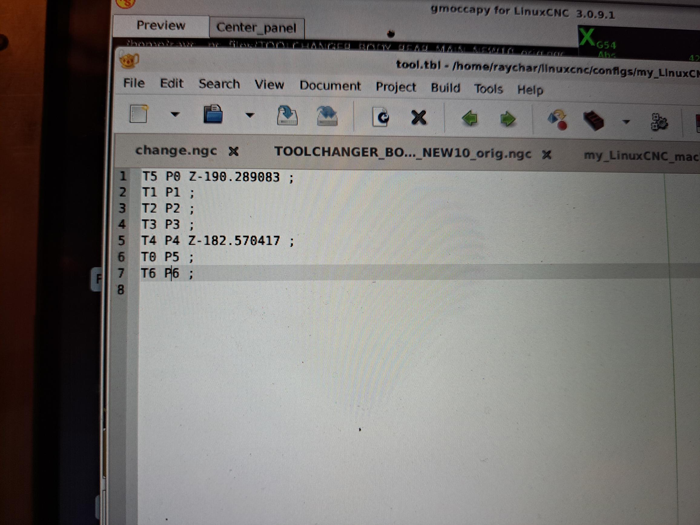

Sorry, actually there was tool length offset happened, I missed the observation during the program execution. it is because the test program is short, it ends quickly and cancel it automatically at the end of it.
However, the tool length value is wrong, the tool table messed up, the T5 matched with P0, while the T0 matched with P5. I edit it by inputting a new correct value and save it. When I input G43 H5 again in MDI, it doesn't load the new value, it still use the old wrong value. Why the value always goes wrong?

What are the actual axis limits? Are you sure that -180mm is the correct tool length?
What happens if you load the tool and apply the offsets with G43, then touch-off the working coordinate system to Z = 0?
Though more importantly, in the screenshots, there is no tool shown al loaded anyway, it looks like the tool change is not being completed.

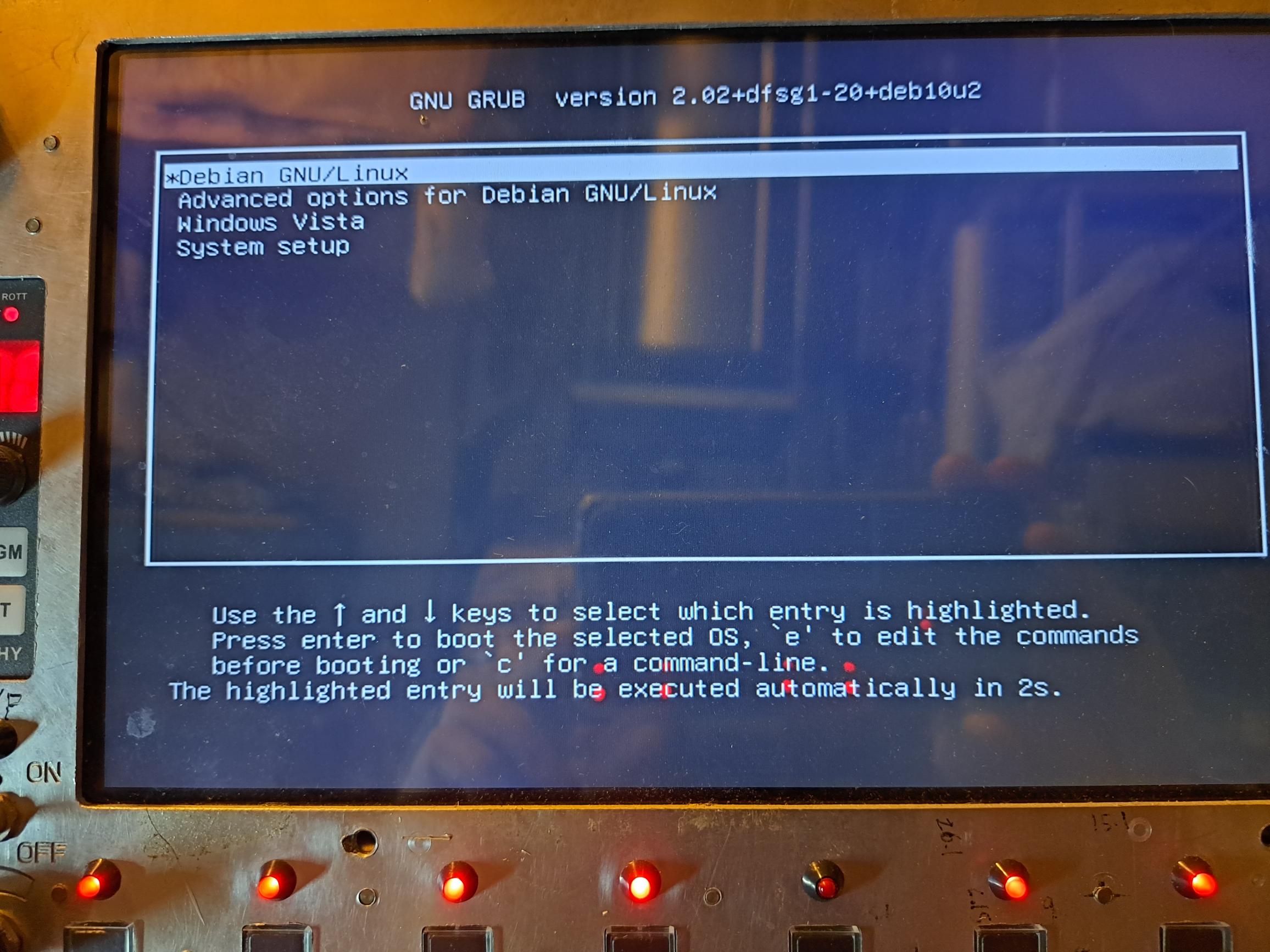

Struggled for a week, i still can't get internet connection both in wireless or in wired one, so i can't get it updating. May be due to my debian version is an old one or my system is dual boot type(windows and linux). There is lack of Linux commands of lshw, ifconfig and files netplan etc
There is wicd network manager, so i did : i) for wireless, it shows my home wireless router signal but the input password can't be accepted. ii) for wired one, I added a new one, choosing DHCP, but still can't connected while the wire network port socket lamp is lit up and flashes.
I think i need to download the file separately, then to have fresh installation instead to use Synaptic Package Manager to update to the latest version

Wicd does not allow more than one active connection, so installing "gnome network-manager" and removing wicd is the way to go.
There are several posts on this forum about that, please do a search.
