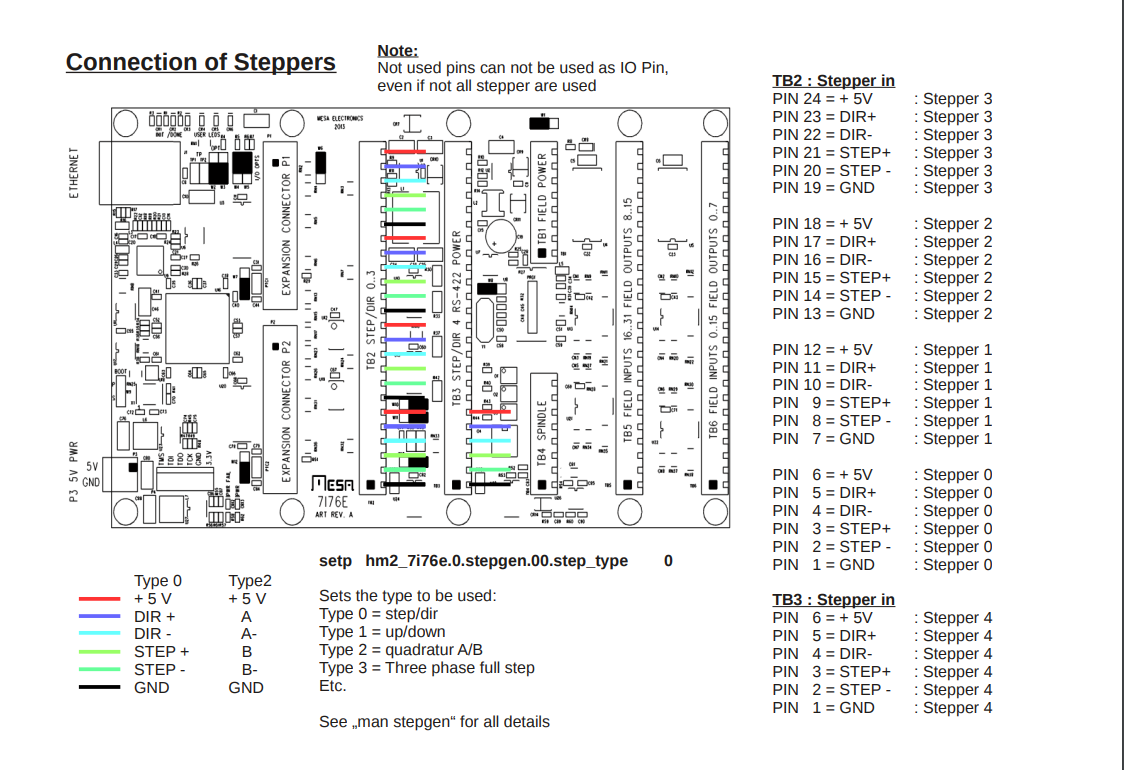

I am building a 3 axis vertical mill and have spent more than a month trying to get the motors to run.iI am using raspberry pi 4 and MESA 7i76En step generator with 3 CL57T (v4) stepper controllers (closed loop)..
X and Y axis both work fine in pncconfig but I always get encoder fault on the CL57T for Z tests as soon as I try to move it.
So far I have tried -swapping motor positions - always Z died so not motor.
swapping controller positions - always Z dies so not contrroller.
Swapping encoder leads - always z drive died so not leads swapping MESA stepper leads - always Z died
swapping order of mesa connections - always Z died
I have noticed that often on moving X or Y the Z motor will make a noise, without movement.
Anyone have any additional ideas to test?

where is your motor wired?
X-Axis is stepgen.00
Y-Axis is stepgen.01
Z-Axis is stepgen.03
What is on stepgen.02?

Was on Stepgen 2 but was trying 3 to eliminate that as an option

I understand. I was using Stepgen 02, but on the files sent I had tried using Stepgen 03 to eliminate the Mesa card Stepgen 02 from the error chain in case it had been damaged in the previous attempts

Are you having this problem with LinuxCNC or pncconf?
The noise from Z when you move X,Y really sounds like a wiring issue
Suggestions:
Test with LinuxCNC, not pncconf
Change this hal line:
set setp hm2_7i76e.0.dpll.01.timer-us -50
to
setp hm2_7i76e.0.dpll.01.timer-us -200
Check the Z wiring
Change the step/dir wiring to single ended:
Drive DIR+ and PUL+ to 7I76E +5V
Drive DIR- and PUL- to 7I76E DIR- and PUL-
Suggestions:
to
Check the Z wiring

The only way that is physically possible is the motor is wired wrong or dead, nothing else. You have mixed windings on Z.So far I have tried -swapping motor positions - always Z died so not motor.
This is always power wiring related OR the dir pin of Z axis is wired to step pins of other axis.I have noticed that often on moving X or Y the Z motor will make a noise, without movement.
Or your explanation is mixing things up.

Hey , I have the same motors, I had the same issue, and Ive seen several others on the forum who have had the same issue.
- Check encoder wires are not loose at driver end (mine was one wire came loose)
- check encoder wires are the same as other drives (other guys on forum had this issue)
- Put drive in to open loop mode and try that, if it works in open loop mode, its an encoder thing
I have this with all 3 axis, I assume its a driver current tuning thing, but I dont want to install the china software to adjust the settings, so Im not sure.

A system that runs in pncconf and not in LinuxCNC often points to a problem with the "enable" wiring. (ie, it is actually configured as a disable). With most stepper drivers it is best to just leave enable inputs unconnected (but check)
A stepper drive should not be able to damage a 7i76. But a motor can certainly damage a stepper driver. Especially if one phase goes open-circuit.
If the motor is wired 2-phase bipolar then you should see a low resistance between A+ to A- and B+ to B- and nothing between any A and any B. It's not unknown for stepper motors to be mis-wired.
It's harder to work out if the phase direction is wrong, which would reverse the motor and lead to an encoder-to-motor plausibility fault. (But you say that the motors have all run?)
