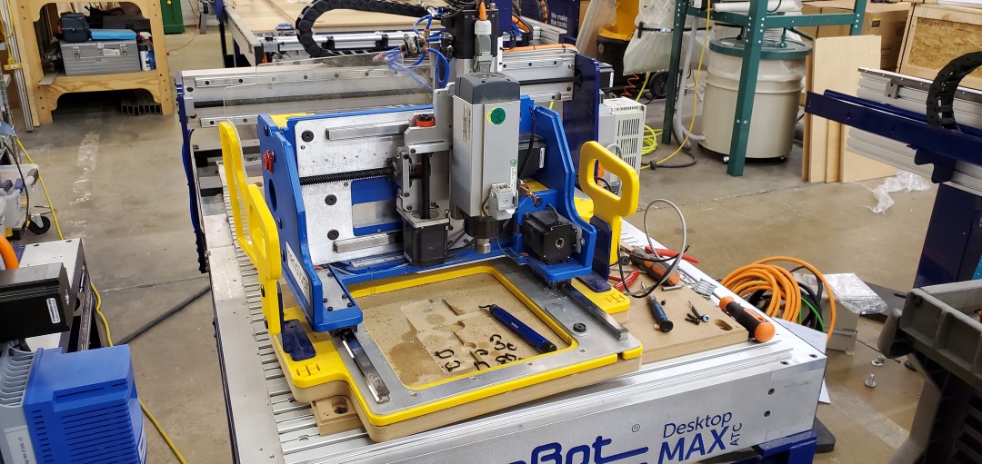

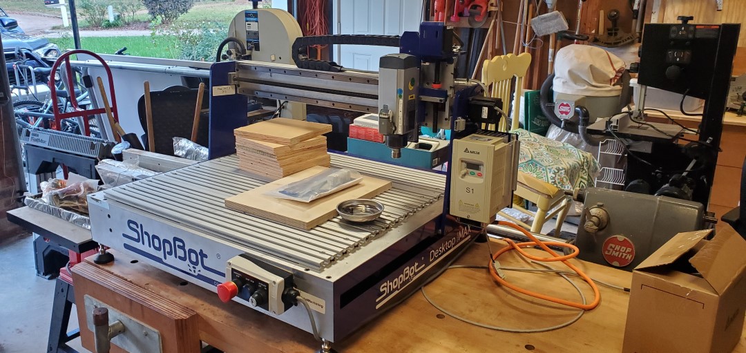

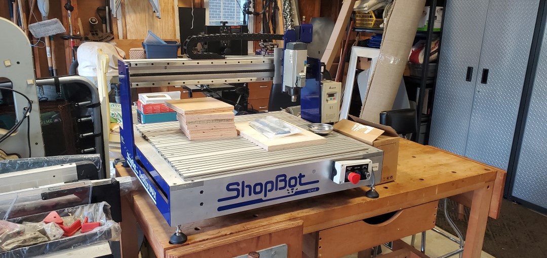

- rusty_parts
- Posts: 4
17 Nov 2022 14:05 #256930
by rusty_parts
Replied by rusty_parts on topic Connecting to my CNC Machine
Here's a couple pictures of my machines. I have a ShopBot Desktop 24x18" and a Handibot. The Desktop is new to me and came with no VFD or spindle so I am in the process of re-wiring it. I modified the Handibot to accept a 1hp spindle instead of the router that came with it. Both are running on the ShopBot software currently and I want to convert one or both to use with Linux.
