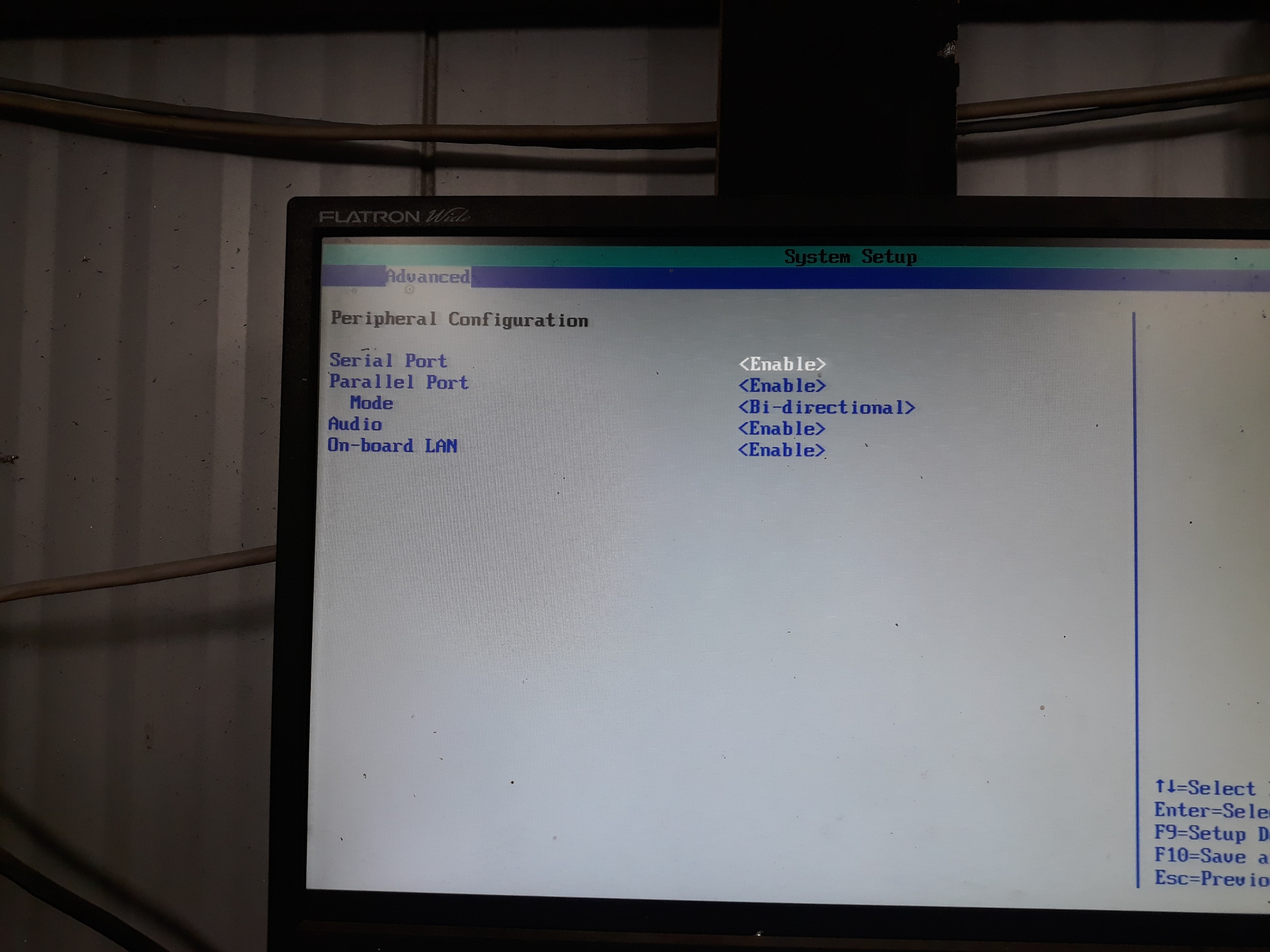

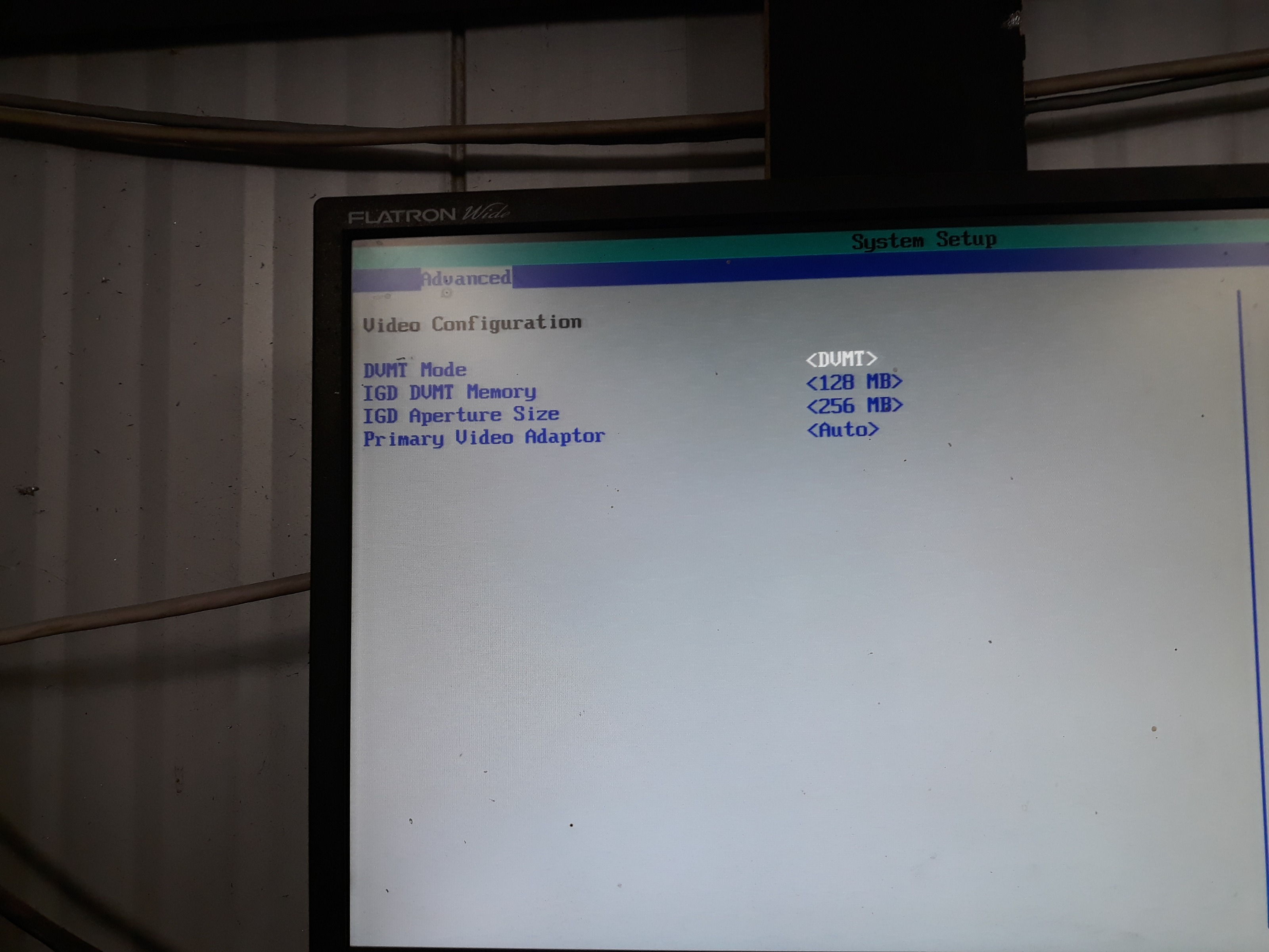

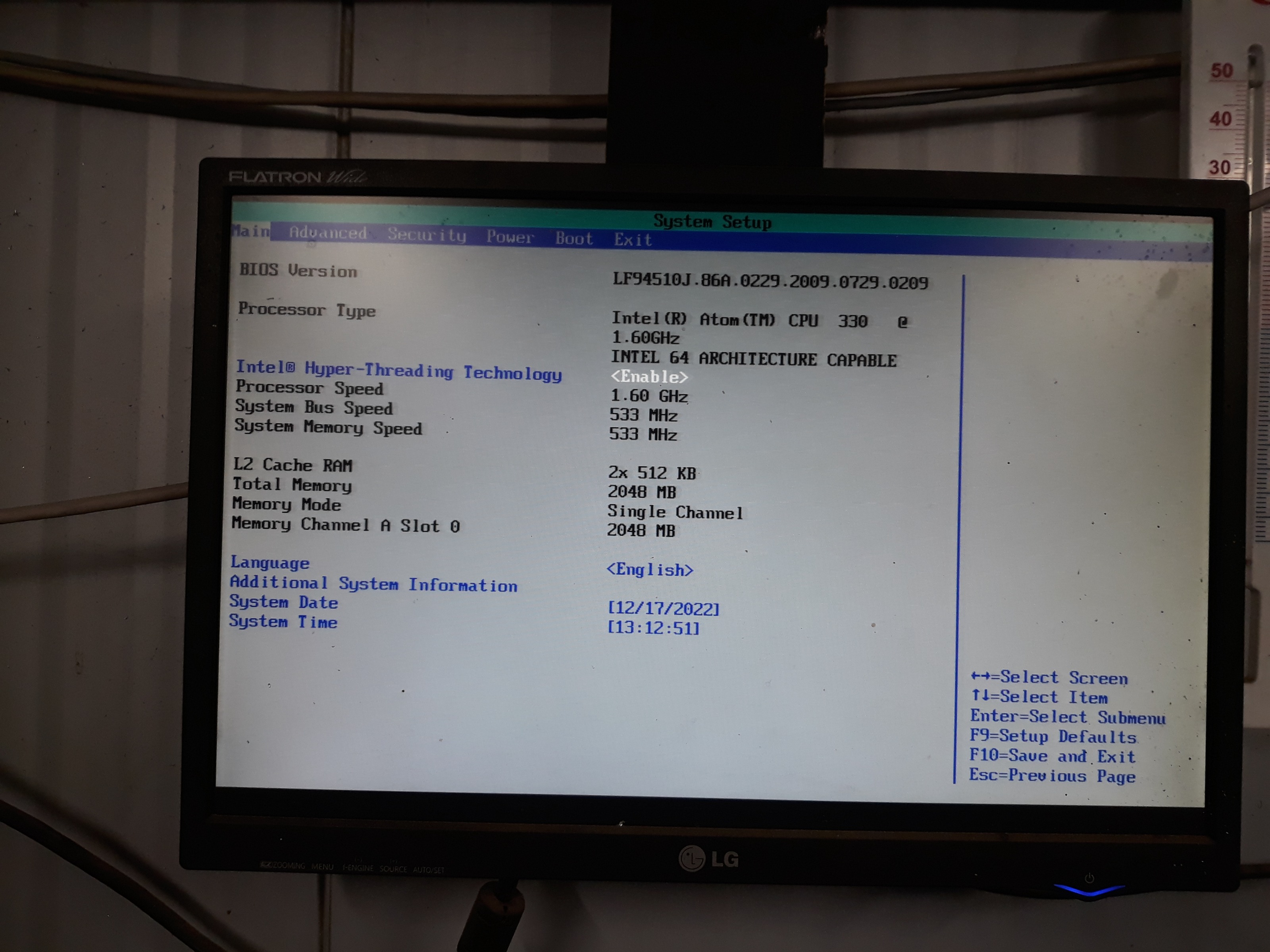

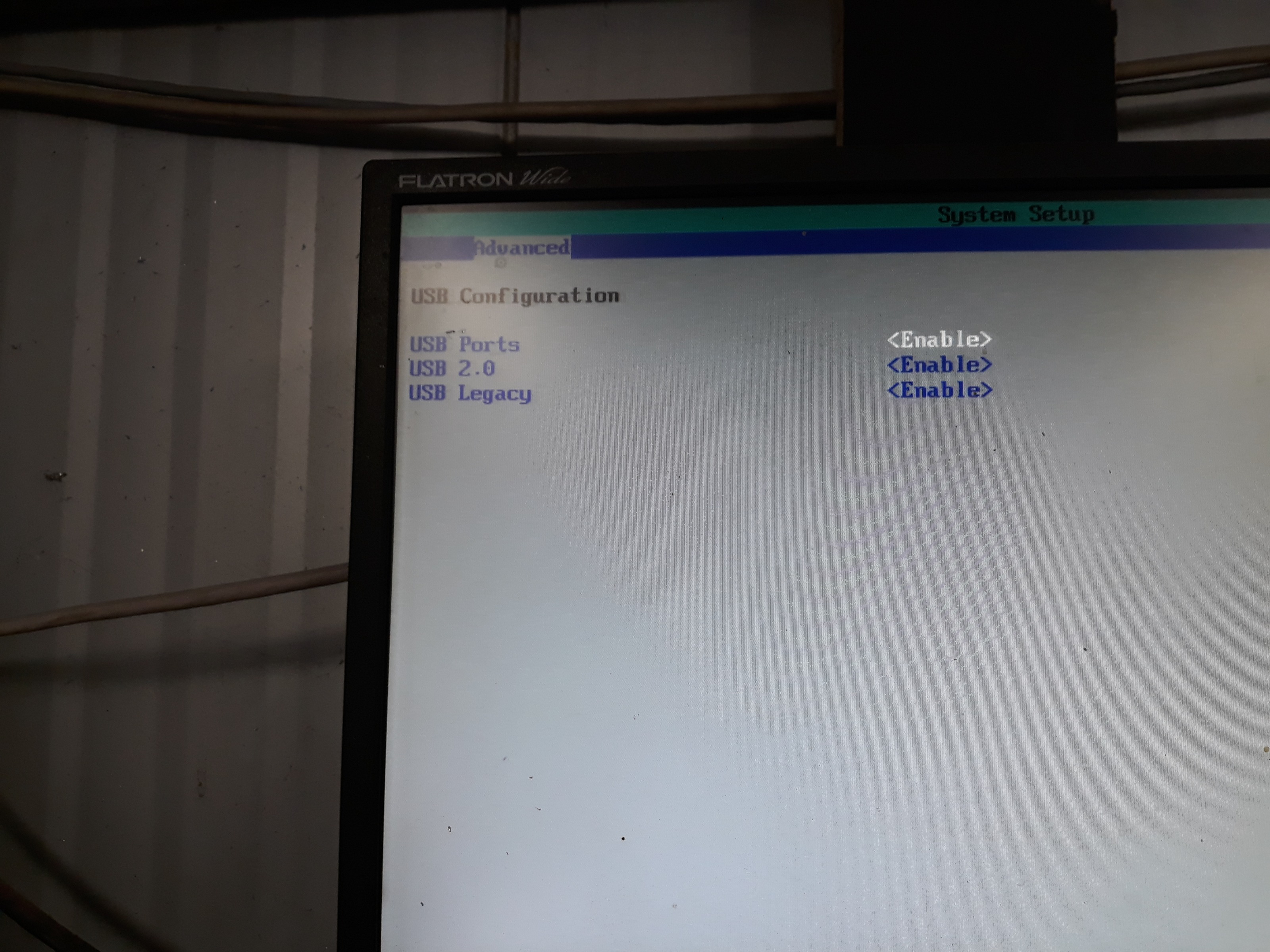

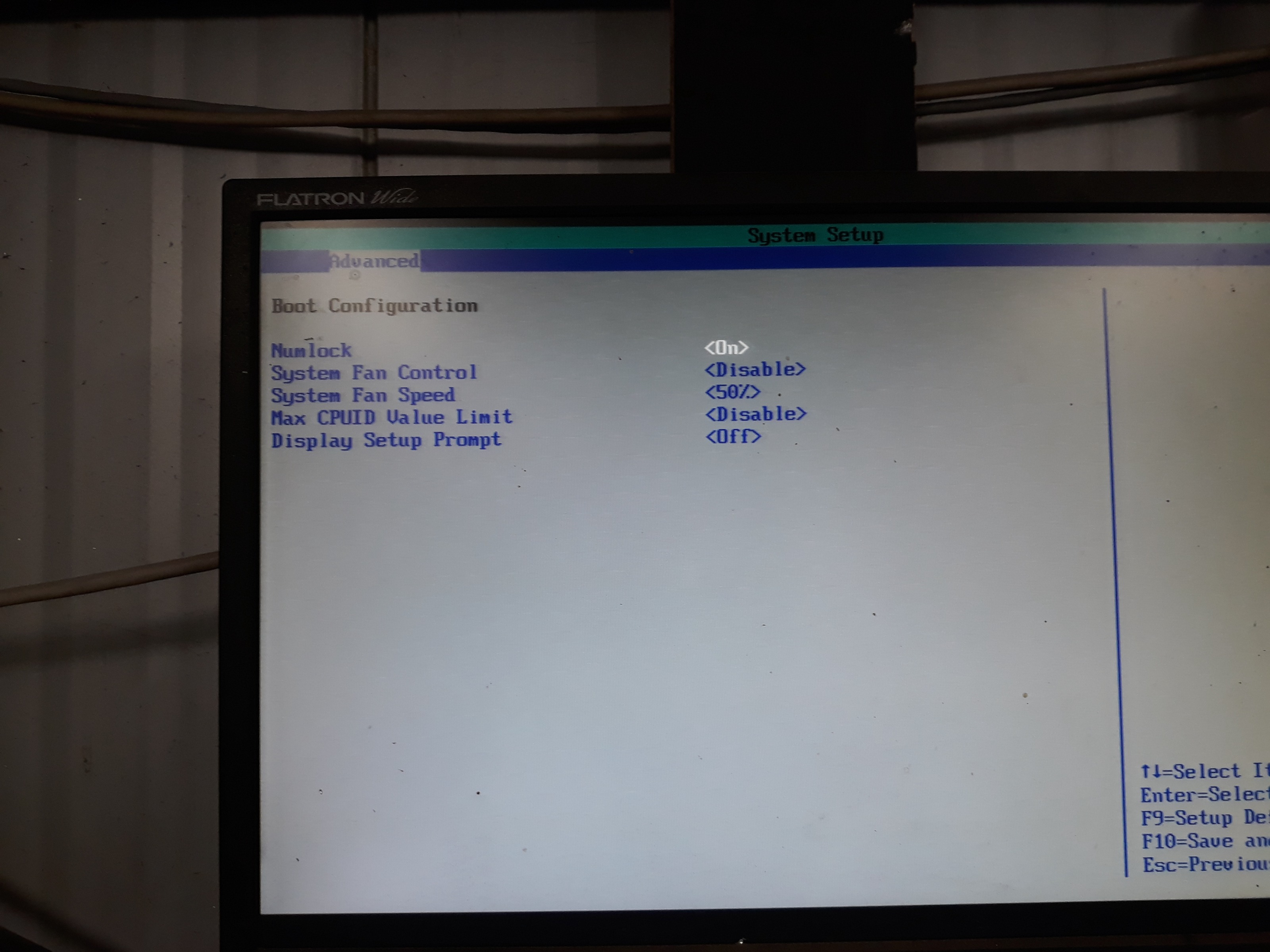

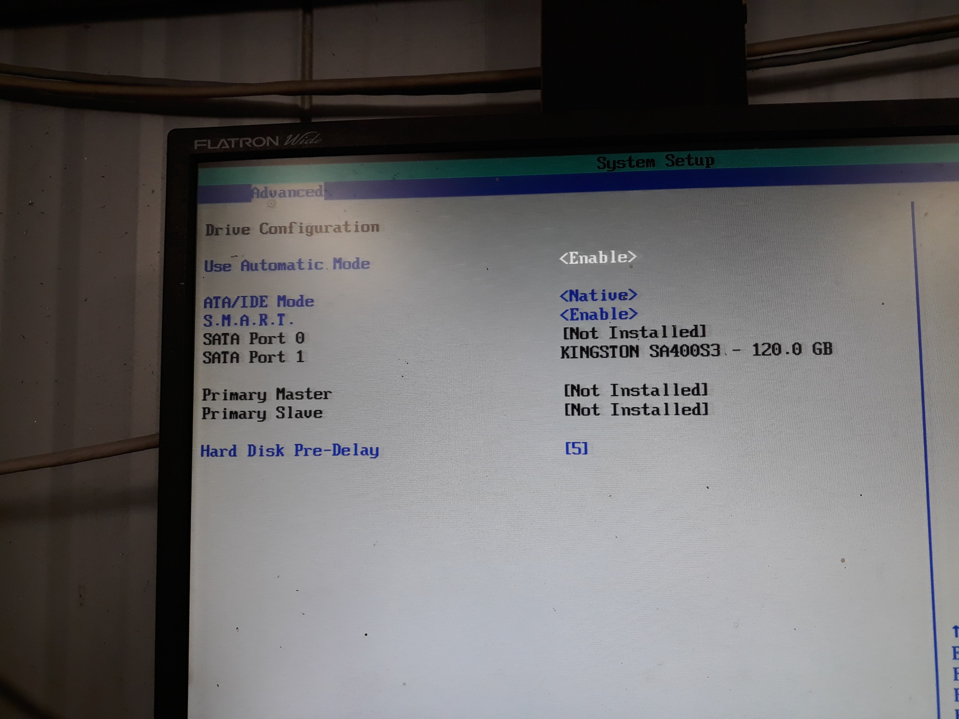

D945GCLF2D. On the same board (D945GCLF2D) as I mentioned, I have a working linuxcnc 2.7.14 lathe and after connecting this new disk there is this problem.

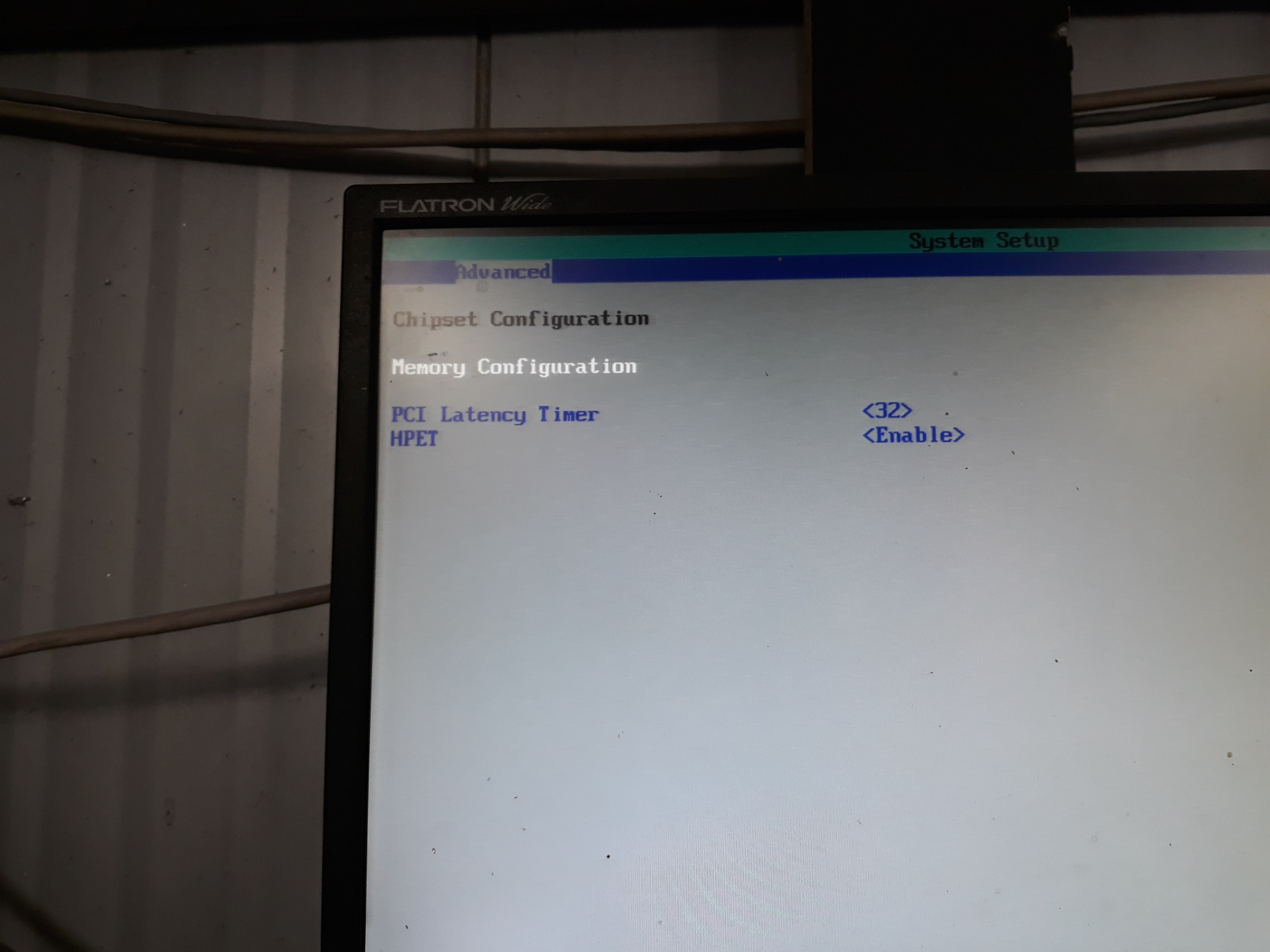

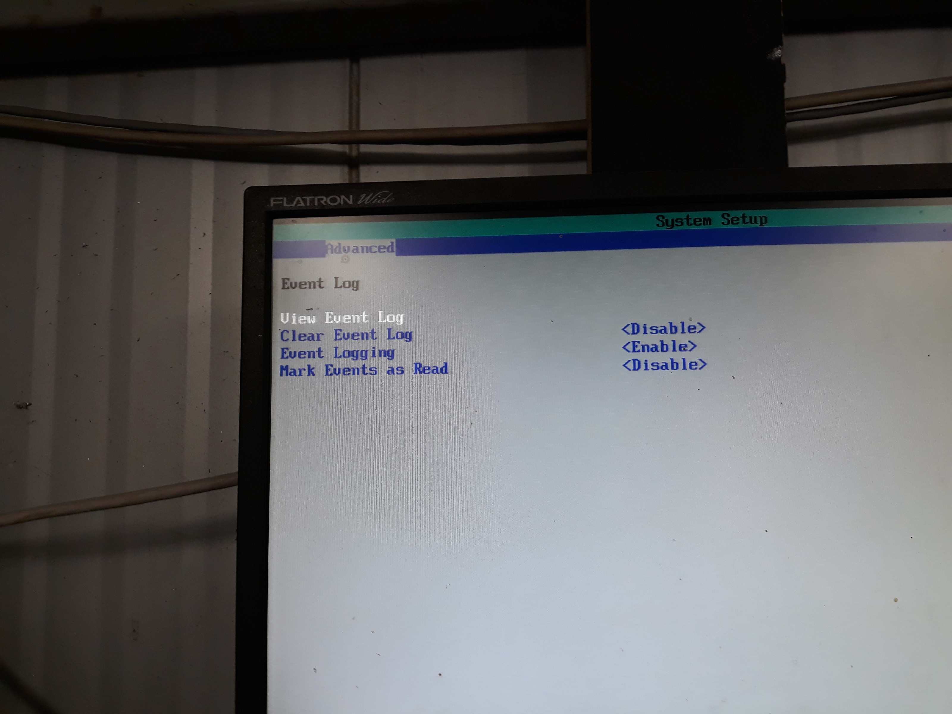

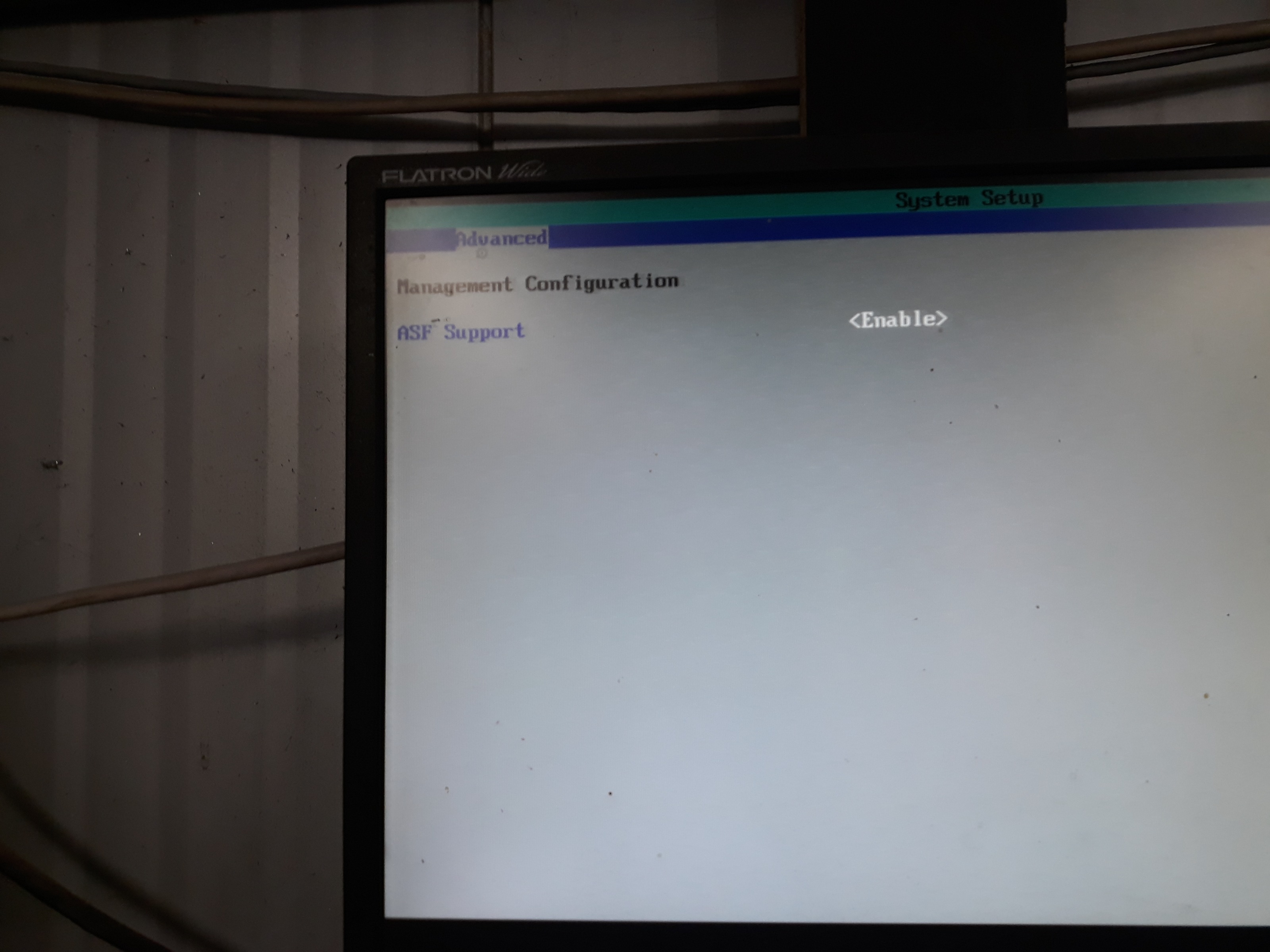

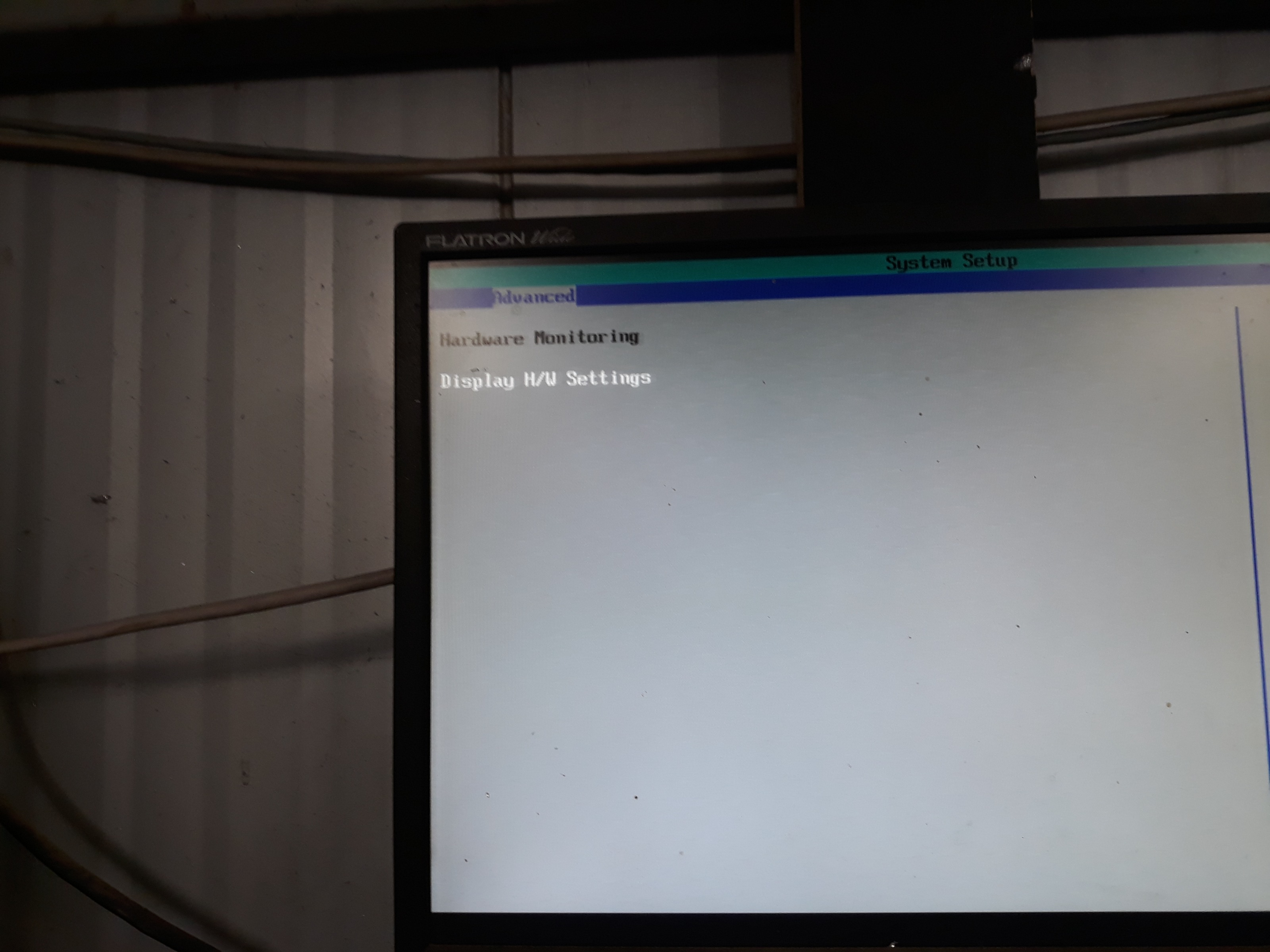

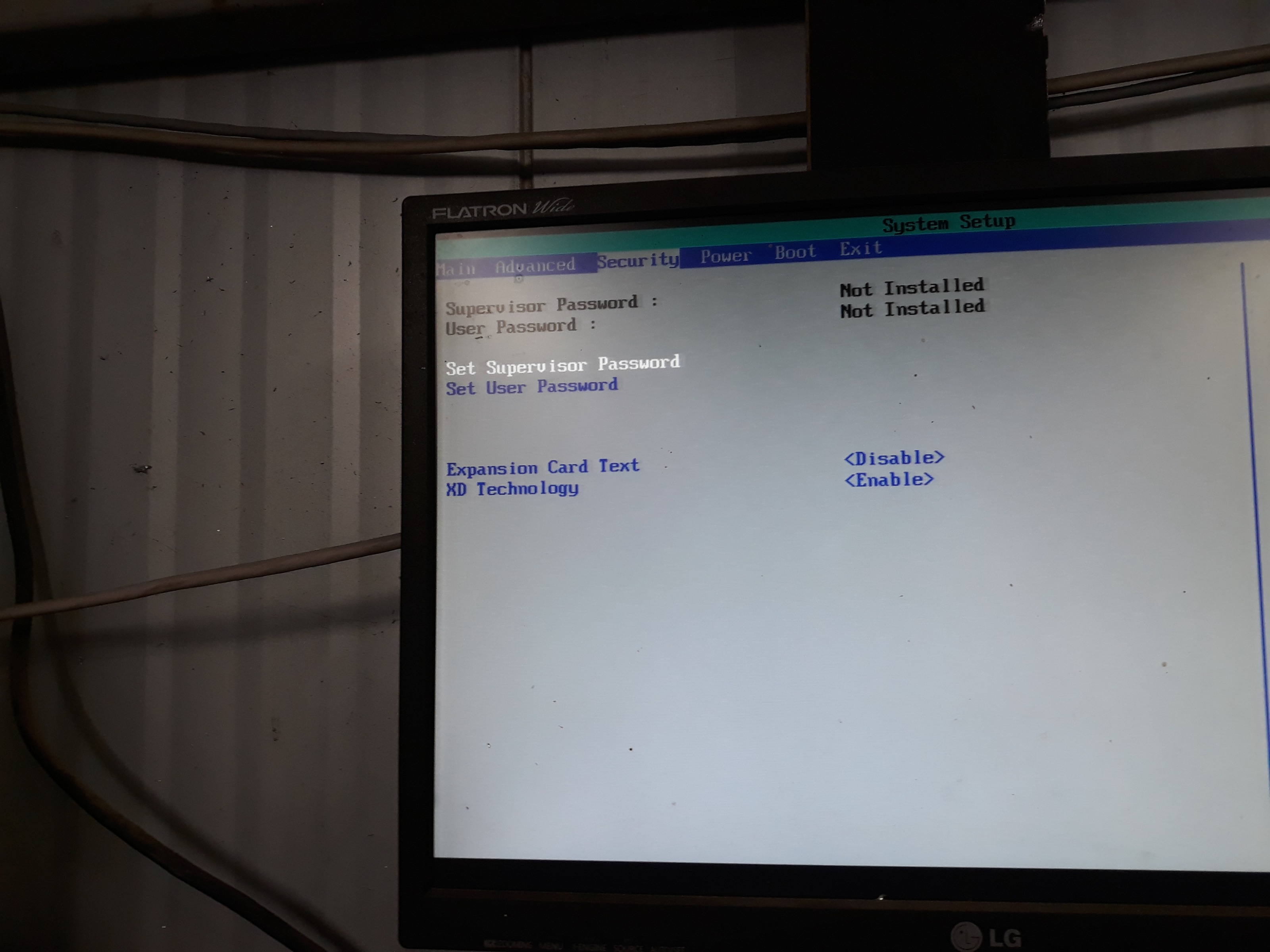

And I forgot when I have linuxcnc on and how to move the axes
the - or + button changes the position of the axis on the screen (the coordinates of the axis change) but as I wrote earlier, the motors of all axes are stopped.
I have attached pics of my bios settings
The new drive with which I have such problems is the SSD Patriot P210 128GB
The board to which I mounted the cloned (new) disk is
