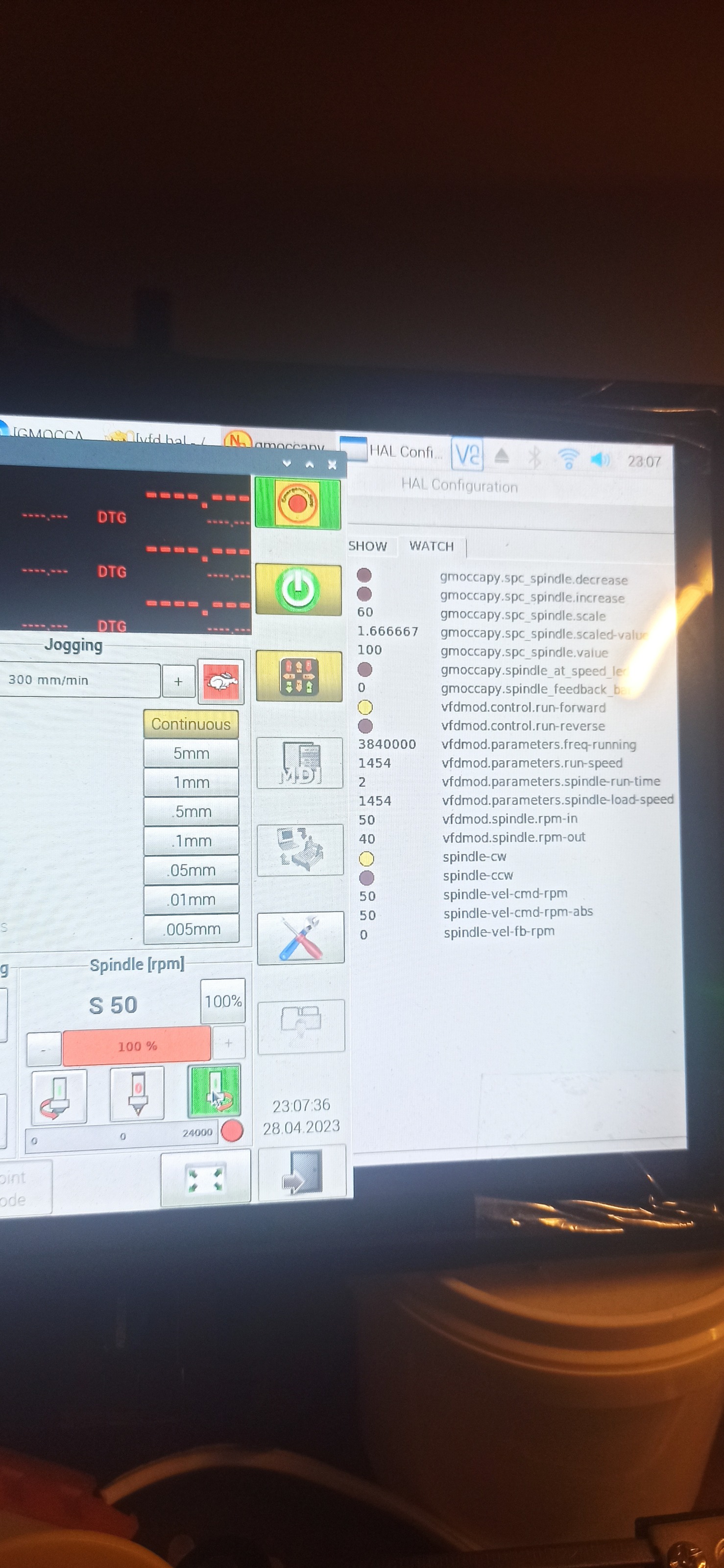

Hello again, I managed to get the right Frequency on the VFD by using this values
but I am having an issue with the displayed RPM, in the picture attached you can see that it shows s50 RPM but the spindle is currently at 24000 RPM, I have tried to take look at halshow but I was not able to figure it out, in the picture you can also see the values of some pins on the halshow, any suggestions would be greatly appreciated, thank you.

- Posts: 12138
- Thank you received: 4141
29 Apr 2023 08:10 #270171
Replied by rodw on topic GMOCCAPY spindle rpm issue
Part of the problem is tha linuxcnc expects the speed command in revs per sec and VFDMOD outputs RPM so you need to scale it.
Something like this.
You also need to set the vfdmod SpindleRpmOut to spindle.0.speed-in
You might need another scale component or alter your vfdmod.ini
# Spindle output speed
loadrt scale names=scale_to_rps
addf scale_to_rps servo-thread
setp scale_to_rps.gain 0.01666667
net spindle-rpm-out vfdmod.spindle.rpm-out => scale_to_rps.in
net spindle_rps_out scale_to_rps.out
net spindle_rps_out => spindle.0.speed-inYou also need to set the vfdmod SpindleRpmOut to spindle.0.speed-in
