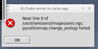

I used this article to set up my 10 pocket carousel tool changer:
forum.linuxcnc.org/10-advanced-configura...carousel-in-linuxcnc
I added the following to the ".ini" file:[RS274NGC]
REMAP= M6 modalgroup=6 prolog=change_prolog ngc=toolchange epilog=change_epilog
I have toolchange.ngc in the nc_files folder.
This error pops up when LinuxCNC is started:
Can someone tell me what I did wrong?
Thanks,
Mike

In your config file, do you have a 'python' sub-folder with
remap.py
toplevel.py
stdglue.py
in it?
As I am also finding out, remapping is non-trivial for beginners.

by mloser
Replied by mloser on topic Setting Up Carousel Tool Changer
That fixed it!
Thank you,
Mike

Just as beginner, where are these files available?
Replied by rajsekhar on topic Setting Up Carousel Tool Changer
remap.py
toplevel.py
stdglue.py
in it?

Depends on your installation, but should be something like this:
linuxcnc/configs/your-config-name/python/
and 'your-config-name' is the name of your configuration. Like 'axis' or 'my_cnc'
