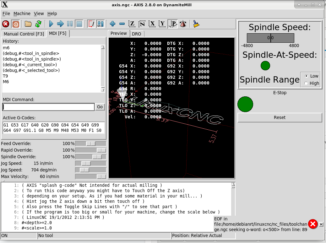

I followed the toolchange.ngc example as best I could. I have the errors all fixed as far as I can tell.I get the attached error message when I run the M6 command. I attached the .hal and .ini filesalong with the toolchange.ngc file. I have the PROGRAM_PREFIX and SUBROUTINE_PATH lines in the .ini file.

Seems like inside the above ngc file is a call for 0<500> that does not exist.Need the toolchange.ngc file too

o500 is at the top of toolchange.ngc;ARM_IN subroutine
o500 sub
M64 P0 ; Move arm in
G4 .25 ;wait
M65 P0 ;Remove "arm in" signal
M66 P0 L4 Q4 ; Wait for arm-in LS (low)
O501 if [#5399 LT 0]
(abort, failed to move arm in)
O501 endif
o500 endsub
o500 sub
G4 .25 ;wait
O501 endif
o500 endsub

Ok, hopefully someone else will come along and correct me as I'm a little hazy on O-words and subroutines.
I think what you want to do is put the subroutines at the end of the file, or rename them and save them as separate files.
Like so:
and in your subroutines folder you have files named:
arm_in
arm_out
unclamp
etc.
In my ATC sequence the functions you've got as subroutines have been remapped as M-codes. My version of your "O500" is "M25", and m25.ngc has been saved in my sub folder. My version of the sequence above would look like this:
Try sticking the subs at the end of the file first. If that doesn't help, try saving each sub function as a separate file.
Like so:
Code:
o<toolchange> sub
o200 IF [#<_selected_tool> GT 0]
o<arm_in> call ;Arm In
o<unclamp> call ; Unclamp
G53 G0 Z #2 'TODO Move Z to tool change clearance height
o<toolchange> endsub
arm_in
arm_out
unclamp
etc.
Code:
o<toolchange> sub
M25 ;Arm In
M24 ; Unclamp

And another thing...
The LCNC manual cautions against putting comments on the same line as O-words.
linuxcnc.org/docs/devel/html/gcode/o-code.html
You might try removing the comments in the main toolchange "oNNN call" lines first and see if that's the issue.
