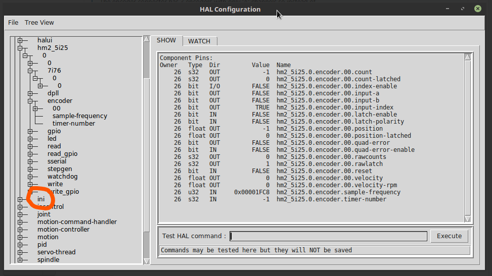

Hello,
you should combine:
INI HAL pin. Look in Halshow.
with:
M68
linuxcnc.org/docs/2.9/html/gcode/m-code.html#mcode:m68
In custom.hal you must connect it by net command.
Another combination is:
M64 / M65 and connect it throw own HAL component.
you should combine:
with:
M68

In custom_postgui.hal file add:
Start LinuxCNC and in MDI type:
Code:
# Change max velocity and acceleration from G-code
net sig-max-velocity <= motion.analog-out-00
net sig-max-acceleration <= motion.analog-out-01
net sig-max-velocity => ini.x.max_velocity
net sig-max-velocity => ini.y.max_velocity
net sig-max-velocity => ini.z.max_velocity
net sig-max-acceleration => ini.x.max_acceleration
net sig-max-acceleration => ini.y.max_acceleration
net sig-max-acceleration => ini.z.max_acceleration
Code:
M68 E0 Q10 (change velocity unit/s)
M68 E1 Q5 (change acceleration unit/s2)
