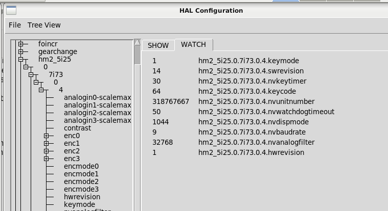

MPG jogging, input switches, outputs are all working but I can't get the 4x8 keypad working.
I jumper any scan line (key 4-7) to any of the 8 inputs (key 8-15) and the hal scancode is always 64.
I pasted a screen print of the hal configuration values that may be relevant. Anyone see what I am
doing wrong?
Thank you,
Mike

Forgot to mention jumpers:
W5 down
W6 up
W7 down
W5 down
W6 up
W7 down

You cannot reliably see the keycode with halshow as
active keycodes only last one servo thread cycle.
Normally keycodes are decoded with the matrix_kb component
