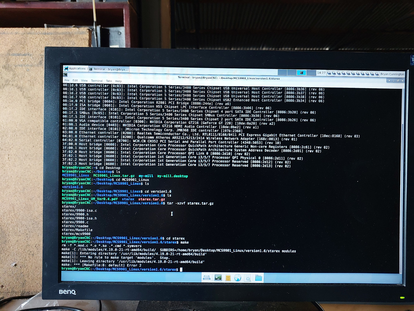

Just went and tried lspci -nn and the response can back with a serial parallel port PCI listing, now this PCI did come with a linux driver but it keeps falling down as shown in this picture. When I first tried it it fell down with no build folder in /dev so I did a mkdir and put a folder in and another link in /lib needed one too.
No it's saying "no rules to make target " and aborts with an error so would I need to do a shell script with make=1 and put it in lib/......./build/ fix the error.

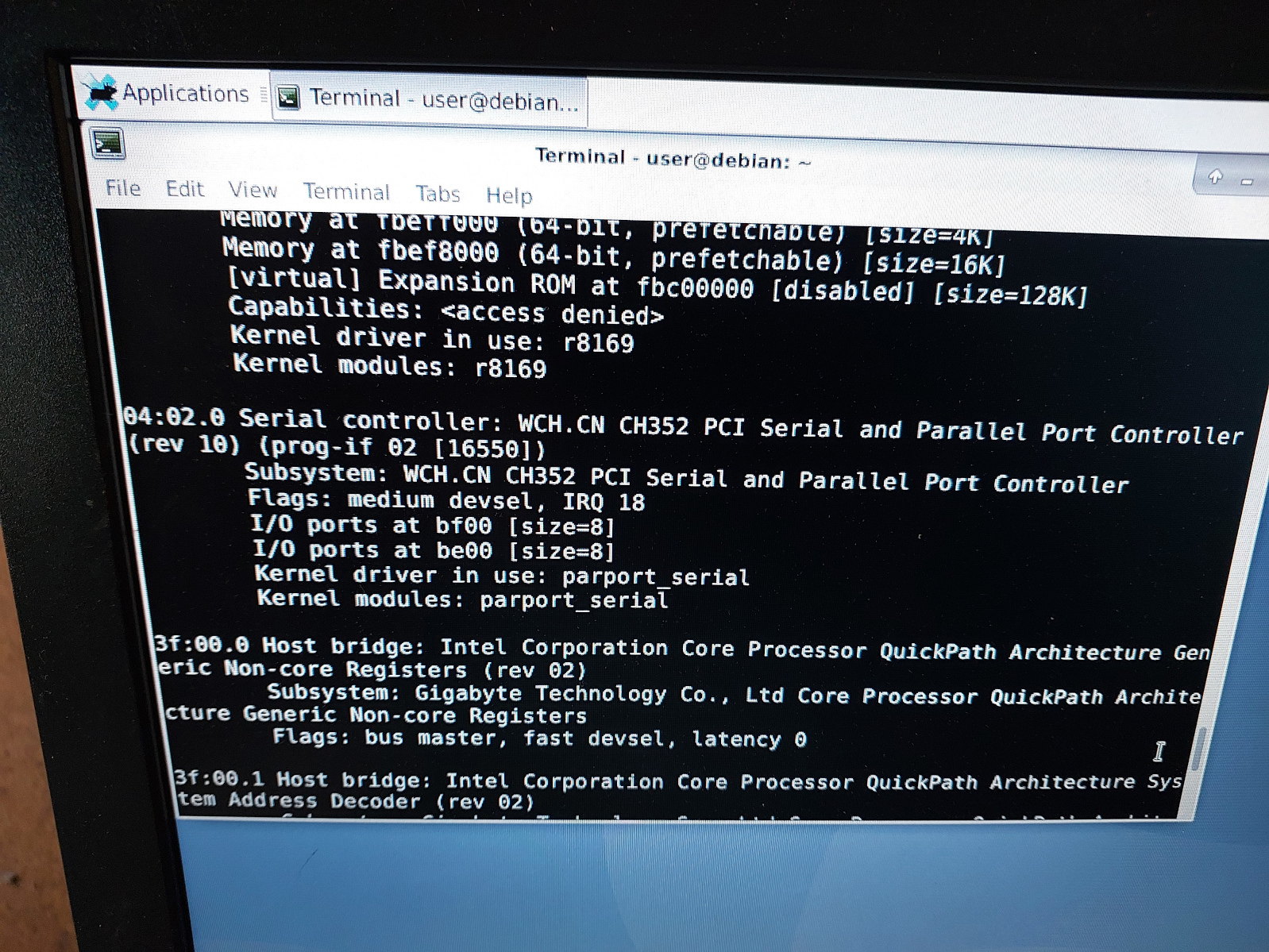

Well today I finally got the chance to run those 2 commands and with the lspic -v it does comeup with this card and says it's assigned to parport/serial
Now when I run that second command it comes back with
0000-0000 : parport
So looks like this Chinese clone is no good so back to hunting for a real parport card
0000-0000 : parport
