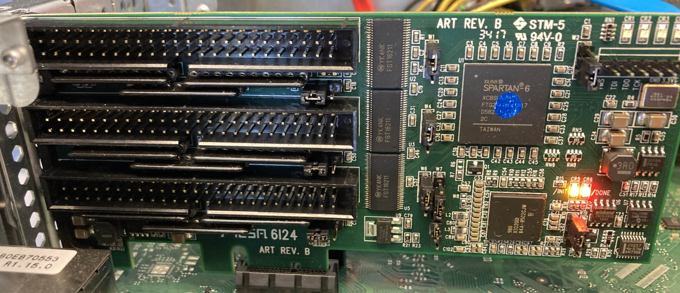

Hi guys,I have a question regarding the Mesa Anything i/o 6i24-25. I flashed the card with a .bit-file with mesaflash. By the way it was a .bit- file from hostmod2. The flash was successful. Now the yellow LED (/INIT) and the red LED (/DONE) is on permanently. Since then I can't find my card on the PCI bus. Has anyone had experience with this?

Thank you very much for your answer. I have flashed the bitfile "5i24_25_svss6_8.bit".
I also wanted to try the "--recover option", however I can't find my Mesa card on the PCI bus anymore.
Before flash, lspci gave me the following:
01:00.0 PCI bridge: Texas Instruments XIO2001 PCI Express-to-PCI Bridge
02:00.0 DPIO module: Device 2718:5124 (rev 01)
After flashing, lspci gave me the following output:
Even with mesaflash I can't find my card anymore.

The command "sudo mesaflash --device 6i24 --recover --write 5i24_25_justio.bit" gives me:
No 6I24 board found
No 6I24 board found

I've now tried various possibilities, but the board can no longer be found.
sudo mesaflash --device 5i24 --recover --write 5i24_25_justio.bit
-> No 5I24 board found
-> No 6I24 board found
sudo mesaflash --device 6i25 --recover --write 5i24_25_justio.bit
-> No 6I25 board found
Are there other possibilities to reset the board? Thanks for your help.

What Mesaflash version do you have?
Is the XIO2001 bridge still visible in lspci?
You might try updating to the latest and if that doesn't work, I will try and duplicate the issue here.

I have the version:
Mesaflash version 3.4.7
I mean this is already the latest version.
The XIO2001 bridge is still visible in lspci

Try mesaflash version 3.3.
I think the new name munging in 3.4+ broke the recover feature
I will fix 3.4, but its a bit tricky
