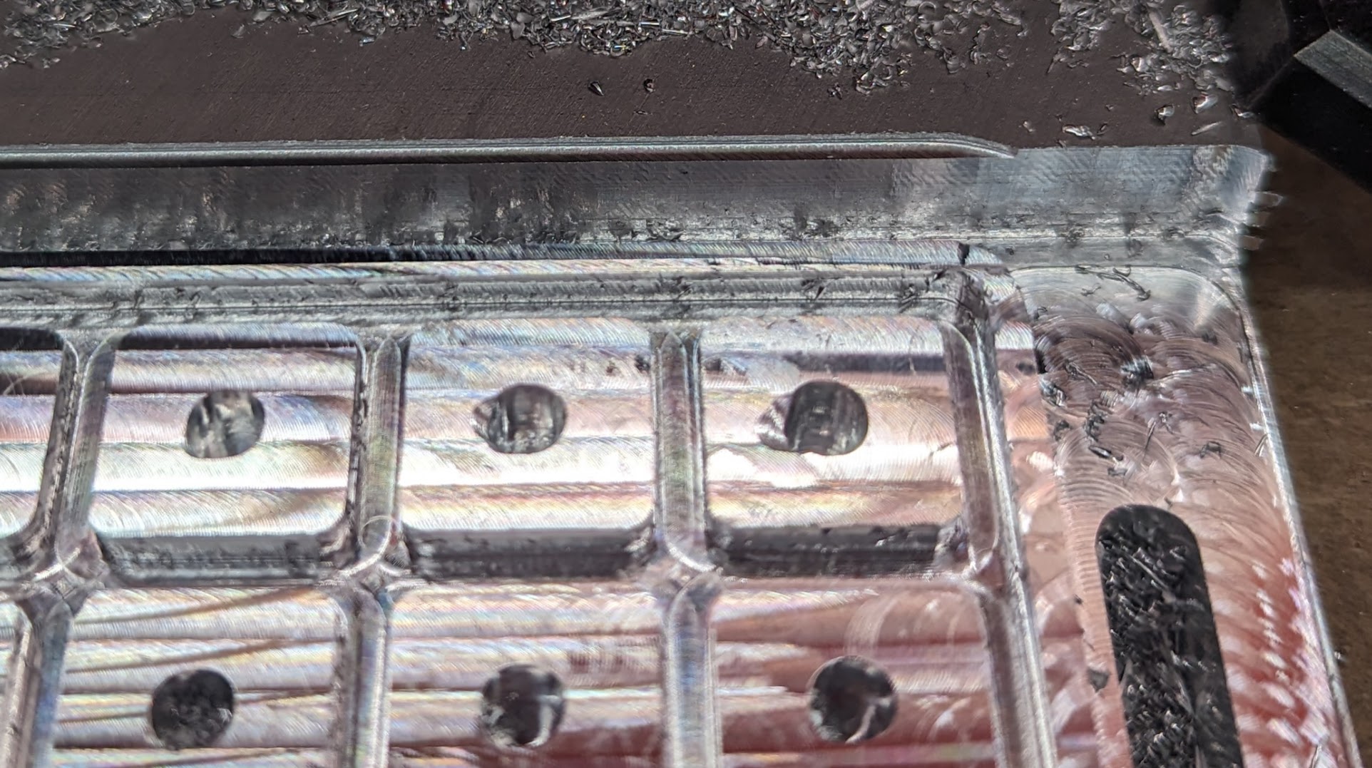

I randomly get situations where LinuxCNC is not following the gcode precisely, instead taking shortcuts. I have configured G64 as follows:
RS274NGC_STARTUP_CODE = G17 G21 G40 G49 G64 P0.001 G80 G90 G94 G97 G98
And
ARCDIVISION = 32
CYCLE_TIME = 150
The shortcut has a radius of approximately 1-2mm and is not in the gcode program. I double checked it by opening it in another CAM, where the path is shown correctly.
Any hints? The full machine config is here.

BEFORE configuring "G64 P0.001", I had the problem in the XY direction.
AFTER configuring "G64 P0.001", I have only now seen the problem again - but this time in the XZ direction: While moving up in Z out of a hole, X starts already moving.

Ok, that would be an "extreme" zero-tolerance measure and much slower.
But why does G64 P0.001 apparently not work here? Shouldn't that force the machine to stay within 0.001 machine units of the ideal path?

Can not find it, there was an issue where X or Y or both would move before Z reached the programed height, but it should already be fixed in 2.8.4
Can you start a sim config and run that same gcode, se if that happens in sim also?

You should try make bigger lenght of steps. Sometime cheap drivers use lowcost optocouplers and step signal is loosed.
Edit:
I looked at the picture again and realized that it probably wouldn't be the fault of losing a step.
You can try decrease:
FERROR = 10.0
MIN_FERROR = 1.0
This can help you test machine off.
Then you can try increase:
STEPGEN_MAXVEL = 250
STEPGEN_MAXACCEL = 1875
I use 100% larger.
Then you can try decrease P in PID.
PnConf use default value 1000.
Then you can try velocity mode.
control-type 1
Edit:
FERROR = 10.0
MIN_FERROR = 1.0
I use 100% larger.
control-type 1

Replied by PCW on topic Can't get LinuxCNC to stop taking "shortcuts"
Yes, I would lower the following error limits to see if its a setup error
in the hal or ini files causing a following error.
I would not use larger than say .02 mm for limits, and when properly setup
a 0.005 mm local feedback error should never happen.
