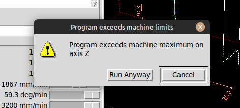

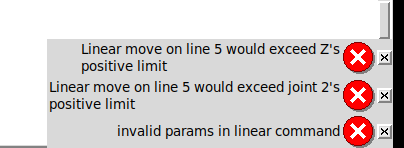

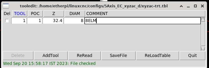

I am getting an error while trying to run my gcode where linuxcnc claims that the "gcode exceeds the machine maximum on Z-Axis". It mainly occurs when I give "Tool length Offset(TLO)" for my tool.
But when I run the Gcode ignoring the error it run absolutely fine and gives the output what I intended.
Now, I am confused regarding the TLO and how I should avoid the error above.
Hopefully someone can shed light and show me the proper way.
I have attached my INI and tool.tbl below.

Hi Aciera,
Thank You for the reply.
My error is actually the popup error which is shown in 1st picture in your post, thus I was able to run the program forcefully.
But is there anyway I can avoid this popup error?

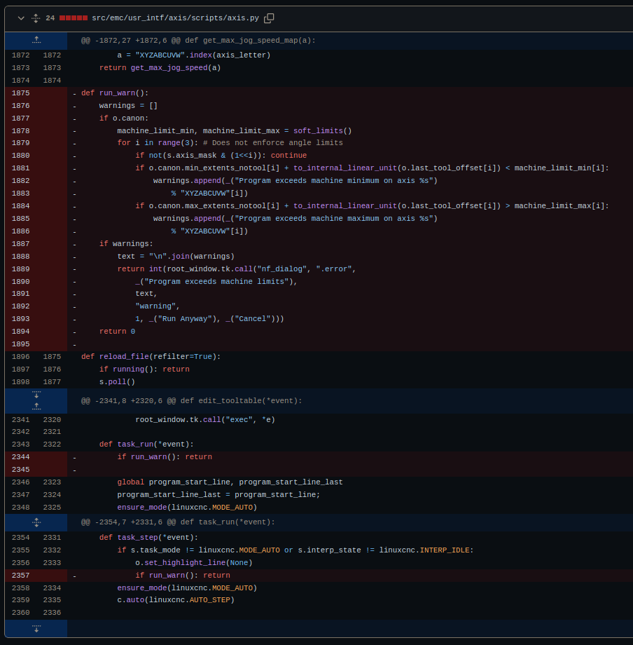

Well, you can if you feel comfortable editing 'axis.py', removing all the lines marked in red will remove the buggy limit check.
On a Rip installation (ie if you compiled linuxcnc on your computer) the file to change is:
<your linuxcnc installation folder>/bin/axis
On package installation:
I'm not sure, I'd have to check where that gets installed.

Thank you all for replies.
I am using RIP installed 2.9 version.
So I think I will try Aciera suggestion.
