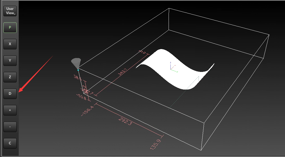

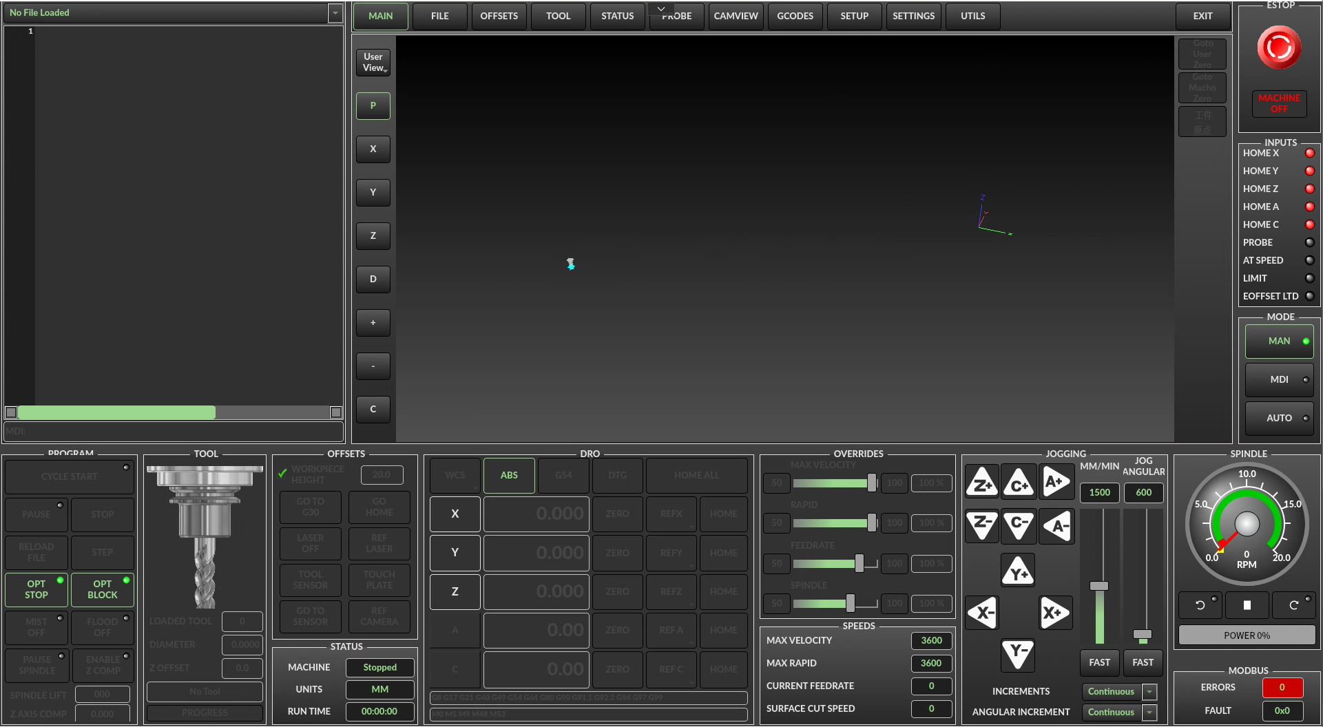

27 Sep 2023 09:40 #281721
by onceloved
After replacing the graphics card, AXIS, qtdragon, and GMOCCAPY cannot display t was created by onceloved

If using an integrated graphics card, the jitter is too high. The HD7540 graphics card is perfect except for the above issues
Rx580 is a mining card with too much noise

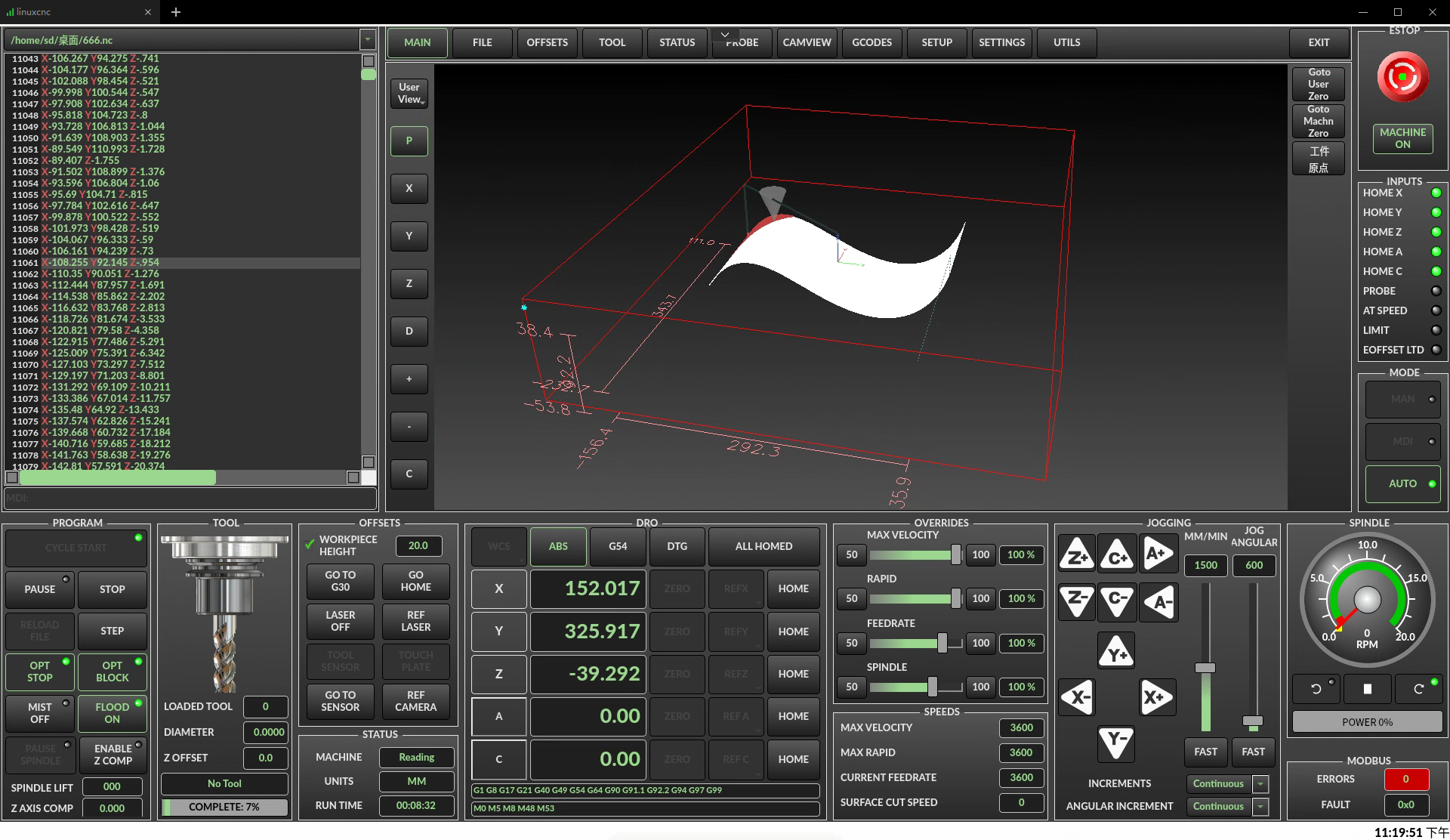

Is there another driver available for this card?
The limits use the GL_LINE_STIPPLE command and I do see google hits on it not always working on some cards. I have seen this on one machine myself.
Could also try to comment out the line in glcanon.py to confirm the problem(line 1304):
if self.get_show_limits():
glTranslatef(*[-x for x in self.to_internal_units(s.tool_offset)[:3]])
glLineWidth(1)
glColor3f(1.0,0.0,0.0)
glLineStipple(1, 0x1111)
#glEnable(GL_LINE_STIPPLE) <<<<<<
glBegin(GL_LINES)
glLineWidth(1)
glBegin(GL_LINES)

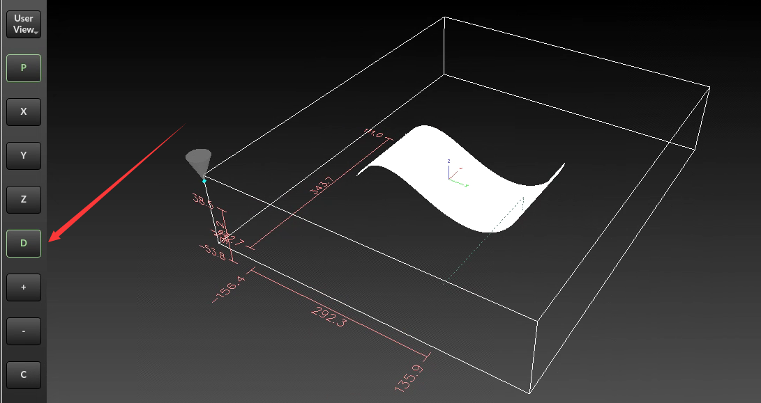

According to the method provided by the upstairs, the wireframe came out after commenting out line 1304 in the glcanon.py file. Although it is a solid line, it is better than nothing.
This HD7540 card can still be used, and the driver is Radeon.

Yes I tried it on my broken system and it worked too.
The brighter wire frame looked nice - maybe it get annoying after a while though?
