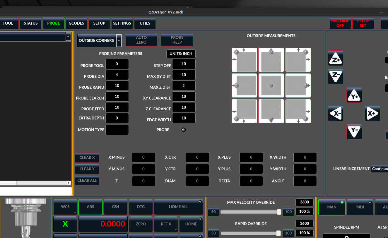

Hello all,
I have installed LinuxCNC 2.9 with Gmoccapy on a Debian 12.
Everything work fine but now I would like to use a 3D touch probe.
After a lot of search on why I could make it work, I stepped uppon a post here that stated a few month ago that probe screen is not compatible with LinuxCNC 2.9. And also, I cannot downgrade to 2.8 under Debian 12.. So I feel a bit stuck.
Is it still impossible to use probe screen with LinuxCNC 2.9 ? And if yes, what can I do to use a probe with 2.9 ?
Thank a lot for help.

Cool, I wasn't aware of this UI.
Is it compatible with 2.9 ? Any flaws compared to Axis or Gmoccapy ?

I personally haven't used it yet but it's well maintained. There are a number of simulation configurations that come with a 2.9 installation so you can have a look.
