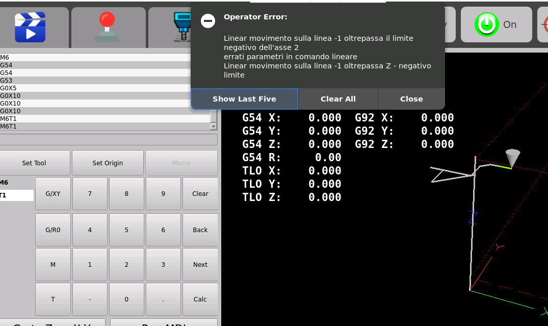

Hello,
I build my own hmi and generally it works. Now I have a basic issue but I'm not able to understand why:
Positions of X,Y,Z are 10,10,50 and limits for X is min=6 and max=57.
Offset tool I try to load is all zero
When I try to call M6 T1 I get error because the movement goes out of minimum limit for Z.
Can you tell me why?
In my opinion it makes no sense.
G54 offset are all zero..
Help Please.

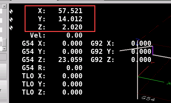

21 Oct 2023 16:47 #283447
by Guglielmi
Basically G53 values are shown in the picture right? They are inside the valide range
