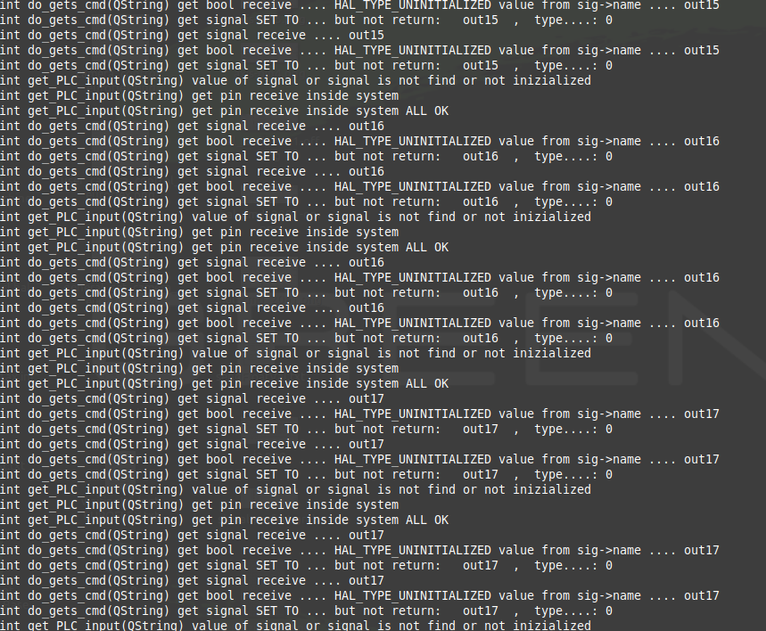

01 Nov 2023 09:18 - 02 Nov 2023 17:47 #284261
by bkt
for no waste time .... if you try to reach these goal (run your gui app c++ on rt-preempt) need to copy ACTUAL installation file hal_priv.h in your project code .... in these way you can align shmem data with request/command from your app c++.
When you update Lcnc version, need to change that file on your project folder .... (and add to your heather file)
THESE IS THE RIGHT SOLUTION FOR ALL THESE POST OPEN BY ME IN LAST 5 DAYS:
forum.linuxcnc.org/41-guis/50520-int-set...ot-writable-or-not-e
forum.linuxcnc.org/10-advanced-configura...le-for-kins?start=20 (only last part of problem encountered pg.3)
SO: in linux mint 19.3 kernel 4.19 rt3 can run Lcnc2.10 pre0, linuxcnc 2.9.1 whitout problem ( for version 2.10 you need some tricks to cheat the dependencies... for example not installing the docs, and installing and reinstalling the yapps2 package during the installation process of the 2 necessary .deb packages.... in addition you need to install libmodbus 3.1. 6 with make, in order to have a documentation package required by 2.10.... in fact in libmodbus5.so the specific documentation package does not exist.)
why my signal return as HAL_TYPE_UNINITIALIZED? .... from these call .... thse after upgrate to 2.9.1 trought .deb package.

- TheRoslyak
- Posts: 238
- Thank you received: 37
01 Nov 2023 11:58 #284267
by TheRoslyak
Replied by TheRoslyak on topic int do_gets_cmd(QString) get bool receive .... HAL_TYPE_UNINITIALIZED
What is halpr_find_sig_by_name?

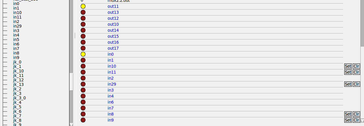

01 Nov 2023 15:26 - 01 Nov 2023 15:40 #284281
by bkt
Replied by bkt on topic int do_gets_cmd(QString) get bool receive .... HAL_TYPE_UNINITIALIZED
strct on hal_priv.h or hal.h ... not remeber exactly, for find signal struct data value by name ..... but same app, whitout modification, work on same pc (or same clone pc) from 4 years, now I need to use last kinematics features ... so upgrade my Lcnc .deb package istall ... and somethings is breack .... not understand where and why .... axis gui work on sim, and with lcec.so whithout problem .... my c++ app gui stop at these point because find signal "UNINIZIALIZED" (my app is a sort of halview or halshow new features on axis gui ... perhaps connect to opcua server or slave build on qt .... nothing to do with your project opcua .... real better and clean).
My app read and write, bit, s32, u32 and float into hal pin or signal, so you can easily have a all you need for make every gui type .... these is enought .... actuallly drive more or less 200 pin or signal with 50ms refresh rate .... qtimer new feature helps a lot beacause qt convert every void call from timer in a sort of qthread .... so no freezing or blocking and less use of memory and less coding.
not in my github .... but can post willingly a sample complete code project .

01 Nov 2023 16:48 #284286
by TheRoslyak
try this
int do_gets_cmd(QString nameSig) {
hal_sig_t *sig;
hal_type_t type;
void *d_ptr;
static char buf[18];
int valBIT = 10; // Default error value if signal not found or uninitialized
std::string value_str;
// Convert QString to C-style string
QByteArray nameByteArray = nameSig.toLocal8Bit();
const char *name = nameByteArray.data();
qDebug() << Q_FUNC_INFO << "get signal receive ...." << name;
// Get mutex before accessing shared data
rtapi_mutex_get(&(hal_data->mutex));
// Search signal list for name
sig = halpr_find_sig_by_name(name);
if (sig == NULL) {
rtapi_mutex_give(&(hal_data->mutex));
qDebug() << Q_FUNC_INFO << "get signal not find ...." << name;
return valBIT; // Signal not found
type = sig->type;
d_ptr = SHMPTR(sig->data_ptr);
// Process signal based on type
switch (type) {
case HAL_BIT:
valBIT = (*((hal_bit_t *)d_ptr) != 0);
break;
case HAL_FLOAT:
snprintf(buf, sizeof(buf), "%.7g", *((hal_float_t *)d_ptr));
value_str = buf;
qDebug() << Q_FUNC_INFO << "get float value ...." << value_str.c_str();
break;
case HAL_S32:
snprintf(buf, sizeof(buf), "%ld", (long)*((hal_s32_t *)d_ptr));
value_str = buf;
qDebug() << Q_FUNC_INFO << "get s32 value ...." << value_str.c_str();
break;
case HAL_U32:
snprintf(buf, sizeof(buf), "%lu", (unsigned long)*((hal_u32_t *)d_ptr));
value_str = buf;
qDebug() << Q_FUNC_INFO << "get u32 value ...." << value_str.c_str();
break;
case HAL_PORT:
// Handle port type if necessary
qDebug() << Q_FUNC_INFO << "get port value ....";
break;
case HAL_TYPE_UNINITIALIZED:
qDebug() << Q_FUNC_INFO << "signal type uninitialized";
break;
case HAL_TYPE_UNSPECIFIED:
// Handle unspecified type if necessary
qDebug() << Q_FUNC_INFO << "signal type unspecified";
break;
default:
// Unexpected type
qDebug() << Q_FUNC_INFO << "no valid HAL_TYPE for signal:" << name;
value_str = "unknown_type";
break;
// Release mutex
qDebug() << Q_FUNC_INFO << "signal value set to:" << valBIT;
return valBIT; // Return the value of valBIT, default is 10 if uninitialized

problem is all 200 signal result uninizialized .... before now code work perfect for 4 years ..... yea is not a good code .... but was working.

02 Nov 2023 04:49 #284309
by bkt
yes I'm not a software eng. .... so is difficult for me write a good clean code .... plus have few time for my learning about classes of lcnc .... for now addhal_sig_t *sig = nullptr;to your, because warning .... any how your code freeze my gui .... mine show only UNINITIALIZED ...Actually I add mode "debug" row for understand better origin of problem, and I reduce number of request to 16 .... only 8 ethercat IN and 8 ethercat OUT ..... so can see these output (all value = 0 when someone are flashing actually in EL2008 and some In on EL1008 are at ON ) .... see my axis signal working:
see my gui ethercat on QProcess request working (you see only actual value .... but are QProcess that call "ethercat upload ......"):
and see do_gets_cmd debug messages result:So think some library are bad linked .... more than pure code error ....
