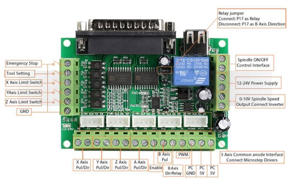

Hello everyone, I own the SPINDELMOTOR ISA 900 W 477009 33245 (
www.isel.com/en/spindle-motor-isa-900.html
) along with its FREQUENCY CONVERTERS (
www.isel.com/en/frequency-converter.html
). I'm interested in controlling it using LinuxCNC. I possess two boards of a 5 Axis CNC Breakout Board with Optical Coupler for Stepper Motor Driver MACH3 (
www.aliexpress.com/item/32796933346.html
). My query is whether it is possible to control the spindle motor speed to achieve a precise number of revolutions and, if so, how can I achieve this? Thank you.

Thank you for your response, but I'm having difficulty understanding how to connect the inputs and outputs of the encoder to this board. Perhaps this is the key to achieving greater precision in obtaining feedback from the encoder and controlling its speed by sending a signal to the frequency converter. However, I'm unsure of the specific steps. Do you have any suggestions or ideas on how to proceed?

I don't think you need to know the exact speed of the spindle.
This driver is unknown to me. If there is vector control you should be able to connect the encoder to the driver.
The parallel port comes with many limitations.
If you want greater stability and capabilities of the controller, consider changing the controller. Did you see the Mesa boards

Using a parallel port does limit encoder readings a lot, using cheap Mach3 BOB's limits that even further.
Not sure but it just might be possible to have good speed control with just one input using a simple sensor to just count once or twice per revolution, but this will not do for rigid tapping.
Replied by tommylight on topic how to control the SPINDELMOTOR ISA 900 W 477009 with Linuxcnc
Yes, LinuxCNC can do very precise spindle control, but you will need a Mesa card for that with an A/B/Z encoder as that makes it possible to do synchronized motion and rigid tapping.My query is whether it is possible to control the spindle motor speed to achieve a precise number of revolutions and, if so, how can I achieve this? Thank you.
Any input will do just fine, there are 5 on a parallel port set at "Mode out", that is the usual mode.but I'm having difficulty understanding how to connect the inputs and outputs of the encoder to this board.

Yes, I have come across the Mesa card, and I am considering working with it, particularly the 7I76. However, in this scenario, do I still require the frequency converter, or can I continue to use it since I already have it? If the latter is possible, how can I connect both the frequency converter and the motor to the Mesa card?
