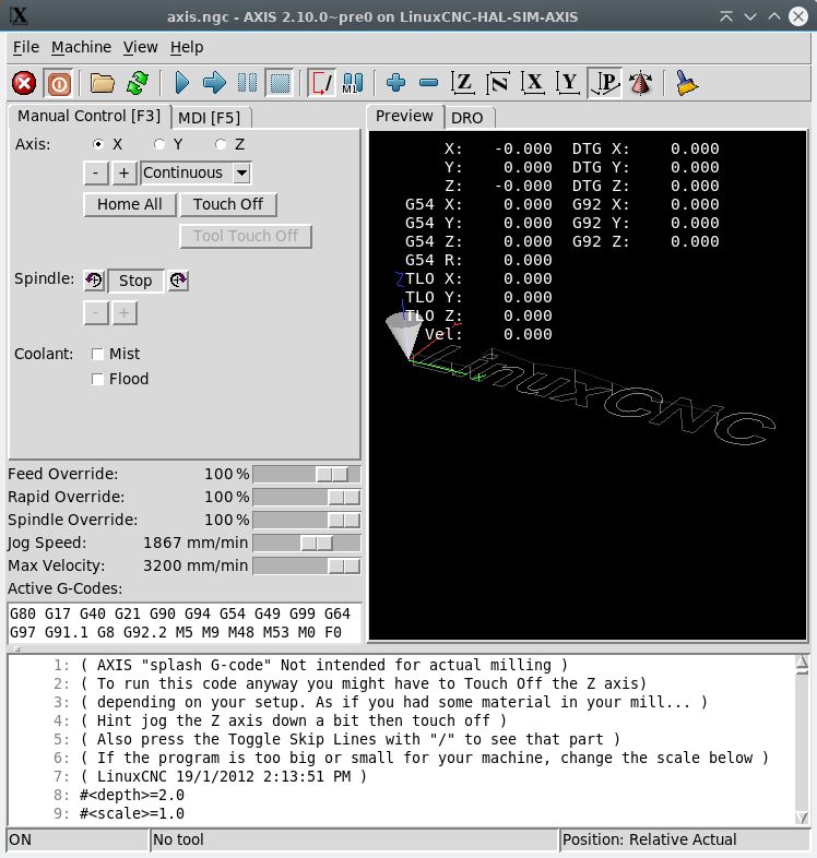

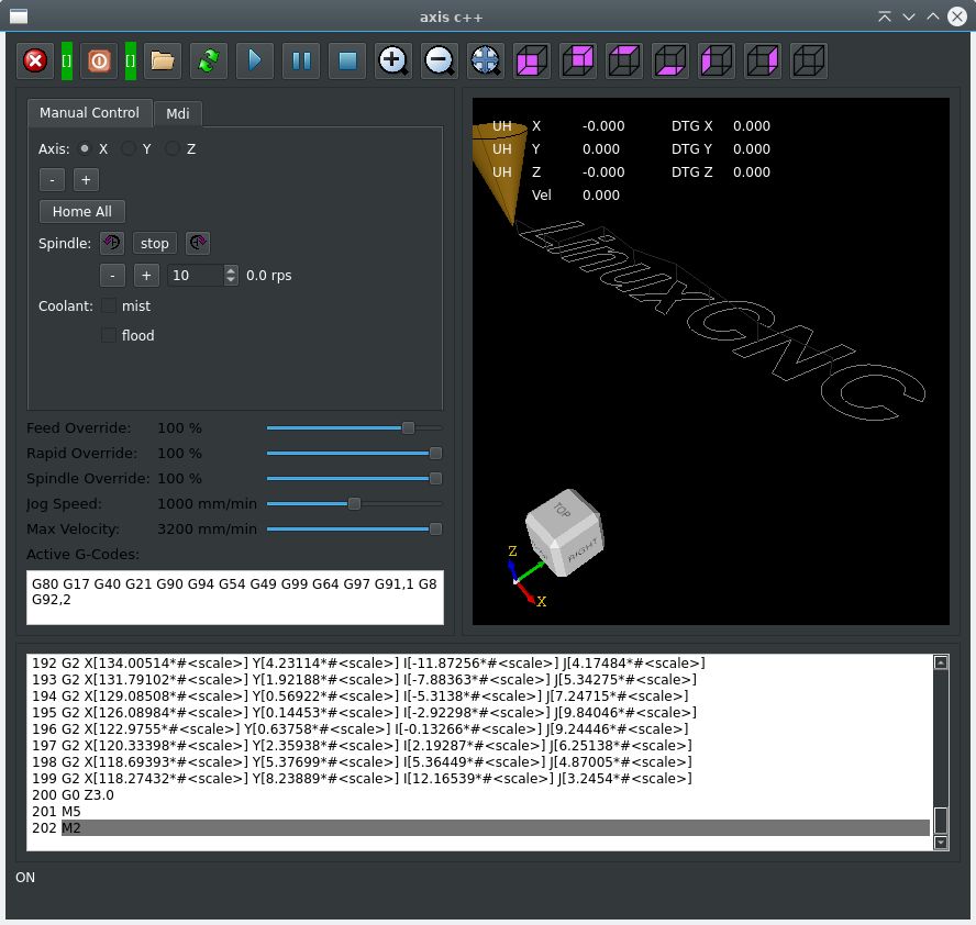

I made a c++ lcnc controller, that looks a bit like the original axis gui.
This gui is more reactive then any Python coded program interface can be.
Users now can easely modify this gui into any exotic machine program using c++ and
a editor like qt.
It uses a method like the lcnc sai interpreter to load cad data.
It uses the lcnc nml interface.
Original lcnc axis gui:
lcnc axis c++ gui:

How does the code make preview backplot (3d line segments from gcode) ??
Is there way to reduce resolution so there are fewer line segments in view (reduce memory used)
I cannot see how gcode preview is made in initialize there seems nothing but toolcone/axes/etc..
github.com/grotius-cnc/linuxcnc/blob/mas...opencascade.cpp#L262
How is gcode backplot made and setup?
I think I see in github.com/grotius-cnc/linuxcnc/blob/191.../mainwindow.cpp#L162
it gets data from runInterpreter() and then loops for(uint i=0; i<cadvec.size(); i++) so maybe if I change i++ to i=i+line_reduction it could reduce memory usage?
Yes i can code that. But why do you need it?
Its uses the lcnc interpreter to read a gcode file, this spits out gcode data. Then we catch this data and
drop it into opencascade cad viewer. But you can also drop it in opengl, if you have some coded.
This can also show your machine body if coded.
I will give it a try later but if you have any more usefiul comment to help before I try please comment.
Just try to run it, cq1, step by step.
