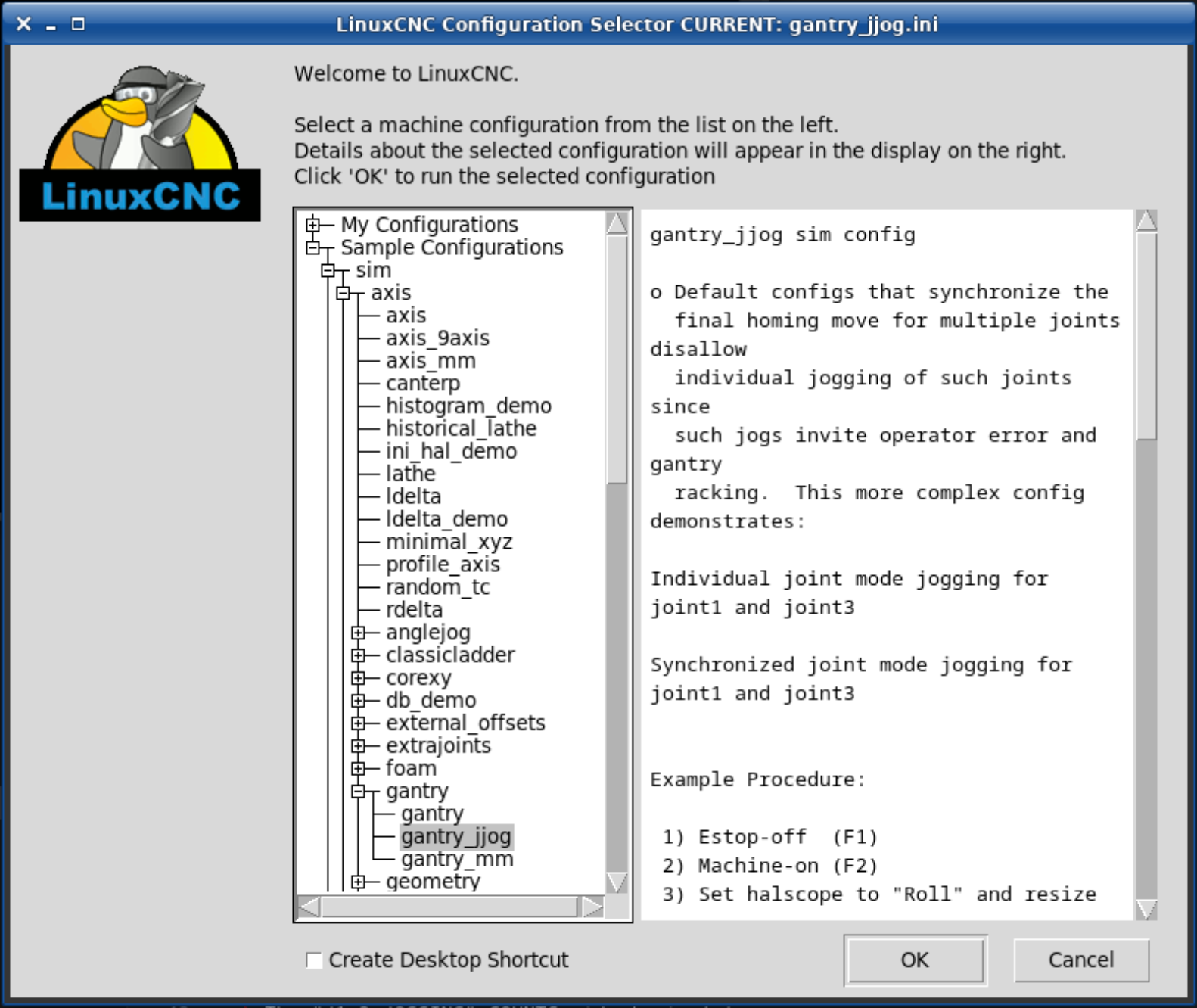

You won't be able to use the existing GUI buttons for synchronous unhomed jogging unless you rewrite/hijack some of the GUI code.
It is best done with an MPG, as all jogging really is.
You could probably add a button in a panel to jog the two joints, the simulation axis/gantry/gantry_jjog would be a good starting point.
Edit: What GUI are you using?

I am using the AXIS gui. I looked at this gantry_jjog. I only found that in the documentation of LinuxCNC 2.5. I am using the trivkins. I looked in the manpage and found that I had to add kinstype=b to the Ini file. Now I can switch with the $ shortcut between XYZ axis jogging and joggining for the individual joints. A step ahead!
This is a step in the right direction. I tried to find the signals which I need to connect now in joint mode to move joint 1 and 2 at the same time. I guess it must be something with Joing count and joint scale. I searched for all, but can not find anything which changes when I use the regular axis +/- buttons.
