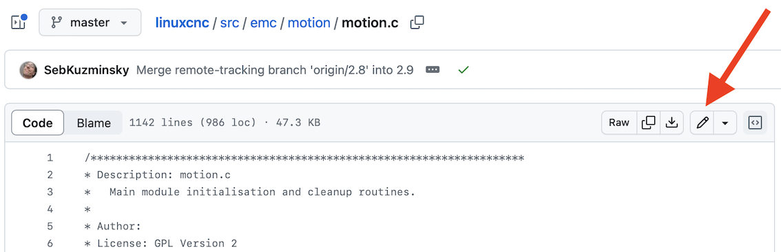

Hello, i believe I’ve discovered a typo within motion.c of the source code.
Line# 348-350:
Motion has the ability to define miscellaneous error pins. You can define a number of pins to be created, or you can define them by name. When defining them by name, the source code attempts to determine the number of inputs you’ve created by looking at the number of "names" in the array, but instead of checking the correct array "names_misc_error", it checks another array "names_dout".
It seems like a copy/paste typo where the variables, in this case the arrays, were not updated.
Link to motion.c: github.com/LinuxCNC/linuxcnc/blob/master.../emc/motion/motion.c
Line# 348-350:
else if(names_misc_errors[0]){
num_misc_error = count_names(names_dout);
num_misc_error = (num_misc_error > count_names(names_din)) ? num_misc_error : count_names(names_din);
}Motion has the ability to define miscellaneous error pins. You can define a number of pins to be created, or you can define them by name. When defining them by name, the source code attempts to determine the number of inputs you’ve created by looking at the number of "names" in the array, but instead of checking the correct array "names_misc_error", it checks another array "names_dout".

I posted it as an issue on GitHub, I could fix it, I think, but I don’t know how to GitHub works, with pulls and commits and such.
Seems like a fairly straight forward fix.

11 Dec 2023 04:16 #287813
by phillc54
Replied by phillc54 on topic Typo in source code file, motion.c
- TurboStreetCar
- Posts: 40
11 Dec 2023 12:53 #287850
by TurboStreetCar
Replied by TurboStreetCar on topic Typo in source code file, motion.c
@spumco yea i was going to try to use it for some other fault conditions and realized if i used num_misc_error, it would create the pins, but if i used names_misc_errors, it wouldnt create any pins.
@phillc54 When i click that button on github, it says i need to create a fork in order to propose changes. Is that correct?

This issue was addressed by Andy Pugh and should be fixed.
