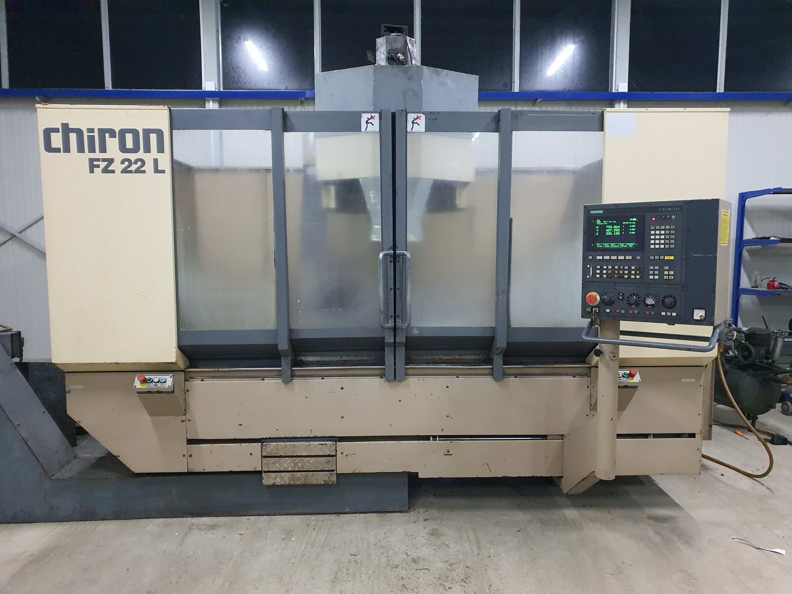

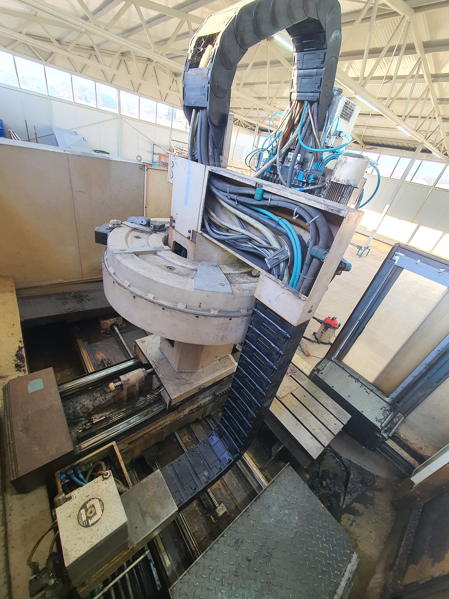

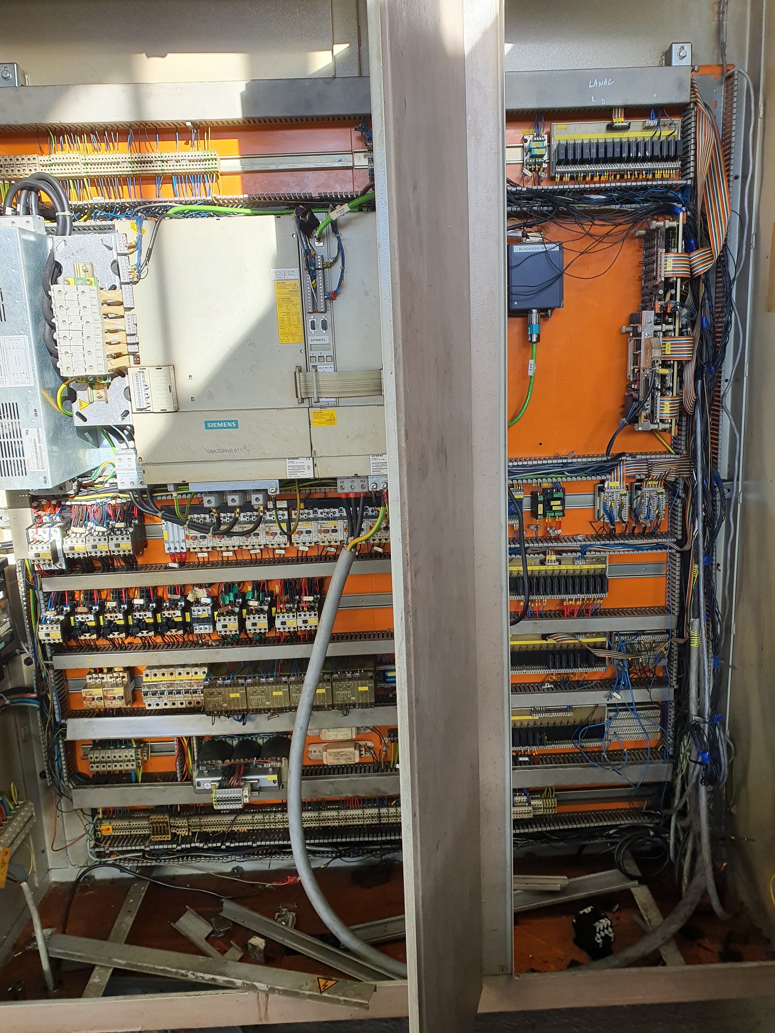

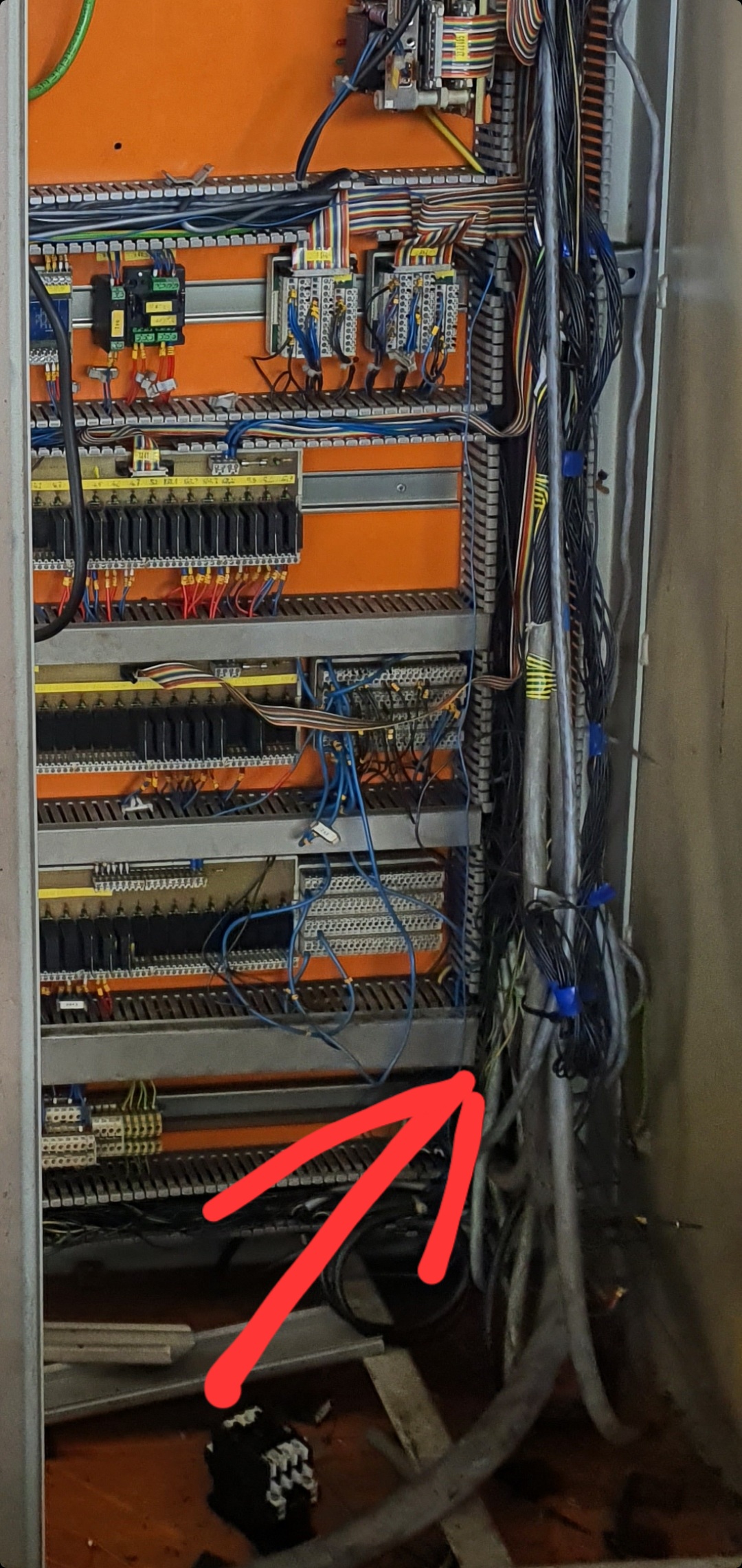

Hello everyone,I have a CHIRON FZ 22L it has sinumerik 810M controll on it, the machine is unreliable and the wireing of the digital inputs/outputs is done bad, and the automatic tool change is not working, I would like to rewire the inputs/outputs and put Mesa boards on it, the drivers motors and spindle are good I would keep them, it has SIMODRIVE 611, I thought of using 7i92TH 7i77 7i74 7i71 7i71 7i70 7i70 7i70 can I connect 3x 7i70 and 2x 7i71 on 7i74?The machine orginally has 136 inputs and 64 outputs,
Any suggestions?
See pictures below
Thanks for info
Dominik
Any suggestions?
See pictures below
Thanks for info
Dominik
- Posts: 21901
- Thank you received: 7465
14 Jan 2024 18:33 #290685
Replied by tommylight on topic CHIRON FZ22L LinuxCNC retrofit
Yes, 8 boards can be connected to 7i74, but do read the manual as one of those connectors has additional functionality or power running through it.... can I connect 3x 7i70 and 2x 7i71 on 7i74?

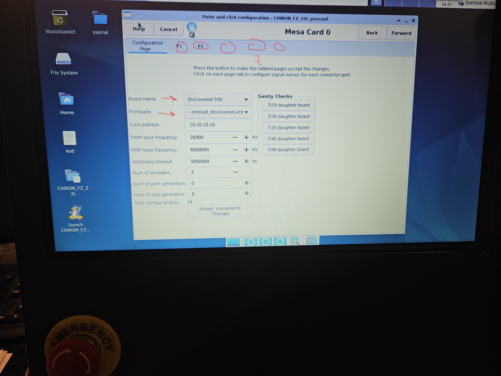

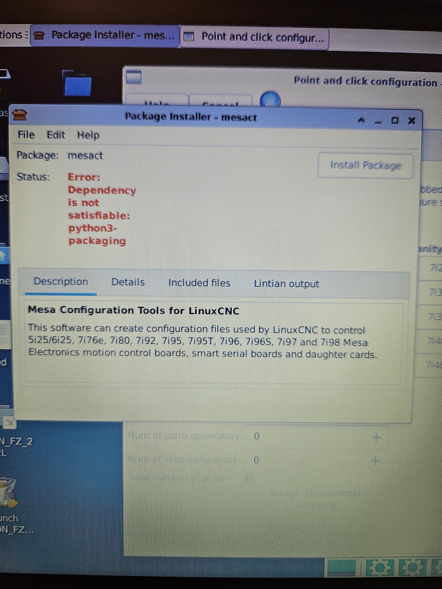

Hello everyone, I have a problem with pncconf I don't know how to configure all the cards it shows just the 7i92TH but it doesn't recognize the 7i74 and 7i77, I did the (mesaflash device 7i92T write 7i92_7i77_7i74d.bin), I tried also the mesa configuration tool with the package installer (mesact) but I get an error "Dependency is not satisfiable: python3-packaging", does anyone know what should I do or how to fix the problem. Thanks, Dominik
- Posts: 18080
- Thank you received: 5316
24 Jun 2024 03:24 #303663
Replied by PCW on topic CHIRON FZ22L LinuxCNC retrofit
I would choose 7I92+ 7I77 in pncconf
configure the 7I77 in pncconf including the encoders
and analog outputs.
Then I would add the additional I/O by editing the hal file
and analog outputs.
