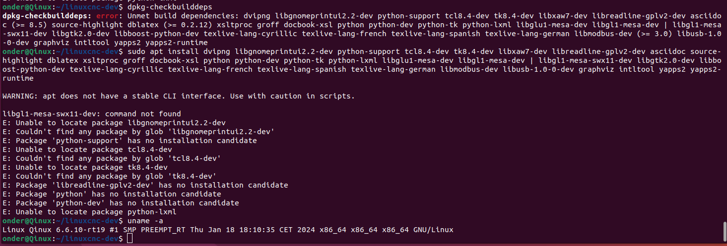

Hello,
Iam trying to download LCNC from source, on Ubuntu. Iam following this steps: www.myheap.com/cnc-stuff/linuxcnc-emc2.html .
I have finished the compilation of real time kernel (tutorial 2) I had to make some modifications, because I had some errors, but these I was able to solve with google. (I AM ABSOLUTELY BEGINNER with linux - I have a machine on linuxcnc but now I want to do even some serious tasks, with lcnc and dive into a little bit more).
Now Iam doing part 3. installing LCNC from source and I got stuck here
Basically I have to download required dependencies, which are required when I type:
The author has different (older version) requirements to I basically copied all necessary and tried to download them with:
But it gives those unable to locate errors...
I tried to solve this with:
but no success...
any ideas? I continue in searching for solution but maybe Iam doing something absolutely wrong
dpkg-checkbuilddepsThe author has different (older version) requirements to I basically copied all necessary and tried to download them with:
sudo apt install .....But it gives those unable to locate errors...
sudo add-apt-repository main
sudo add-apt-repository universe
sudo add-apt-repository restricted
sudo add-apt-repository multiversebut no success...

Replied by tommylight on topic intalling Linuxcnc from source
What version of Ubuntu?
Latest versions can have LinuxCNC installed with a single line:
sudo apt install linuxcnc-uspace
But Ubuntu will not install the RT kernel, so you can not control machines with it.
Ubuntu requires paid version for access to RT kernel.
You can use Linux Mint Debian Edition 6, it does install everything with that same line, and can control machines.

I think there is some of the newer ubuntu version. Thats strange because I was somehow able to compile PREEMPT-RT, as you can see in the screenshot, I used the command uname -a,and you can see whats there.
With sudo apt install linuxcnc-uspace I will get only latest version? What if I want also another versions? I assume this will also somehow need git.
But as I said Iam not experienced. So perhaps make new installation with Linux Mint and try again to download PREEMPT-RT and then linux?
Also I think I had some problems with preempt-rt compilation, maybe I can somehow check if its even working??
So now I will probably try this gnipsel.com/linuxcnc-old/uspace/linuxmint18-rt.html.
I read somewhere that uspace is required if I want to use mesa card, which I want to use via ethernet connection 7i96s or 7i92.
thank you

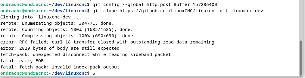

So I triend Linux Mint, got errors so I switched to Debian.
I used sudo grub-customizer to use RT kernel.
Then I created folder, where I wanted to download git clone as is written in Building LCNC. linuxcnc.org/docs/html/code/building-linuxcnc.html
But I get again some errors, which I was previously on Ubuntu solve, but now with searching (just fast tbh) Iam not able to solve this. Iam connected via ethernet to internet.

03 Feb 2024 23:52 #292343
Disconnected during download, try again and again till you get no error.
Also, i would change the network cable.
- Ondrej
- Posts: 63
04 Feb 2024 22:37 #292451
by Ondrej
Replied by Ondrej on topic intalling Linuxcnc from source
Still getting same errors. Are there any other ways how to download the same things as with this git clone command? I absolutely dont understand why it doesnt work - internet connection with cable was never problem.
- Posts: 21901
- Thank you received: 7465
04 Feb 2024 22:42 #292452
github.com/LinuxCNC/linuxcnc
Green button with "code" click on it then download zip
