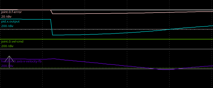

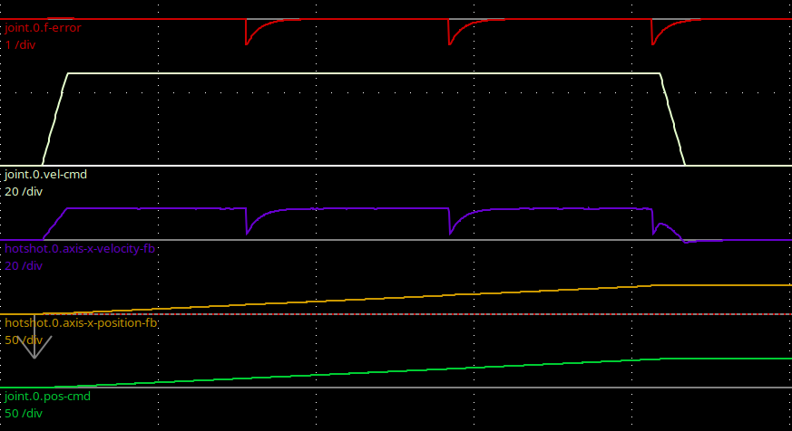

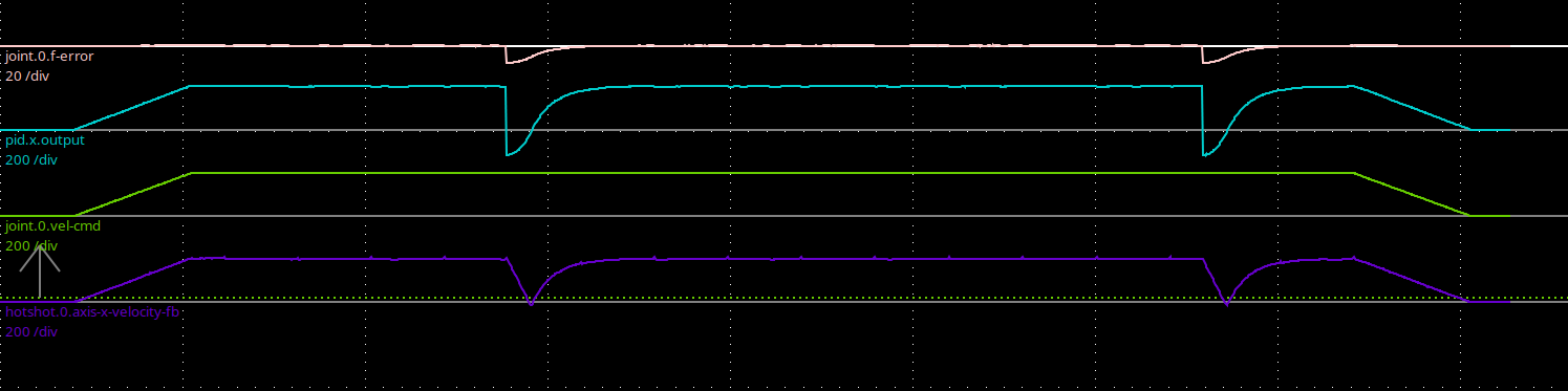

Hello all,
I'm working on finding PID settings for my XYYZ cartesian plasma cutter with only limited success. I'm hoping someone will spot my error because I can't see it.
I've (apparently) gotten close to perfection by setting P=60 and all others to 0. It runs with very little follow error, but the motor 'ticks' by slamming briefly into reverse roughly every second. Oscilloscope shots are attached.
(Sorry for the cell phone screen grabs. No screen shot tool on my minimal install of Bookworm.)
I assume this is due to it correcting accumulated error, but I haven't been able to figure out how to stop the error accumulating. Literally any change to I, D, or the FFs result in more following error.
I tried running automatic tuning, but it never finds a configuration that doesn't oscillate. Using tune-type 0 seems to work the best. With tune-type == 0, oscillations are on the order fo 0.10s of mm. With tune-type == 1, oscillations are on the order of 10s of mm. What I got for tune-type 1 is attached.
A complicating factor here is that setup is unusual. The first oddity is that my motors are just setting on the bench; there's no load on them. The second odditiy is that I'm using kinda-closed loop steppers. I'm getting position feedback from TMC5041 motion controllers but there is no physical encoder.
Here is my complete configuration in the my-plasma directory, along with the driver source code. Note that I'm only playing with the X axis right now.
github.com/alangibson/hotshot-driver-linuxcnc
Thanks in advance for any help you can give.

I've dug deeper with the oscilloscope. I found that with FFP1=1 and all other PID settings set to 0, the velocity command from LinuxCNC and the velocity reported back from the TMC5041 match pretty much perfectly.
However, the position commanded by joint.0.pos-cmd is consistently 1/5th that reported by the TMC5041. Given the velocity commanded, the TMC5041 is right and LinuxCNC is wrong. What I'm seeing on the scope is that, given a velocity of 25 mm/sec, joint.0.pos-cmd will move about 5 mm while the TMC5041 will report about 25 mm. If I simply divide the TMC5041 position feedback by 5 in the driver code then there is virtually 0 tracking error.
I have no idea why this would be so. I'm going to review the configuration again.

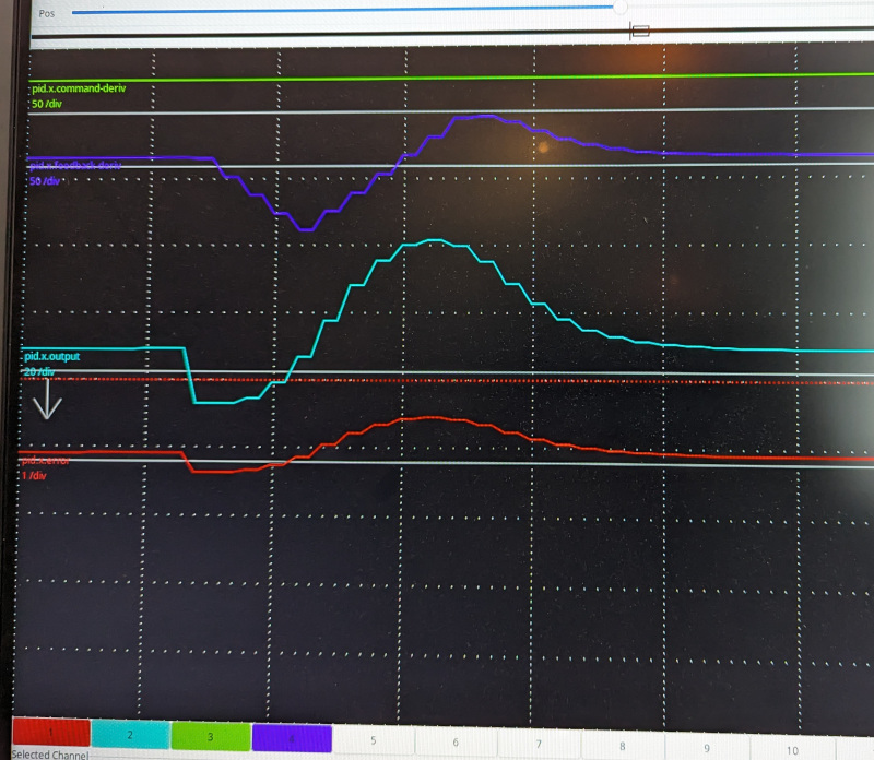

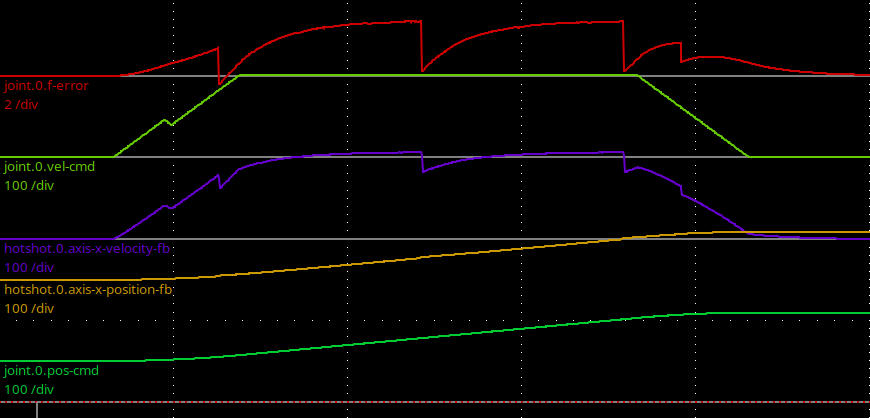

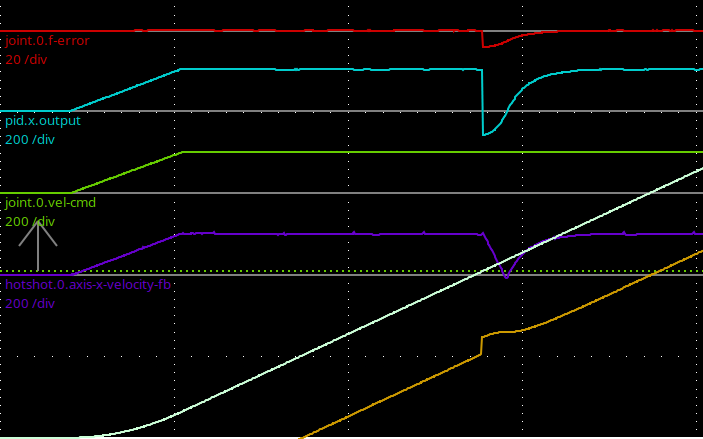

I've confirmed that the velocity numbers from LinuxCNC are correct. I hadn't noticed at first that ddt = 2.5 in halscope for the motor-position-cmd when jogging at 2.5mm/sec. I was getting around ddt = 7 from the TMC5041. I just entered 0.29 as a conversion factor in my code so I can get back to working on the PID.
With FF1 = 0.8 and P = 20 the motor no longer reverses but it does still pulse. I've attached my current best halscope screenshot. It looks like the PID only really tries to get rid of error every second or so. No clue why. Any advice on how to keep error from accumulating as shown here would be appreciated.
EDIT: Removing the conversion factor from the code and setting FF1=0.349 and P=20, I get this graph. There's very little error but the weird pulsing persists.

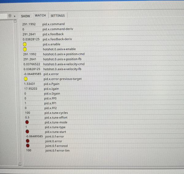

31 Jan 2024 04:39 - 31 Jan 2024 04:50 #292057
by alangibson
Replied by alangibson on topic PID Problems: Jerking while in steady run state
Apparently the TMC5041 internal clock is wildly inaccurate. There's a section in the manual that I missed that gives a formula for adjusting the velocity that needs to be applied every 100ms to keep the velocity accurate. With that done, the TMC5041 position numbers track the LinuxCNC motor-pos-cmd very well.
I'm now trying to tune the PID. I'm still seeing this occasional pulsing with FF1=1 and P=10.
Last edit: 31 Jan 2024 04:50 by alangibson.

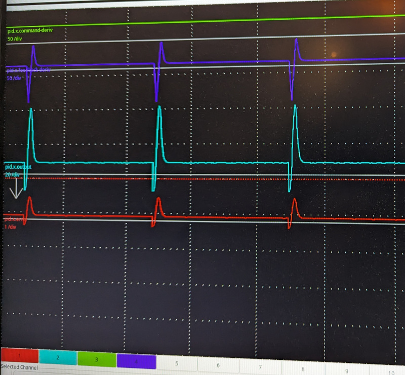

- alangibson
- Posts: 95
- Thank you received: 36
31 Jan 2024 06:44 - 31 Jan 2024 07:04 #292063
by alangibson
With FF1=1 and P=40, f-error is usually less than 0.05 when you exclude the pulses.
Zooming in you can see that it's definitely the PID commanding a dip in velocity.
Adding any I just makes the motor jitter. Does anyone have any ideas on how to proceed?
EDIT: I just learned a valuable lesson about scaling your values correctly. When I change the division on my driver's position feedback I can see that there is a weird bump that's probably causing the issue.
Last edit: 31 Jan 2024 07:04 by alangibson.
