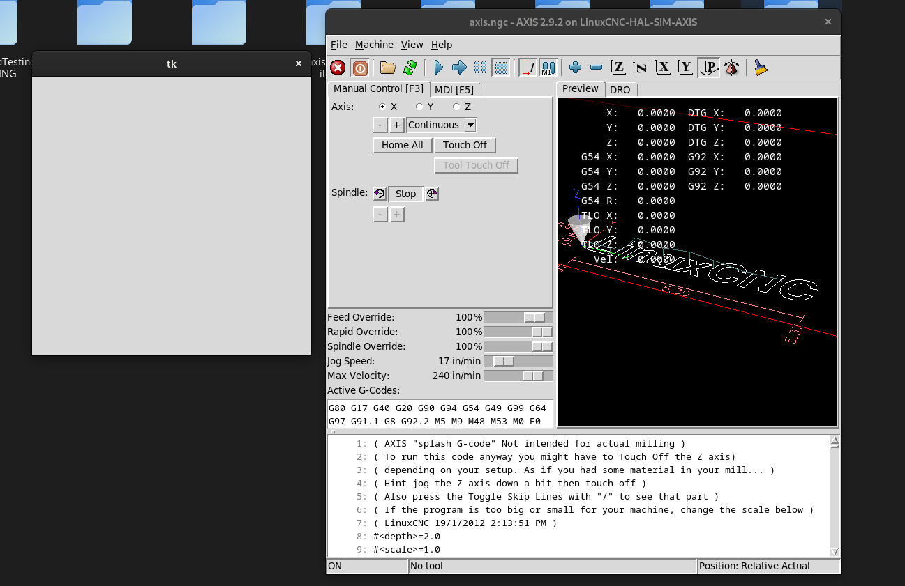

how to open vismach tk screen without the user interface, i want to see the machine model only

when i try to open the python file with the user interface it shows nothing in the tk screen, it only shows white blank tk screen with axis interface

05 Mar 2024 09:42 #295240
Replied by Aciera on topic vismach
if you open a terminal and run the command below, does it work or are you getting errors?
python3 linuxcnc/src/hal/user_comps/vismach/millturngui.py
- Abdulkareem
- Posts: 77
05 Mar 2024 09:48 #295241
by Abdulkareem
Replied by Abdulkareem on topic vismach
no iam getting this error :python3: can't open file '/home/abdulkareem/linuxcnc/src/hal/user_comps/vismach/millturngui.py': [Errno 2] No such file or directory
- Posts: 4819
- Thank you received: 2177
05 Mar 2024 10:00 #295242
Try this:
1. Open a terminal and run this command.
linuxcnc
2. on the left choose
sim/axis/vismach/millturn/millturn
3. click 'ok'
You should see three windows, one of then the vismach model with the title 'tk'
linuxcnc
3. click 'ok'

Thank you, it opened the milturn and showed the machine model in the tk screen, now i want to show my machine model
