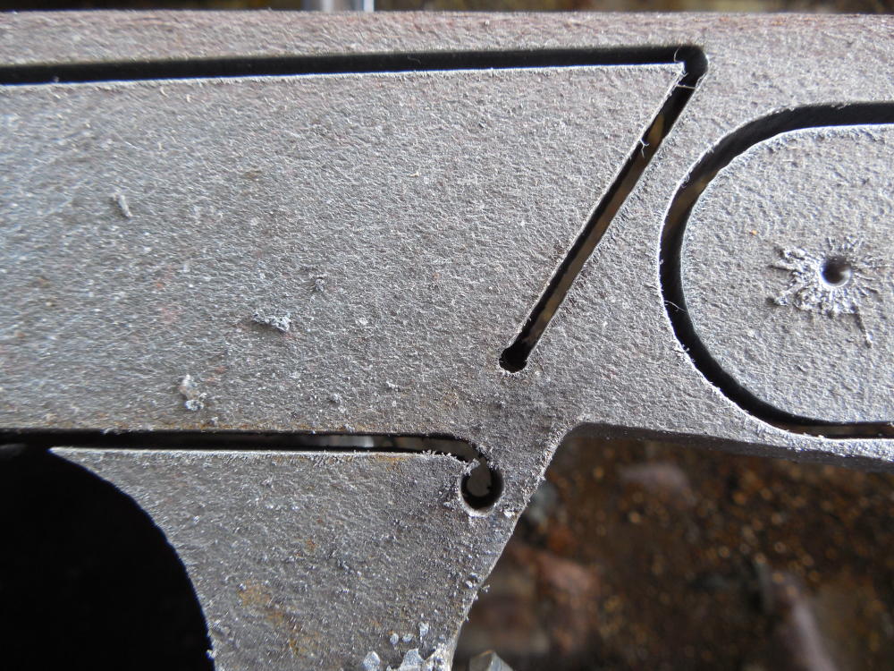

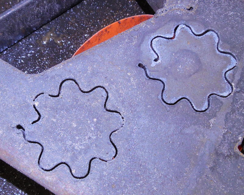

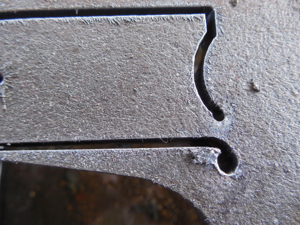

30 May 2024 21:53 - 30 May 2024 21:54 #301893
by acourtjester
THC problem was created by acourtjester

30 May 2024 22:11 - 30 May 2024 22:32 #301894
by jimmyrig
Replied by jimmyrig on topic THC problem
I assume you mean qtplasmac?
Go to parameters and increase your (can't remember exact term) void anti dive. This should help but if not try decreasing (or increasing) your p term in your pid.
My guess is it's a pid issue (or you are cutting too slow)
Takes a bit to get it tuned perfect but when it is.....it's sweet. I can cut for hours on a 8x4ft sheet and never touch the torch to the table

30 May 2024 23:43 #301899
Replied by tommylight on topic THC problem
Are those cuts supposed to end like that?
I do not think so, so :
-check the THCAD division jumper is seated properly and does not move
-try to catch the screen when that happens, does the voltage rise a lot?
-tighten the screw terminals on both sides of THCAD cable, just in case
-check the high voltage cables from plasma to THCAD
And, do you get latency warnings when running LinuxCNC?

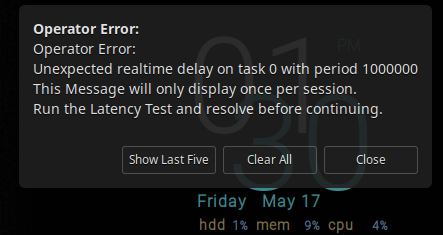

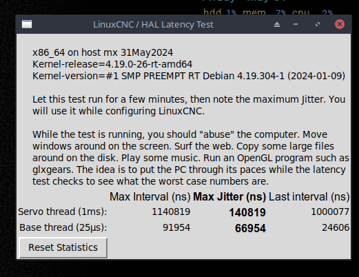

31 May 2024 19:49 - 31 May 2024 19:53 #301992
by acourtjester
Replied by acourtjester on topic THC problem
Here is what I have done, changed the speed PID from 10 to 5, PID-I form 0 to 3 and PID-D from 0 to 3. No real change it cuts some part and fails on others. Jumper on the board is on 32 and unipolar.
Tried to use a Cut Rule in SheetCam to drop the THC about 0.250" before end but QTPlasmaC did not like the G-code see attached. I do get a latency error but not when doing any operations, I get it when editing the G-code in QTPlasmaC randomly. Attached a screenshot of running the Latency check test. the voltage does not seem to bounce around that much, the Z axis seems to move maybe0.030" up and down until it crashes.

31 May 2024 20:08 #301998
Replied by PCW on topic THC problem
A dive towards the work would indicate that the voltage was read as high
It it possible that you have lost the arc and it is not signaled to LinuxCNC?
A halscope plot of the voltage, arc-ok, and velocity when you have the issue would help a lot

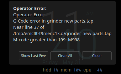

01 Jun 2024 00:24 #302022
by phillc54
This is telling you that in line 37 of the G-code (or nearby) there is a M998 command but LinuxCNC will only accept M codes up to M199.
Replied by phillc54 on topic THC problem
The following user(s) said Thank You: acourtjester
