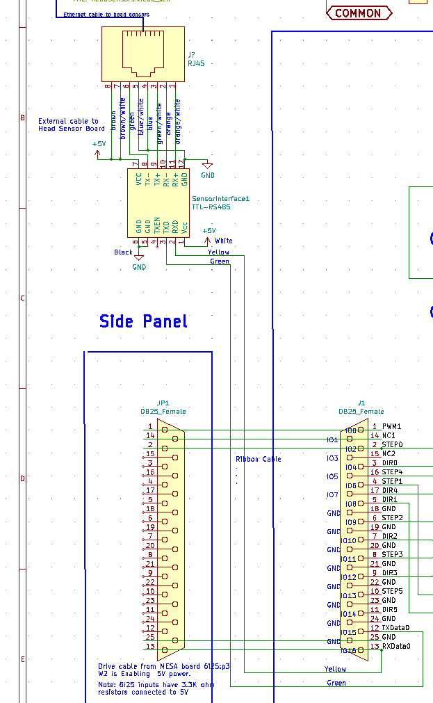

I'm stumped. I have a mesa 6i25 pci card with firmware configured for five stepgens and one SSerial channel. I am trying to connect a mesa 7i87 ADC card on the serial port but I get no indication that the 7i87 card is detected.
I have checked the wiring several times. The board is getting power. When I start linuxcnc and bring up 'hal configuration' I expected to see some reference to the 7i87 - but nothing there. Is there some way to debug this systematically?

What daughtercard do you use?
Maybe an interface/pinout/polarity issue

You need a RS-422 interface with the correct pinout and polarity
between the 5I25 and 7I87. That's why I asked about the
daughtercard you are using.

Ok, I should have been more detailed. The connections are:
hm2_5i25 < sslbp > < TTL-RS485 > 7i87
I'm using the TTL to RS485 translator the MESA told me to use. It and the 7i87 card have power but I don't know if the signal is getting through.

My guess is that its a wiring error of some kind
can you show the connections between the 5I25 RX and TX
signals, the RS485.422 transceiver, and the RJ-45 pins?

Unfortunately your schematic did not get attached properly.

Sorry, about the bad attachment. I'll try again but I think I found a problem with the differential pairs having the polarity reversed. I can't test it now but will swap the wires as soon as I get time.
