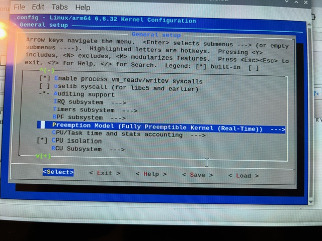

First of all I'd like to apologize I thought I could get this running without any issues but I'm at a stand still so I thank you in advance for any advice you can give me.I am converting a benchtop mill to a CNC and I have all the hardware side of things finished on it. Motor mounts and screws are installed, motors are mounted, motors are connected to stepper drivers stepper drivers are connected to 7c81 Mesa BOB (hopefully correctly but I can't test it because I can't get the RT kernel to work). I have installed and compiled the RT kernel maybe 5 times and I think I'm doing one step wrong because it won't actually initialize the kernel.
Components:
-Raspberry Pi 4B 8GB RAM-Debian 12 "bookworm" 64 bit OS
-I have installed the RT kernel from kernel.org linux-6.6.32
-patch from wiki.linuxfoundation.org patch-6.6.32.rt32.patch

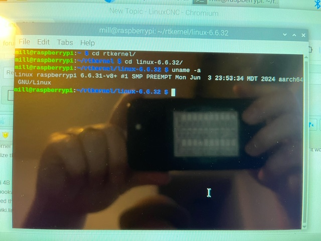

As you can see in the pictures when I call uname -a it says that it is running 6.6.31-v8 PREEMPT kernel but when I call make config to choose the RT Kernel it says it is already chosen but if you look at the top of the config menu it states that it is using the arm 6.6.32 Kernel. So my guess is its actually using a different kernel than the one I "made" after altering the menuconfig command. I don't know what is the issue. Any help would be greatly appreciated.

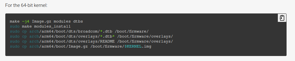

It sounds like you just didn't copy the newly compiled kernel to wherever it needs to go to boot. Also, you need to reboot to boot into the new kernel.
www.raspberrypi.com/documentation/computers/linux_kernel.html

So where would I need to copy it to? I created my own directory I called rtkernel that the kernel that I compiled and did the menuconfigs on.
I used the documentation that you linked to figure out how to add the patch and compile the kernel but it was not working so I followed another "tutorial" on YouTube.
How would I copy it to boot? I did reboot the pi to boot into the new kernel but do I need to boot into it any specific way other than just rebooting or shutting down, unplugging and booting it?
